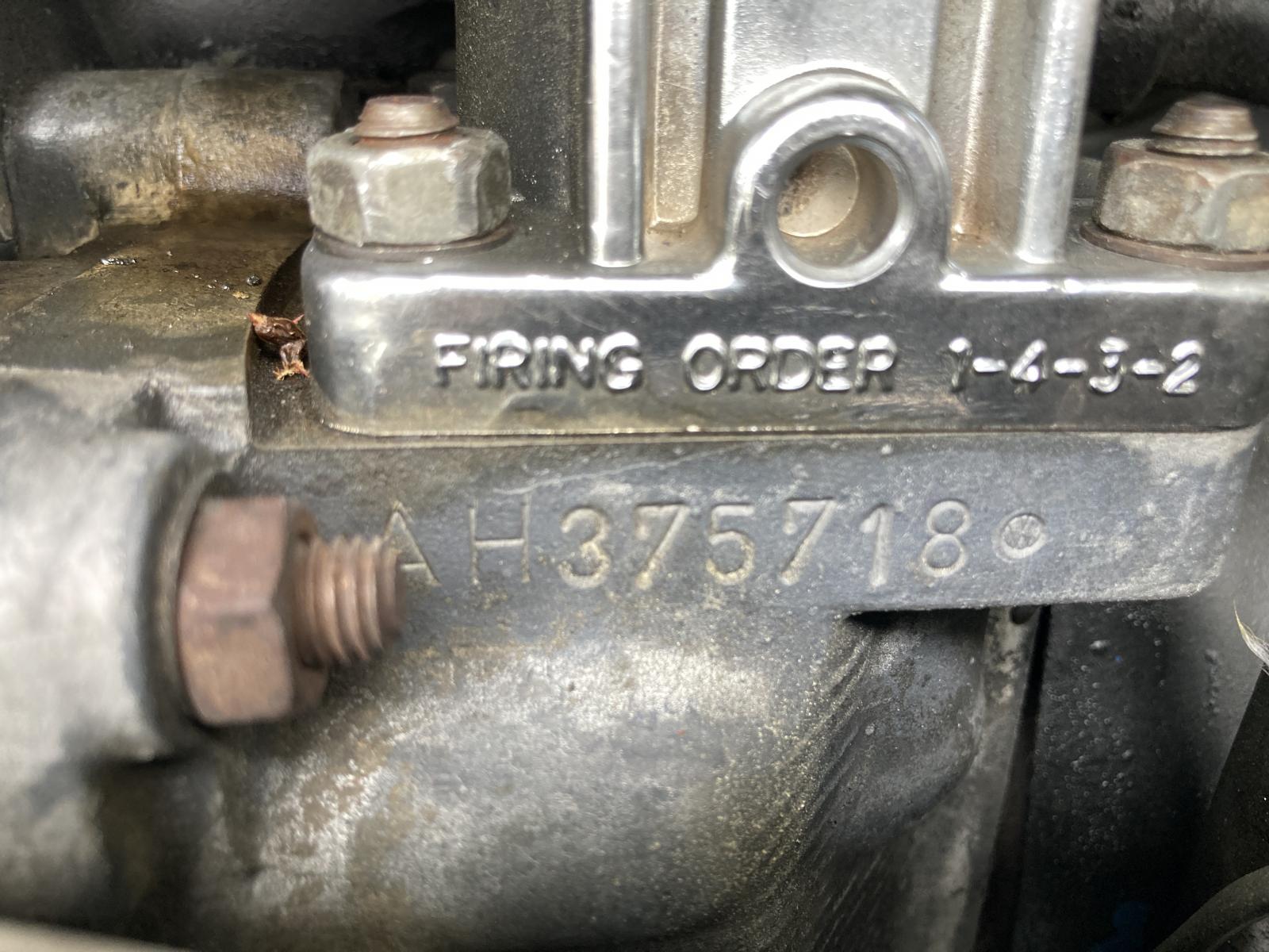

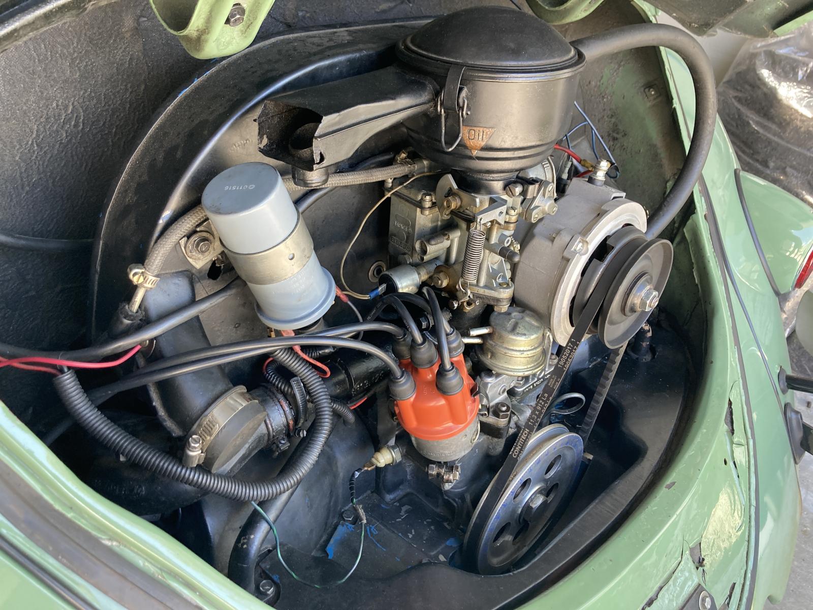

Additional details about my carb and motor. Thanks for the feedback.
I will check out SparxWorx.

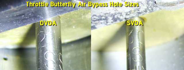

You have an aftermarket (Bocar) 34Pict-3. That model was designed to work with an SVDA distributor similar to the one in your link. You should be okay. Connect the vacuum canister on the distributor to the left side vacuum advance port on the carb.
Since you are posting into the 67-earlier forum I was worried you had a 30Pict carb (or earlier) which generally were meant to work with SVA distributors (large diameter vacuum canisters that work off of much lower vacuum signals).
Mixing and matching carb/distributors never works well. You want to pick a distributor that works with your carb... or pick a carb that works with your distributor. Your pairing should work fine... presuming all the components are working as intended.
Once you get the distributor installed, confirm the max mechanical advance does not take you into detonation. Start by adjusting your points (0.016" gap or 47deg dwell +/-3deg). With the vacuum hose disconnected and plugged, rev the engine up until the timing marks under a strobe timing light stop advancing (stop moving CCW). Confirm the mechanical advance hasn't taken you above around 28~32BTDC total (safe upper limit). This is a measure of the mechanical advance only; which is why you disconnect the vacuum hose for this test. If the distributor is over advancing, loosen the hold down clamp and rotate the distributor body until the max timing is in the 28~32BTDC range. You should start on the lower end of that range and work your way up. Some engines may start to experience detonation under load even at 32BTDC.
Once you have the max timing set, let the rpms drop to idle and note the idle timing. You can use this idle timing for future tune ups with that distributor.
One last note: before you remove the old distributor to add the new one... manually rotate the crank pulley until the rotor is pointing to the #1 plug wire post on the distributor cap and the TDC/timing marks line up with the case split. Your engine (cam+crank) is now ready to spark the #1 spark plug.
When you finish installing the new distributor you will need to place the #1 plug wire into the cap post over the rotor so the new distributor is delivering a spark to the #1 spark plug. If necessary, rotate the body of the distributor until the #1 notch lines up with the tip of the rotor before you install the plug wires into the cap. You can use the notch as a reference for where #1 plug wire goes in future tune-ups.
