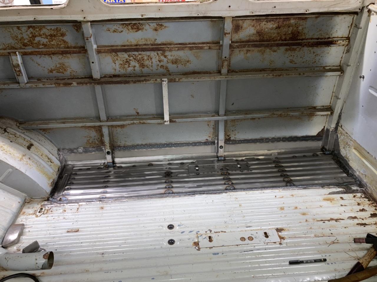

Help - I am trying to find a photo of an original 67 Deluxe cargo floor. My old one was completely shot and gone and I need to understand:
The direction for each of the 4 seat mounting plates
Where are each of the seat mount brackets (the small weird shaped ones) go and direction for these small mounts. I have been told that the 67 needs 6 of these which does not seem right but happy to be set straight.

A '67 cargo floor I used to own
A bunch of places I have posted it in the Forum in the past which may have more info:
https://www.thesamba.com/vw/forum/search.php?search_id=gallerypic&search_keywords=270114

Thanks for the reply, much appreciated that was a huge help.
Now just wondering if you know how many of the seat tags (the one in the photo I scrapped from another forum) are on the '67 Deluxe floor for the rear bench seat. Is it only 2, 4 or more? and what is the orientation i.e circle pointing to centre of floor or pointing to the side panels ?

67 should be the same my late '63 Bus with 2 mounts but hopefully someone will verify this fact

PostPosted: Wed Oct 04, 2023 11:05 pm    Post subject: Re: 67 Cargo Floor Reply with quote
here on my 67:
