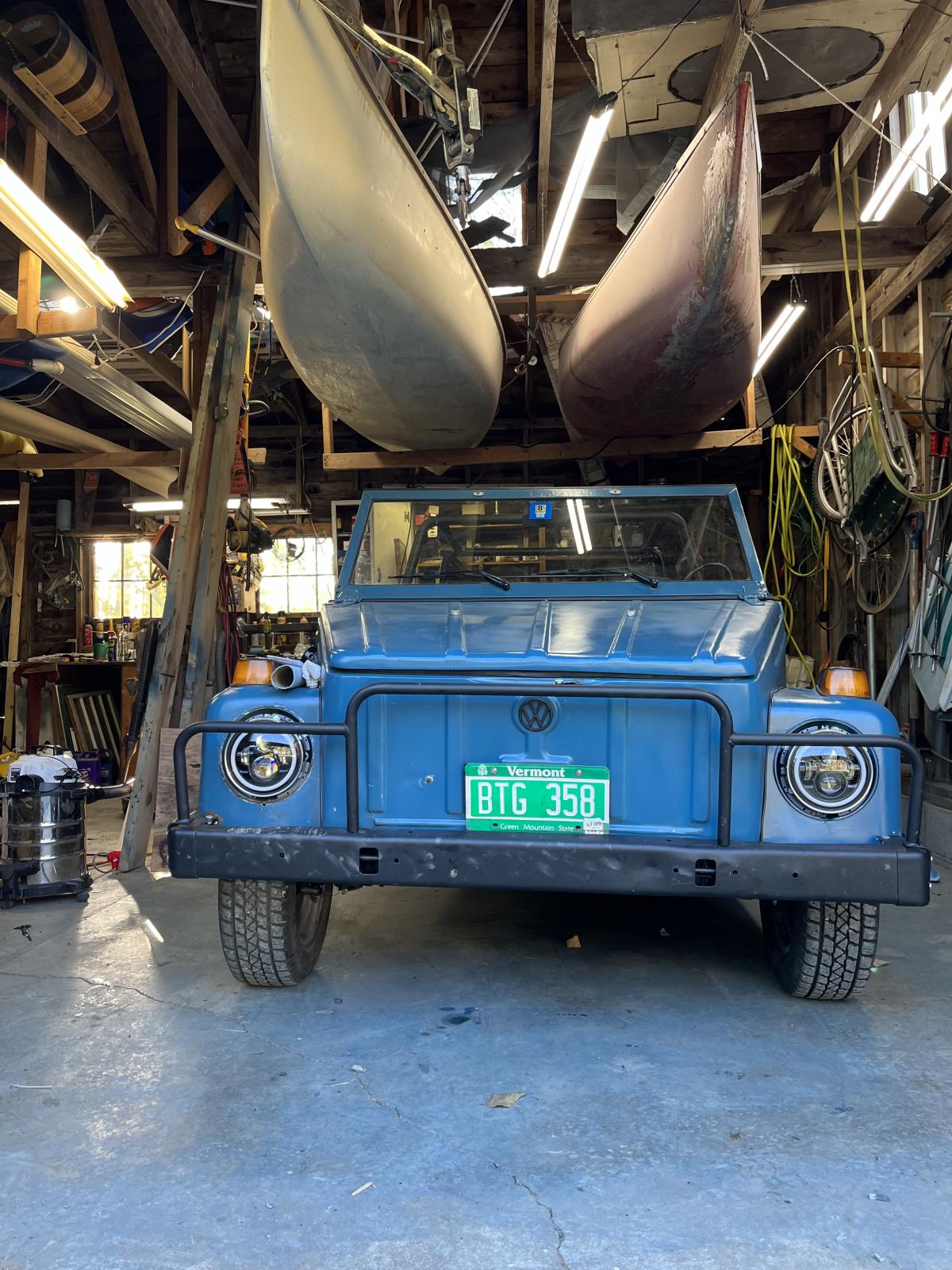

Just redid my Thing during the past year, new everything, front beam tie rods steering brakes rockers pans....
Ball joints done by a VW specialist who owns multiple Things...
Having an alignment tomorrow I think. My front left sags 1 inch
Could it be the sway bar? I reused it but it looked straight. Is it worth removal to see?
I will post pics Not sure if I should fix this before going to the alignment shop. Full disclosure I have slight toe in and steering wheel is off center many degrees but I think those items dont matter for the sag.
Rear does not sag new torsion bars intalled to the tooth spline!

I had a similar issue after I rebuilt my dad's thing, issue was I didn't index the rear springs correctly. The issue was the left front was high so it was the right rear that was low.
Might want to double check your rear indexing.
Also looking at the vehicle from the front the passenger side looks high and drivers looks correct. Which would fit if the rear were actually the problem.

I have a Thing that I plan on restoring and it has the exact same lean. I lay on the floor in front of it and I swear it looks like something is twisted or fenders are bent. Its like an optical illusion trying to figure it out.
Love to know the answer id you figure it out
