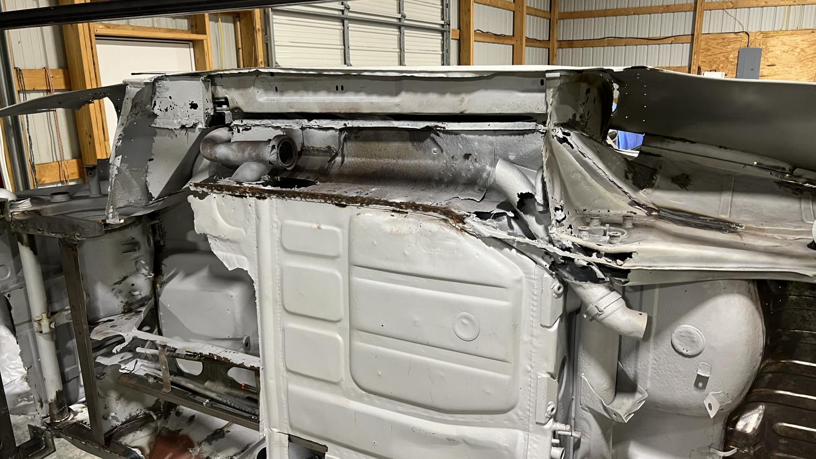

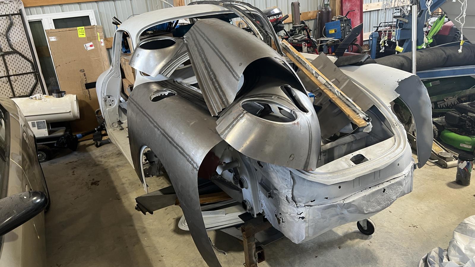

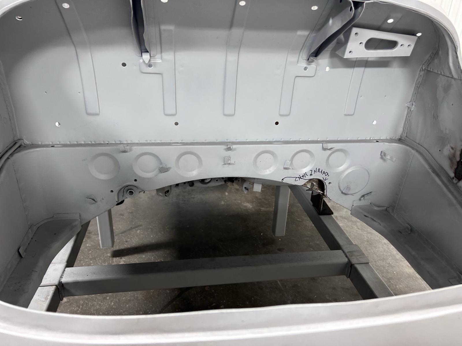

Car piled up with parts
Close up of the battery box... It badly needs to be replaced. Thankfully all the sheet metal for the repair is in the pile of parts.

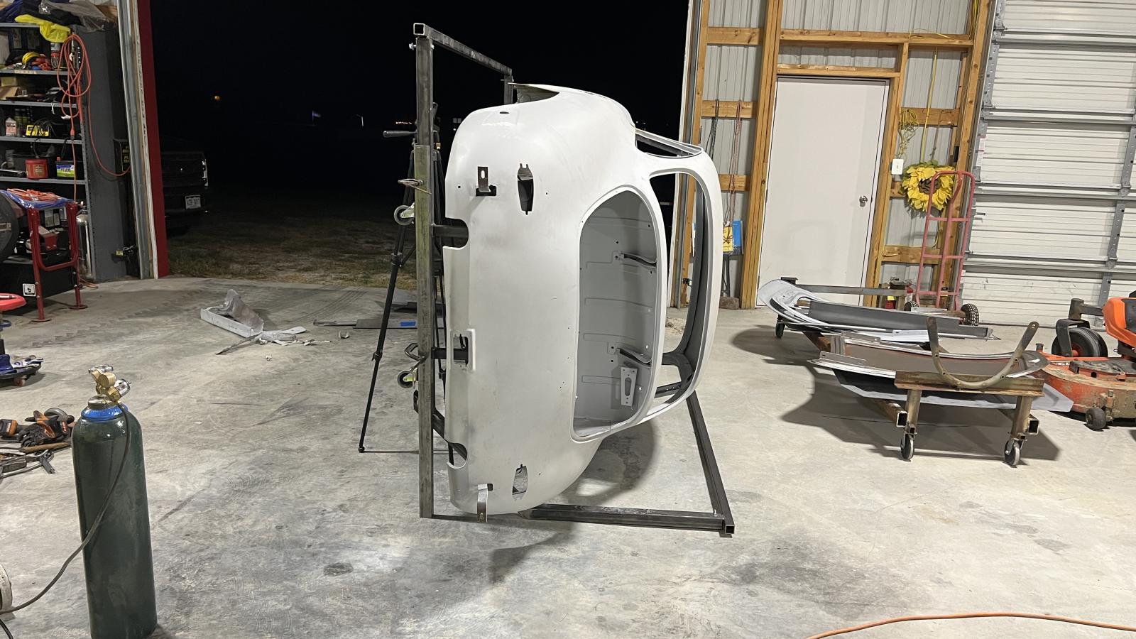

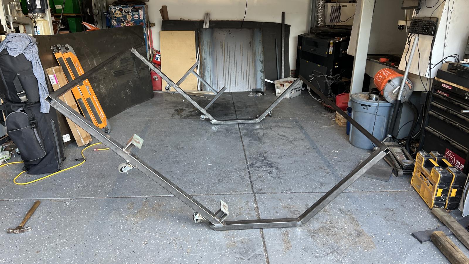

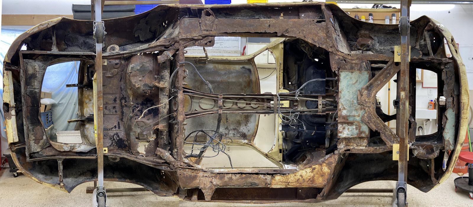

Pics of the rotator I built. I was planning to use the rotisserie I built for my Ghia, but I lent it to someone and he never returned it (surprise). When I asked for it back he claimed it got stolen... No apology, no offer to pay for the material... Not what I expected from a VW person, but that's water under the bridge now.

Car on the Rotator and ready for metal replacement to begin

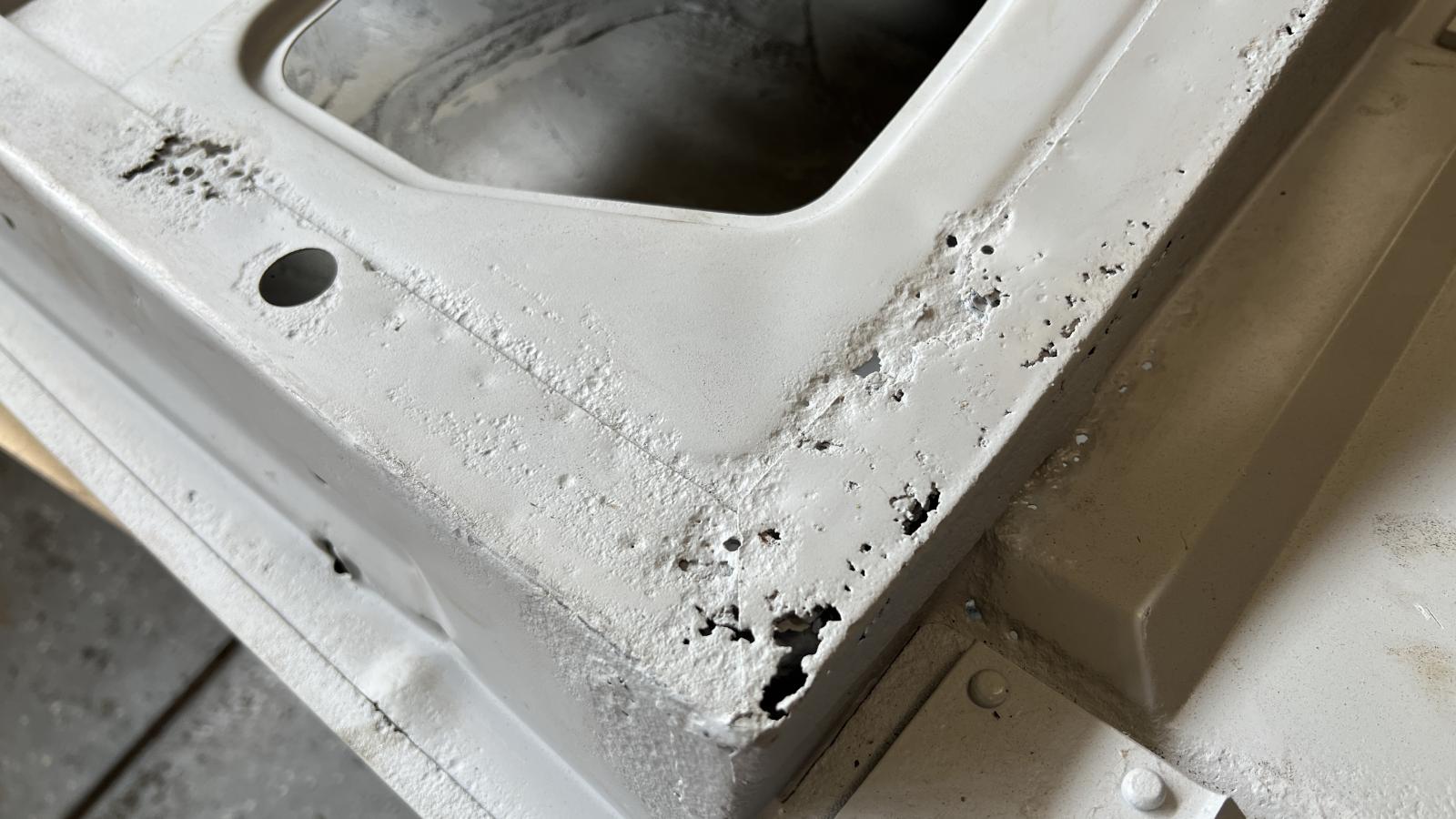

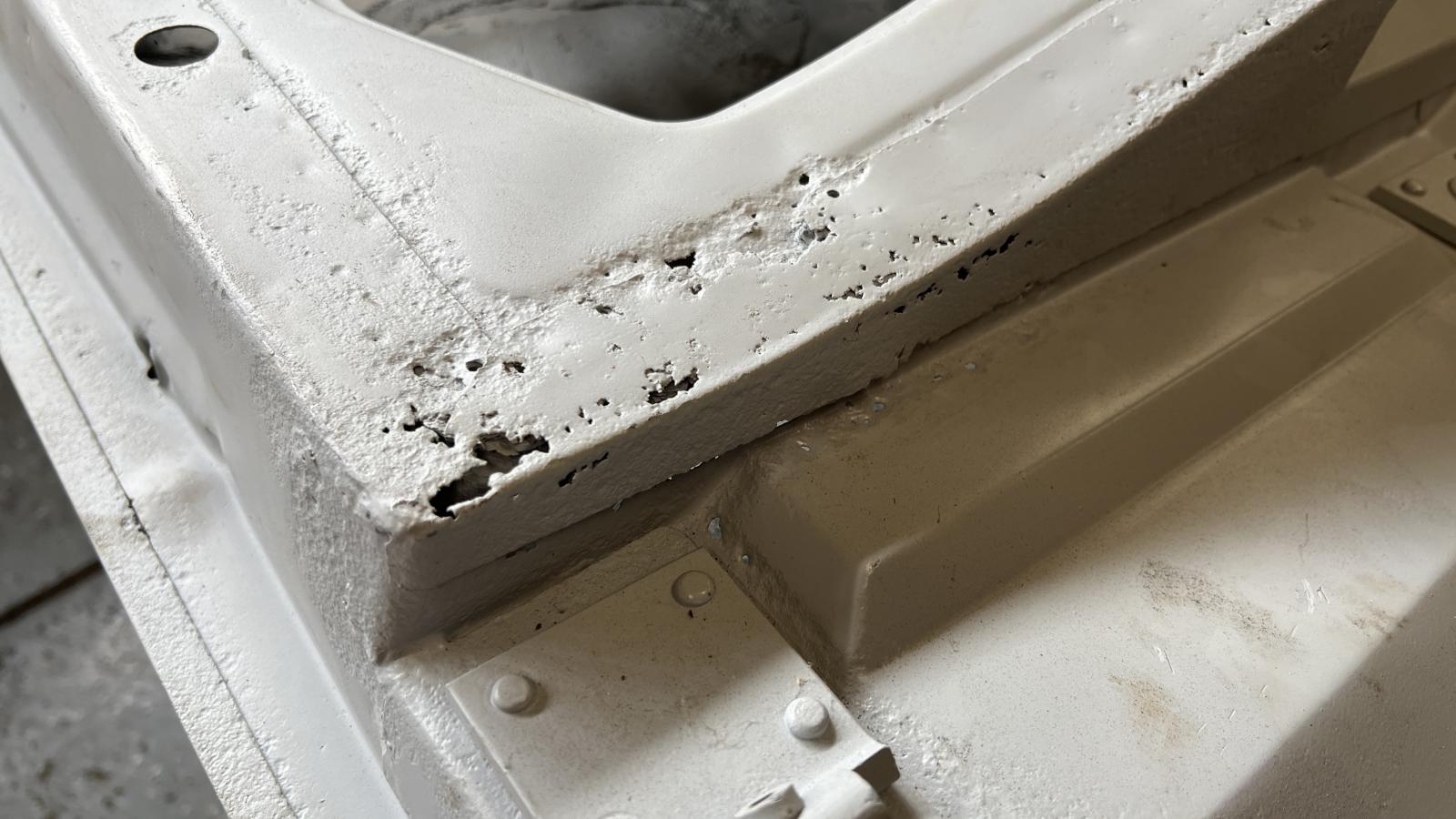

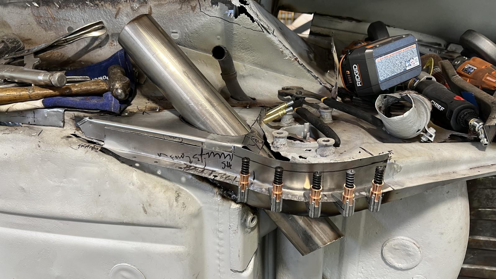

A couple close up "before" pics after I cut out the worst of the rot.
Longitudinal area
Rear Closing Panel
Bottom of the B-Pillar

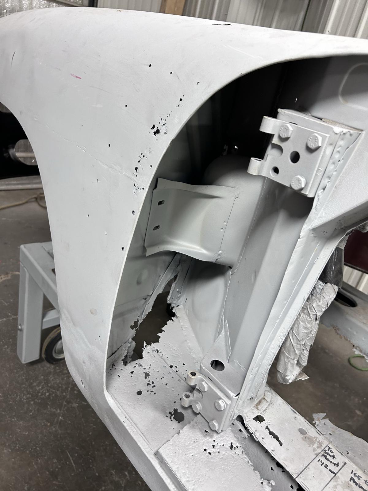

Work on the doors.

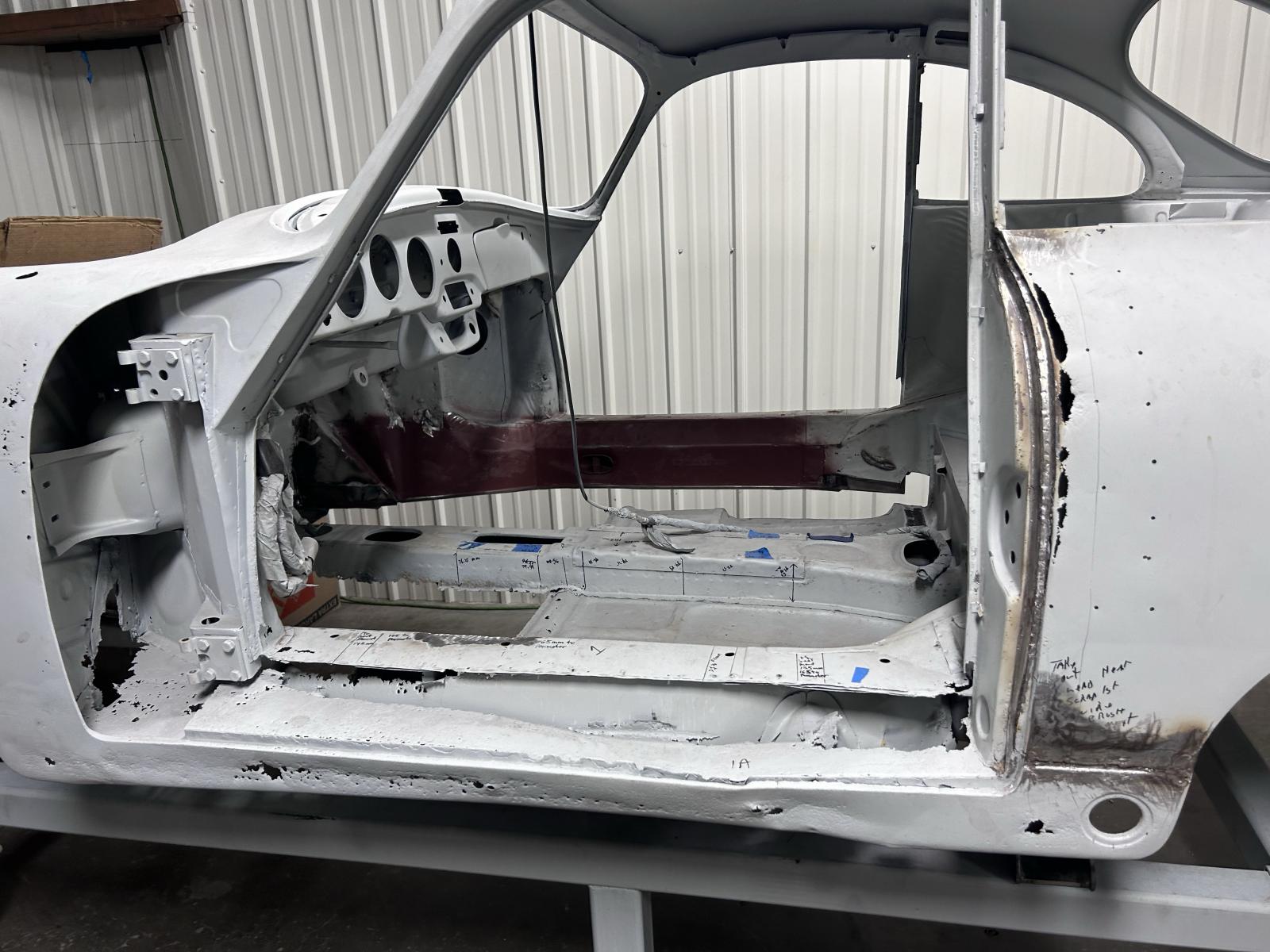

PostPosted: Mon Nov 06, 2023 9:43 am    Post subject: Re: 1964 356C Restoration Reply with quote

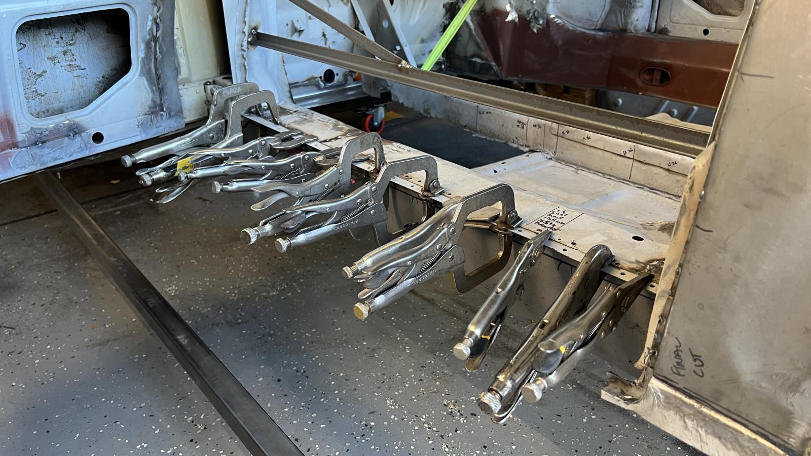

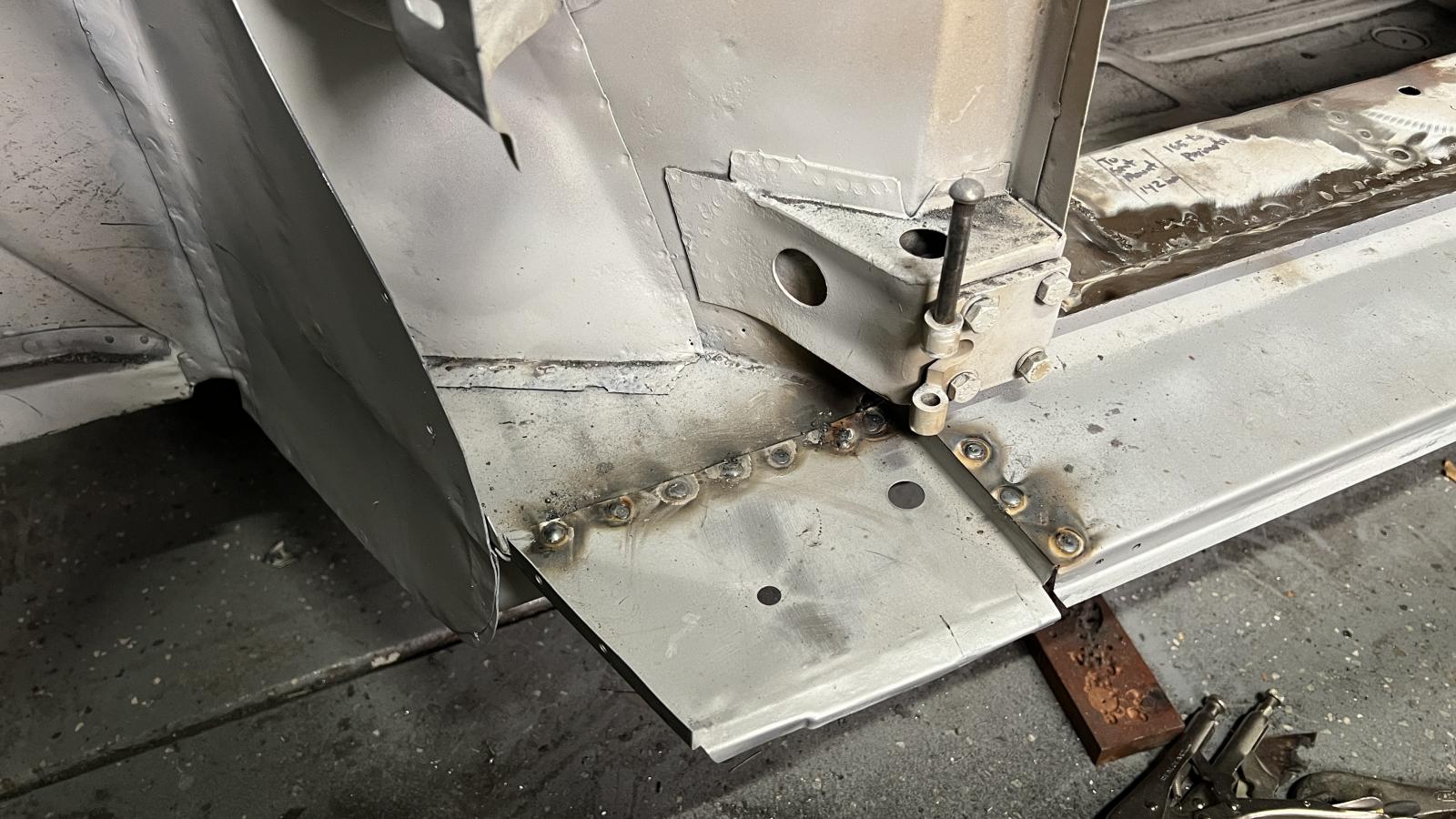

Longitudinal Clamped and fit up
Longitudinal closed up
Rear of Longitudinal
Front closing panel getting welded in
B-Pillar getting ready for repair
B-Pillar welded in

PostPosted: Thu Nov 09, 2023 9:57 pm    Post subject: Re: 1964 356C Restoration Reply with quote

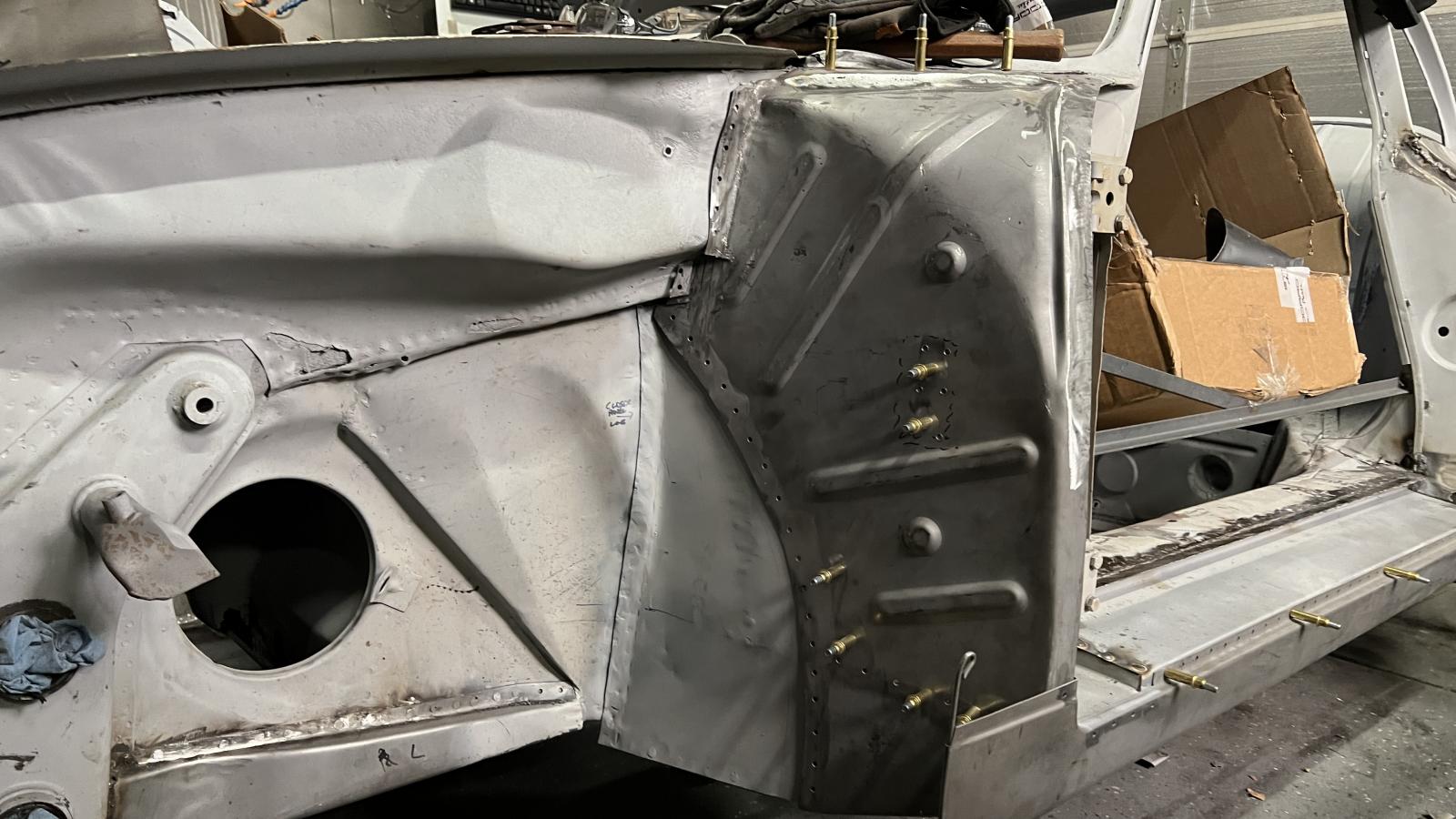

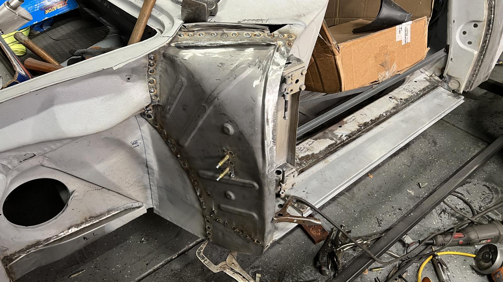

Short Sill Cleco'd in place
Short Sill Welded in
Front Closing Panel Cleco'd in place
Front Closing Panel Welded in

I'm pretty much wrapped up with the structural repairs on the driver's side. I am going to hang the Outer Rocker Skin next, then I'll start in on the passenger side. The PO started repairs on that side already, so I'll have a running start.
Jack Points welded in
Rear Closing panel installed. I still need to fab and weld the wheel well extension to cover the top edge of this panel.
