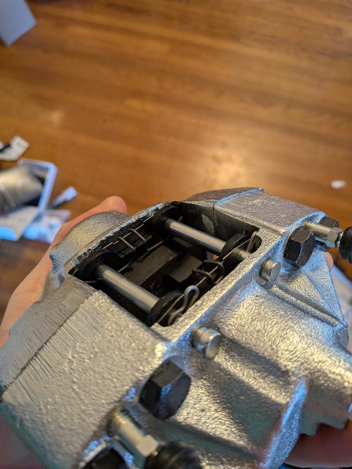

PostPosted: Mon Dec 08, 2025 5:26 pm    Post subject: Re: Front caliper leaking fluid Reply with quote
Jon at topline sent me a new caliper no issue. They have amazing customer service.
Arrived today and the quality of these varga calipers seems honestly not great. It noticeably does not line up. Im going to run it for now, but I have concerns for sure. Will email Jon and report back. It may just be cosmetic.
Maybe the chinese calipers are better after all, they certainly are cheaper. FWIW these vargas are sourced via EMPI. Big EMPI sticker on the box.

PostPosted: Mon Dec 08, 2025 5:48 pm    Post subject: Re: Front caliper leaking fluid Reply with quote
If you’re worried about the fact that the caliper halves do not line up exactly I wouldn’t.
Here’s a photo of the original VW ATE that I gave in my 68 Euro Beetle. You can see that it doesn’t line up perfectly side to side. When the new manufacturer copied the original design they probably copied the “error” exactly.

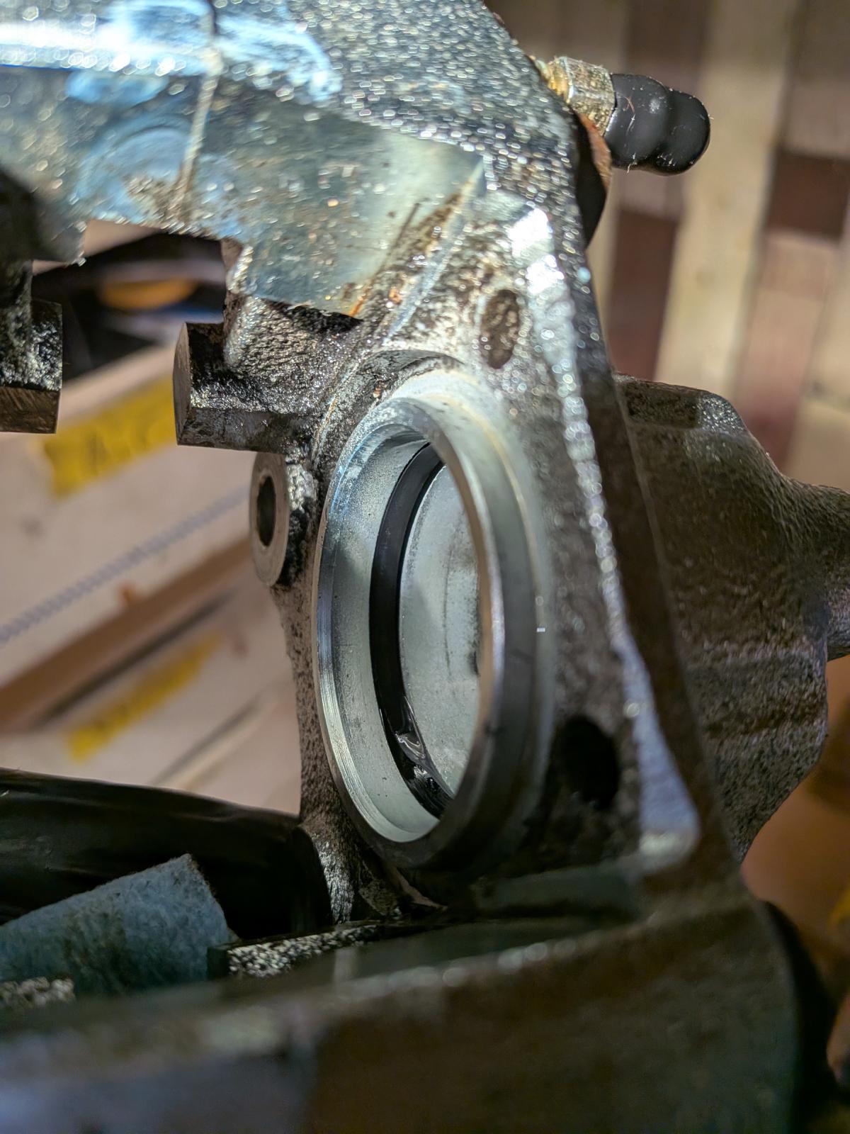

PostPosted: Mon Dec 08, 2025 8:41 pm    Post subject: Re: Front caliper leaking fluid Reply with quote
Root cause of the issues in the original caliper is found. The caliper seal was twisted. Likely was twisted during installation of the piston at the factory.
I simply popped out the pistons to find this.
