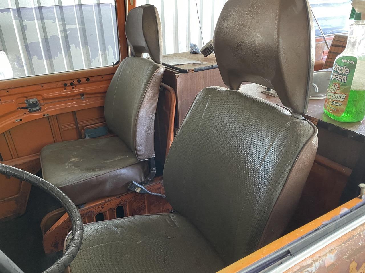

Once back to my rented shop space in town, the first order of business was to exorcise as much of the previous tenants' refuse as possible. I made a stop at the dumpster first thing, and got all of the big stuff (boxes of crap, chunks of aluminum siding, strings of Christmas lights, etc.) I could get out of the way first. There was no way I was going in any deeper without the requisite PPE, so I suited up and got to work beating on my ShopVac like it owed me money.
It took a couple of afternoons to make a decent first pass, and get things to the point where it started to look like a viable candidate for revival again. There were turds, nests, and piles of trash pretty much EVERYWHERE. I think the final tally was 4 33-gallon contractor bags worth.
While I know that I'll ultimately be pulling the interior in its entirety to get everything properly replaced, sanitized, and/or disposed of, it's looking (and smelling) much better as of this week.

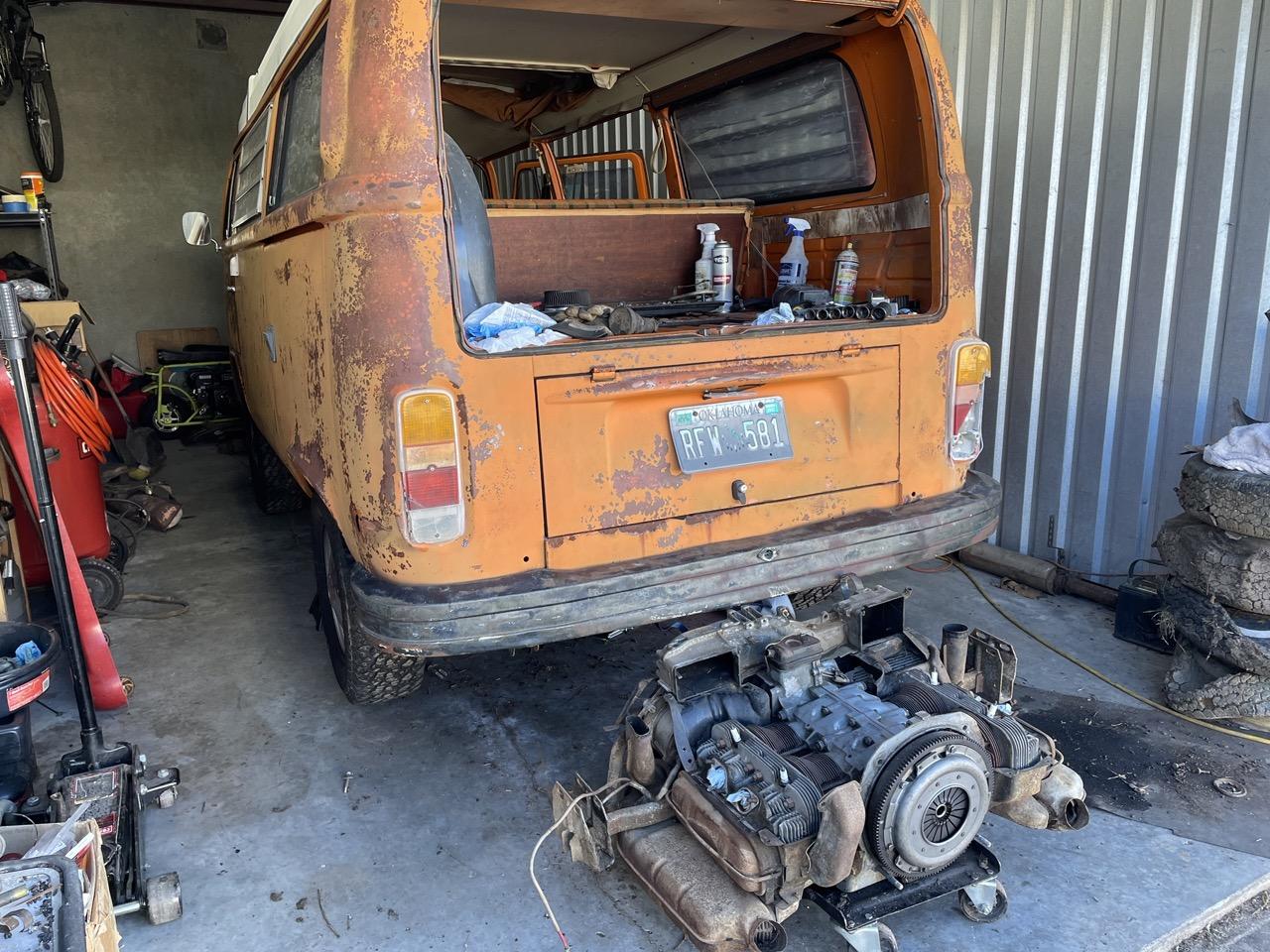

Okay, so onto the mechanical side of the rescue.
When I first inquired about the bus on Marketplace, one of the first things the seller mentioned was that the engine wasn't stuck. Given that I was concentrating primarily on getting the bus extricated from where it had sunken into the ground, I never even bothered to verify the seller's claim on the day I picked it up. Thankfully, he was being truthful.
Once I got the majority of the hantavirus threat abated, I started going through cabinets, drawers, etc. to see what I might find. In the glovebox, I found a rodent-chewed receipt for a clutch replacement for a no-longer-in-business local shop dated March 2002. Checking the receipt mileage against the current odometer reading, only about 200 miles had been put on the bus after the work was done. I also used the information on the receipt to google the original owner's name, and found that he passed at age 83 in early 2003.
Given that the bus was likely shelved due to the original owner's age/illness, my assumption is that it was indeed "running when parked." Armed with that bit of optimism, I set about diving into the engine bay.
Obviously, there was a goodly amount of rodent caca, nesting material, and chewed wiring to contend with. My initial goal (hope?) was to clean out the engine bay and try firing the ol' girl up, but that soon proved to be a pipe dream.
First things first: as I made time to fully assess the situation, it became clear that not only had the FI been replaced with the dread Weber progressive, but the engine itself appears to have originally been a dual-carb version from a '74. The numbers on the shroud tell me it's an 1800, anyway, but given that the case has been painted at some point it's likely a rebuild and who knows what it actually is.
As I worked my way more deeply into the engine compartment, it quickly became evident that there were nests and god knows what else packed into every nook and cranny, particularly under the cooling tins and behind the firewall...
And so, realizing that between the chewed-up wiring and the stuff I'd already removed I was already most of the way there, I set about pulling the engine to make a full appraisal. Ended up taking me about 20 minutes.
In doing so, I was also able to verify that indeed has a nice new (20+ year old!) clutch assembly. Having pulled the valve covers and the breather box, I can also confirm that everything looks at least nominally clean and shipshape. So. Now my current plan is to complete a detailed and thorough cleanup of the engine, reinstall it, and see how it runs. I'm going to make some improvements beforehand, like reinstalling the missing cooling flaps, replacing the front and rear seals, etc., but am otherwise going to leave it alone internally. And if it turns out to be a turd, I have a known-good 2.0 waiting in the wings.
Onward and upward!
