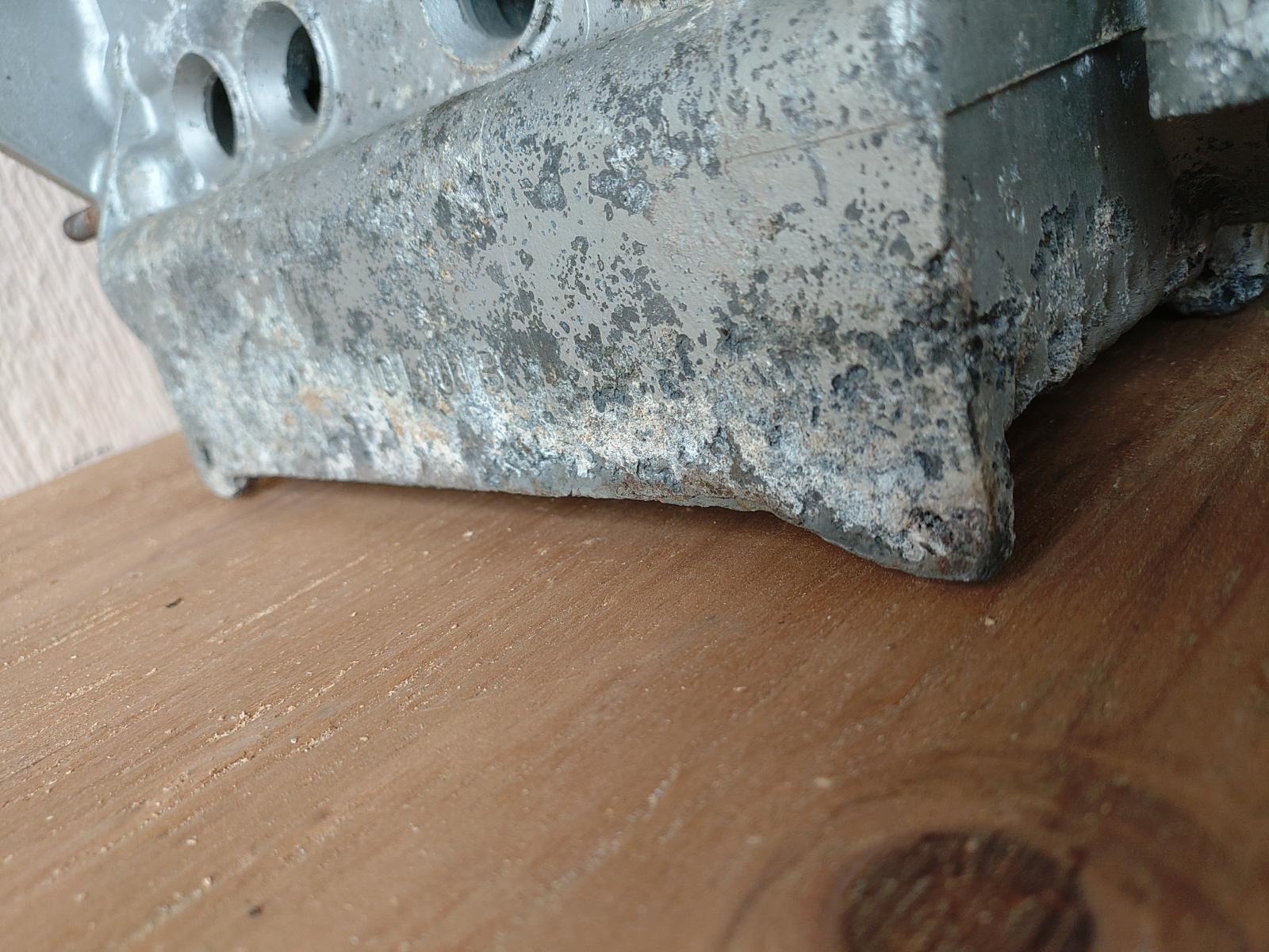

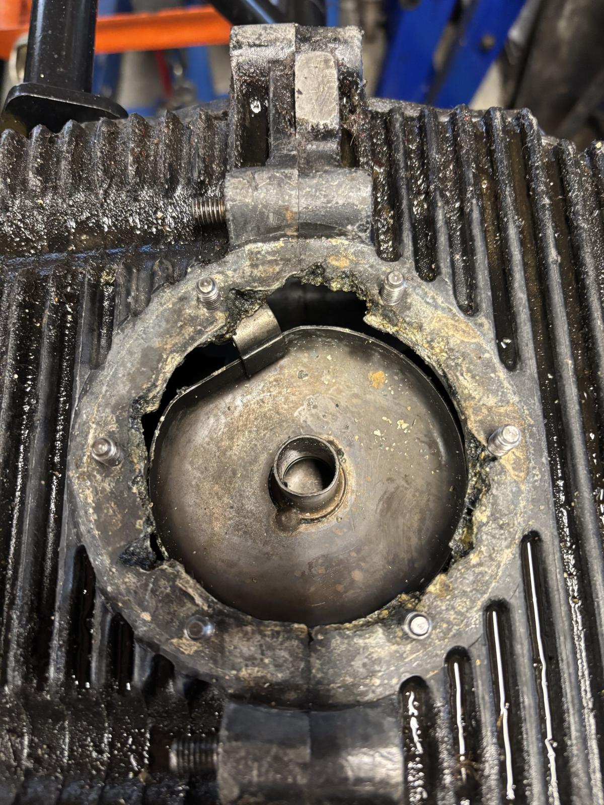

I see this problem rear it's ugly head over and over on this site. It's always about "how do I fix this", how about a discussion on prevention? If we treat an engine right this should never happen.
I stole this photo from Moyock13's post. My apologies to you Sir!
In my view it is caused by running an engine too cold and not changing oil often enough. So easy to prevent this!

Caused by water, either sitting on a wet floor or water inside by not letting the engine get hot enough to boil it off. Fewer very short drives and installing shroud flaps and thermostat will help.

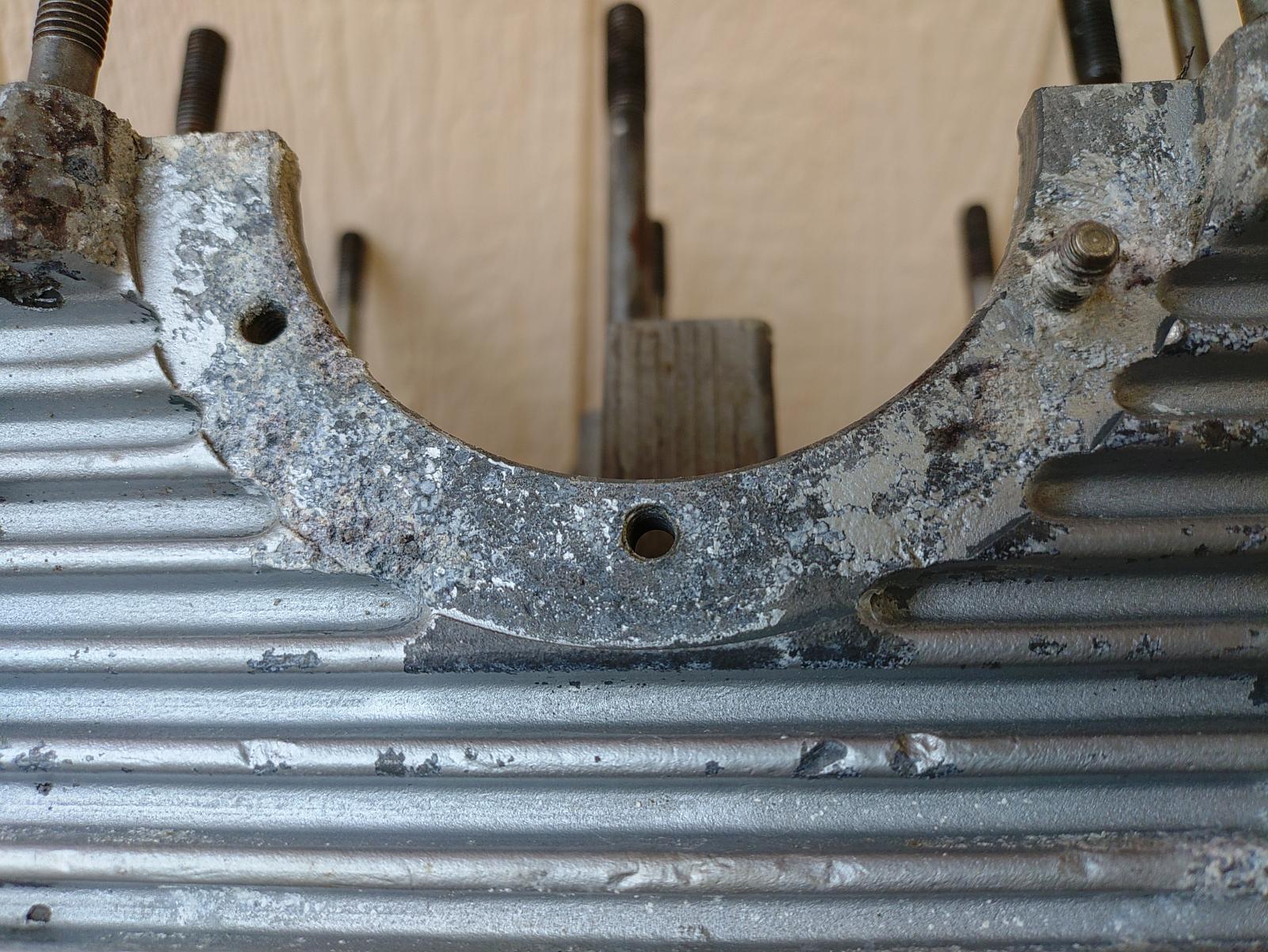

Yes, water being denser than oil and the fact that the two do not mix allows the water to gravitate below the oil causing the bottom of the case to rot if left unchecked.
Then there is the issue of electrolysis, whereas dissimilar metals in contact with water can create rot in the weaker material, this is the theory behind the anode rod that you find in water heaters, essentially the anode is sacrificial so as not to rot the steel tank.
Anode rods can be purchased in aluminum and magnesium
This case sat on the floor boards of a Baja that took on water due to leaks, the rot is evident.

No these engines are rotting from the inside. It's strictly a care and feeding problem. It happens during use. It's water in the oil combining with Sulphur in the fuel to produce Sulphuric acid, water combining with nitrogen to produce nitric acid. Once Sulphuric acid is present it is too late to boil it off. Boiling point is 638.6*F. The only recourse at that point is to dump the oil and replace it. Nitric acid boils at 181.9*F and will boil off with the water.
I have seen engines that have sat out in the weather and that is not what does this either. They have rotted out heads and seized pistons and cylinders from open valves and water going down the intake and into the exhaust ports.

Yes, water alone will eventually cause SOME heavy corrosion....but that is not what what this is.
And, as U&I mentioned, you have what is essentially an "accelerant" which is the galvanic action between the steel studs and magnesium.
Galvanic action requires an electrolyte. The water with the dilute sulfuric acid created by the sulfur in the oil breaking down added with any metallic salts present in the oil...IS....the electrolyte.
The most common metallic salts in motor oil are magnesium and calcium.
If the oil left sitting in the engine case for a long time on the shelf or in the car is also dirty....it has lots of carbon and sulfur and some moisture. Over time with ambient temp rising and falling ...will put a lot more condensation into the oil.
Thinking about this, one had to store magnesium cases for extended periods, say....out in the shed or an unheated garage....I would take the oil out, clean them well and either paint them with something (even cheap paint will really slow this down), or paint them with ATF and bag them up nearly airtight....or even that WD-40 long term protectant spray which is like cosmoline.....should work.

The case that I pictured was a fresh uninstalled engine sitting on the floor boards of a Baja without oil and the strainer and cover plate had not been installed, the corrosion was not limited to the bottom either, the case was painted and that did help in the areas where the paint stuck, not so much where it wasn't.
