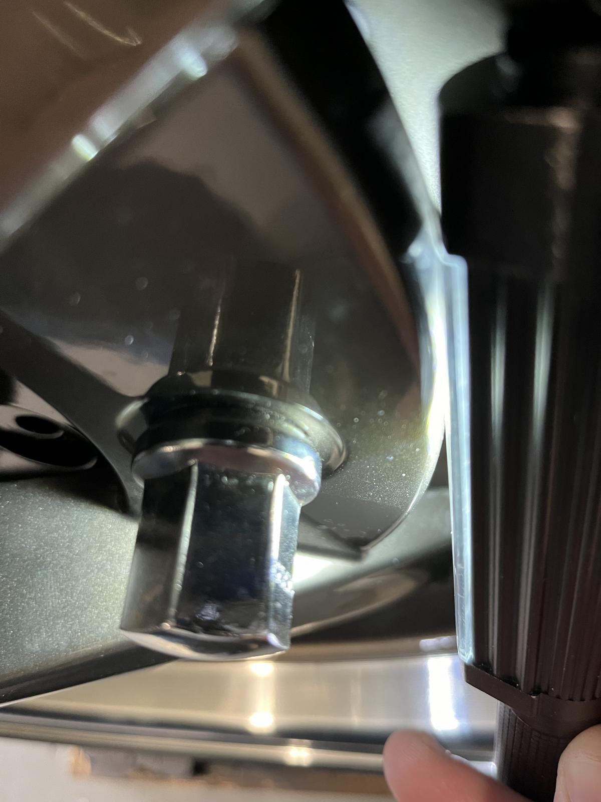

The lug nut in question torqued down on the wheel. Notice it not down in all the way.

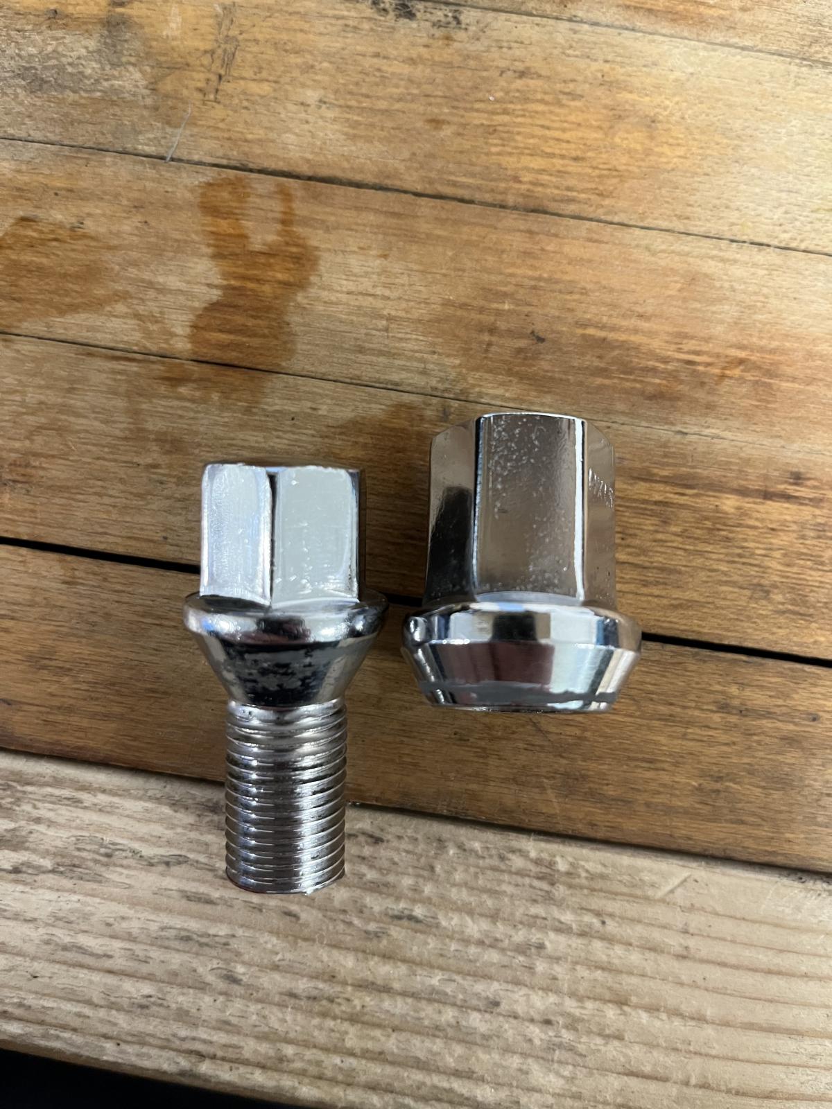

The 14mm lug bolt vs 14mm lug nut with seat markings

Apply some whiteout on the seating surface of the lug nuts. Torque the nuts to spec, take it for a drive around the block and then remove the nuts and inspect the wear marks to see if they are fully seating.

I included pictures in the initial post showing how the lug nut seats against the wheel (wheel picture and picture of marking on lug nuts).
I can try the white out methodology and post a picture as well.
Glenn Premium Member
Mr. 010
Joined: December 25, 2001
Posts: 80413
Glenn is offline
PostPosted: Mon Mar 11, 2024 5:57 pm    Post subject: Re: Lug nut Woes/ Question Reply with quote
I'd say that's not good... minimal contact.

Pull one of the wheels with the lug nuts and place it on the wheel unmounted on the car and see where the lug nut ends up. If it is the same as when it is torqued then that is the way it is with the 14mm lug nuts.
I tried to explain earlier that the 12mm lug bolt you have uses the 12mm thread to the 60mm taper gets smaller until it hits the 12mm thread portion whereas the 14mm lug nuts you are using the taper will be wider since it is based on a 14mm hole.

Pulled the wheel off and the seat is the same off the car.
Makes total sense with the taper being wider having a different contact area.
