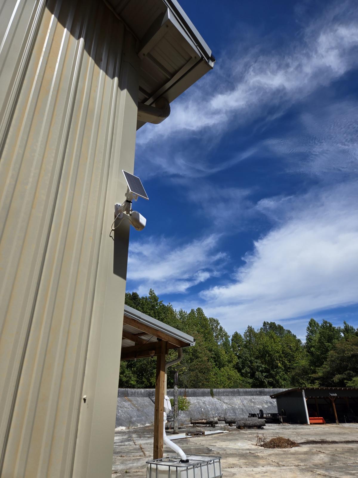

Oh, and we set up two rain water catchments on our shop. Been a long time comin'. Now we just need some rain.

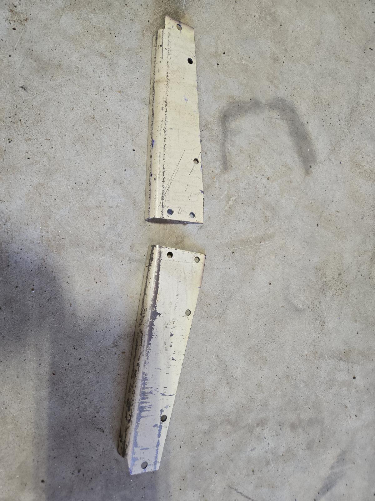

So shift rod bushing has been replaced and I removed the crappy old kinked fuel line and replaced it with AN bulkhead fittings on stainless braided lines in the tunnel.

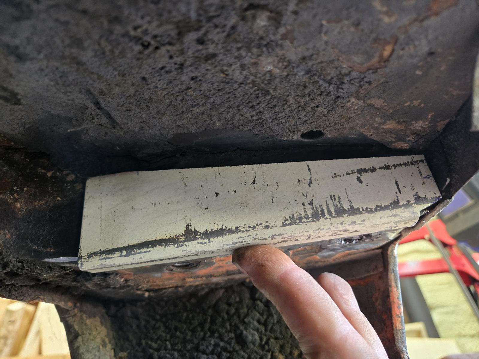

I reworked the holes in the frame at the pass throughs:
And ended up with this:
It was not easy AT ALL. But I am not retyping the whole explanation unless someone is wondering about it.

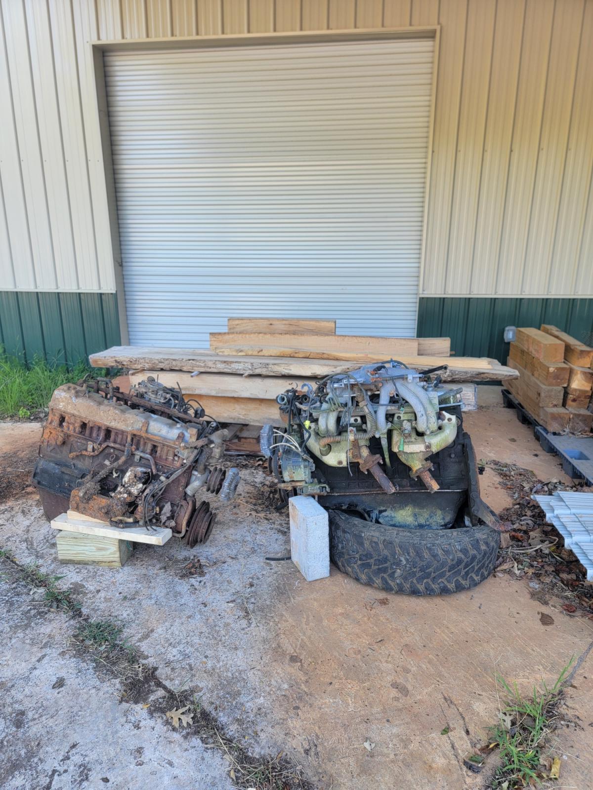

Headed out of town tomorrow to pickup some Landcruiser engines so I will get back on the Thing Monday. After todays 7 hour wrench session I need a break.

Took the weekend to go pick up some engine projects for an old Landcruiser

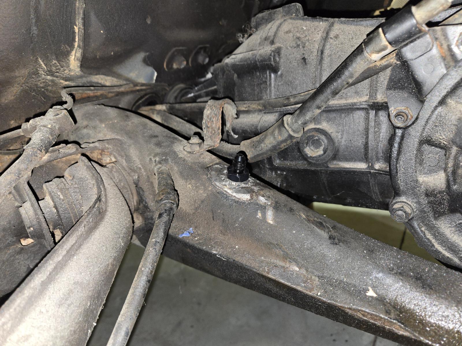

Anyway, made progress today. Rear fuel lines all hooked up.
There was a big hole that the original hose ran through along with the air for the airshocks (which will for sure be replaced at some point) so I cleaned up the edges and added some stick on pinch molding.
Front is almost there. I had to order one more fitting to link the fuel filter to the pump.
Took the design from another Thing owner on here. Thanks @mondshine. Thread here:
https://www.thesamba.com/vw/forum/viewtopic.php?p=10208182&highlight=#10208182

Re: The HPG1 filter, consider installing a shutoff valve between the tank feed and the filter inlet. That way, you can drop the canister for maintenance with gas in the tank.
The filter element itself is good for many years, because 99% of the trash settles to the bottom of the canister.
Just an example: https://www.amazon.com/Beduan-Brass-Valve-Female-S...3&th=1
Good luck, Mondshine

Thanks for the suggestion! I actually have one of those left over from installing an air manifold in my shop. Thumbs Up
It was a tight fit in there with all that stuff.

Started tackling the rear bumper mounts. A PO badly cut some slots in to access the nut plates. One nut was completely gone so I am cleaning that up. Re-tapped the holes for 12mm and welded in a flanged nut where the one was missing. To do all that I had to take the muffler off. Boo.
Headed to Ace for some hardware. Will clean up the slots the PO cut tomorrow and weld some covers on them then spray the inside with Fluidfilm and get the bumper back on and the muffler properly supported.
The stuff to repair the gas leak should be here tomorrow. [Nope - Monday] Amazon is an amazing thing for shop suppies for a project like this.

Not a lot of time today but I did get to work on continuing the repairs on the rear bumper mounts. Straightened the damage and made some patch panels. Cleaned off the paint and rust and sprayed with rust through primer.
