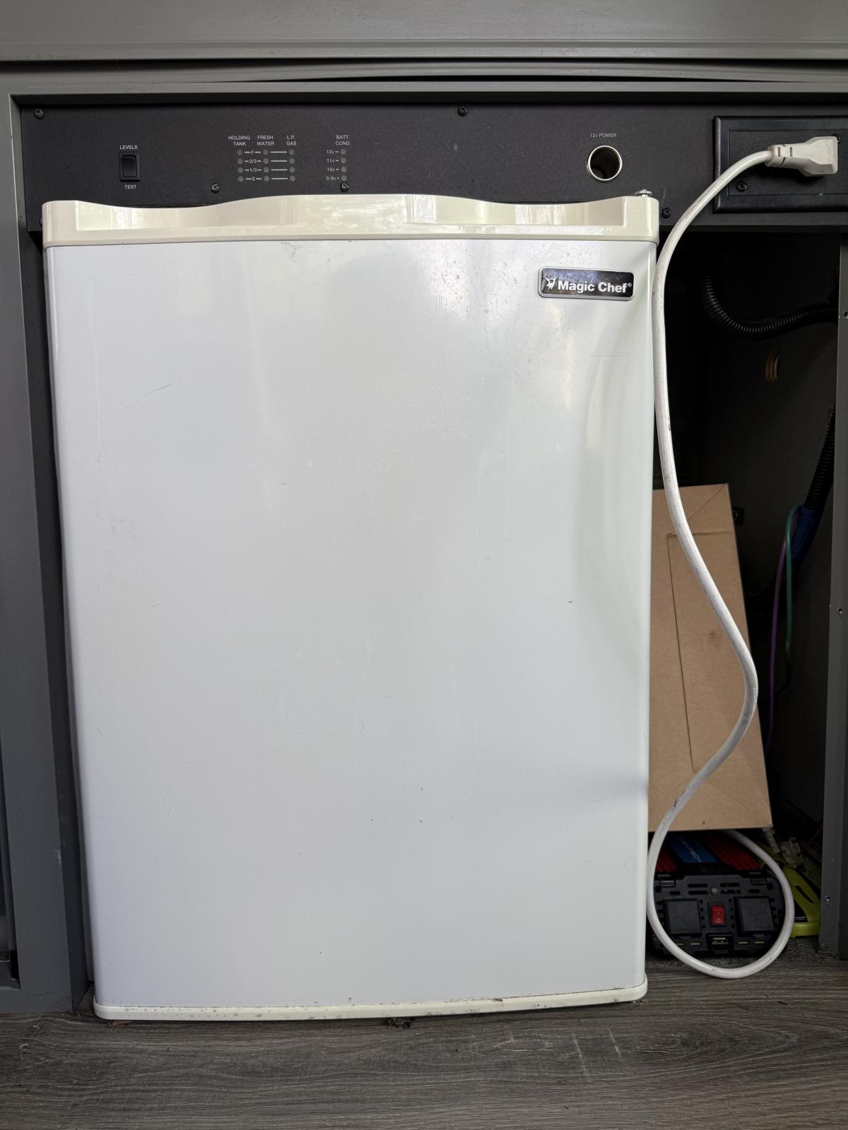

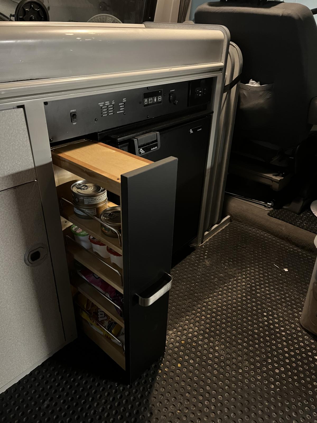

The Norcold 3 way refrigerator in my 2002 EVC had not worked since I bought it 6 months ago, instead of repairing it I preferred to change it for a more modern and efficient equipment. My preference was a device that works with 12 Volts DC and 120 Volt AC, I looked for several options and due to size, performance, noise level and price I decided on INDELB CR 65, it is the same Truckfridge CR65 but with the original manufacturer's brand, it is a Italian company that has been in business for decades. I Purchased directly from indelbnorthamerica.com, awesome service!!!
- I removed the old Norcold dinosaur, a lot of cleaning, sealing the exhausts. Copper plug for the LP Pipe.
- I took the power switch from the Norcold and adapted it to the board above the refrigerator, so I can select the power of the new refrigerator or turn it off: very convenient.
- For the 120 Volts AC supply, buy an AC to DC charger/transformer, with capacity for the refrigerator and connect it to the "house" circuit of the Van.
-To adapt and level the height of the refrigerator, buy a set of 4 furniture legs with adjustable height on Amazon, and place them in the same holes of the small rubber legs that the refrigerator comes with. The adjustable legs range from 50 to 70 MM. I have seen several refrigerator replacements online, but none of them used this adjustable leg option to make it easier to fit the refrigerator in the cabinet. Then with 2 screws in each side the fridge is fixed.
- For the space on the left side available, I used a REV A Shelf from Home Depot that is 5 inches wide and 10.5 inches deep, it is the only one I could find that would fit the space available. I had the front cover made at a place that manufactures kitchens.
Note: still looking for the headrests for the rear seat of my EVC, is anybody knows where or who has it, I will really appreciate the information. Thanks!!

Great use of materials, especially the adjustable feet. Thank you for posting.

This is one of the best Norcold replacements I've seen. Love that you re-used the control from the Norcold.
As someone who may try to emulate your implementation, any additional details you can add to your original post would be greatly appreciate (like links to your amazon adjustable legs, the Home Depot drawer, your converter, etc.).

We did our 2002 with the same Intel-B fridge. Truckfridge was way backordered but the Intel arrived in a few days.
Following another install post on FB we made a "box" out of 1X1 and 1X2 for the base. Not adjustable like yours but stable. We also reused the grill from the Nor-not-so-cold at the bottom.
We also used the same rev-a-shelf and put a 1X6 piece of Oak on the front. I so wish that shelf unit was deeper...there is room for another 6" of depth.
We are so much happier with the electric fridge. Our NorCold worked just sometimes and poorly. The new one is great. We now have a 100 watt solar panel that will be employed next trip.
When folks post about problems with the NorCold I usually respond: "junk the Norcold, get a modern compressor fridge (Truckfridge, Intel, Domestic, etc.) and you will be so much happier." Yes it is pricey but worth every penny.

I got exactly the same fridge a couple of days ago and I'm ready to install it in my 1996 European model.
Did you cut or shorten the old propane pipe? Mine is located between the back wall and the fridge. And it prevents me from pushing the fridge all the way back.

You should be able to tuck the propane line out of the way after capping it. What you are likely running into is the old 120 volt outlet for the fridge. Try rotating it out of the way. If that does not work, you can do what I did and remove the box, splice the wires together and insulate them well.

How hard was it to adapt the norcold control panel to operate the new refrigerator

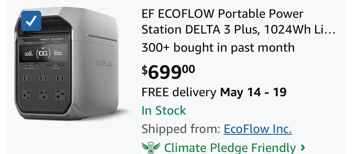

3. Or Should I upgrade to a power station? Keep the ac fridge? Power station has other benefits, move to kitchen station run laptop etc. , this one fits next to fridge.

Dual 6 volt golf cart batteries will only set you back a few hundred bucks, and you can still use the existing charging scenario. Go from 100 to 225 amp hours.

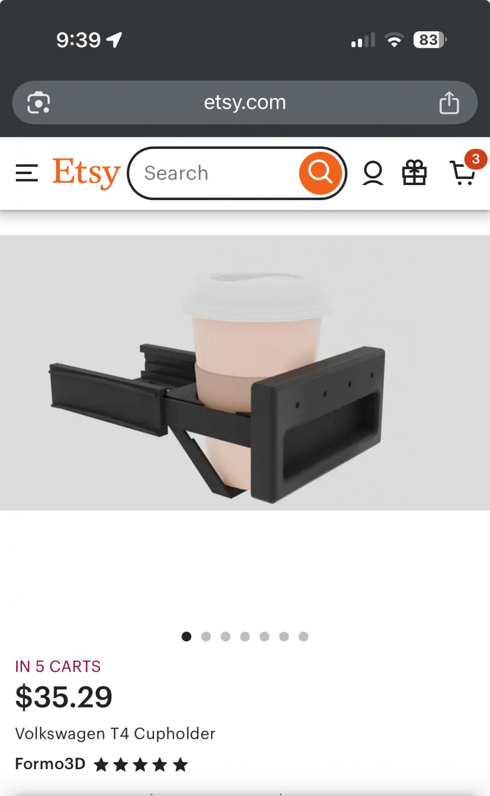

Anyone use this: gotta love what 3d printers can make.

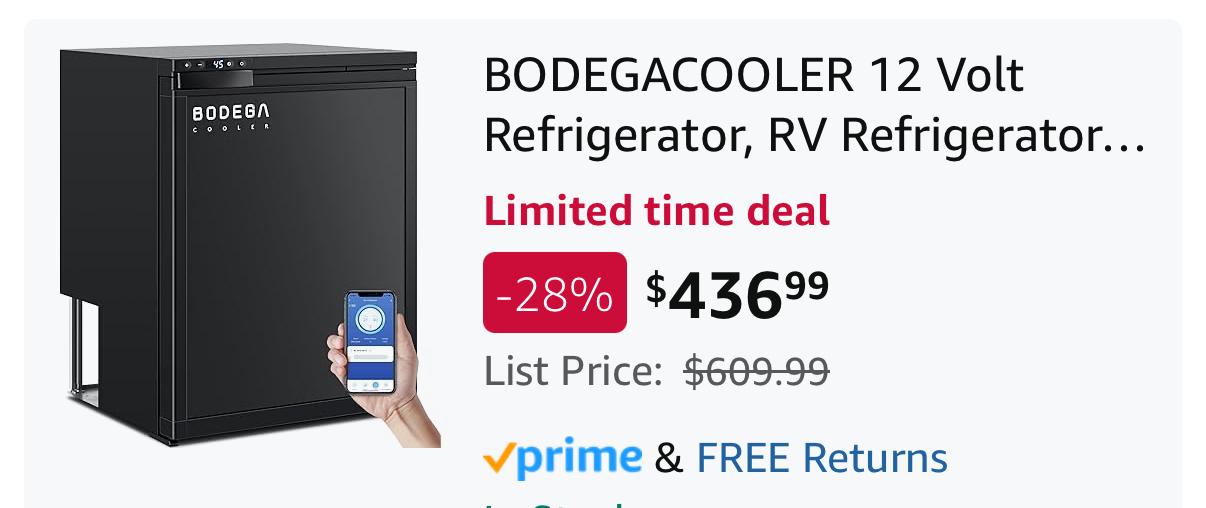

that said, I've replaced the Norcolds in both of my vans with 12v compressor fridges and I have both of them available if you would like. I'm happy to give them away, and help with any knowledge needed to refurb. I think that the biggest weakness of these is the relighter board, which I found I had to replace relatively frequently. these boards can be found for just over $100 online and can be replaced w/o removing the entire fridge. I've done comeplete overhauls of the fridges and when they work well they are great, use little fuel and stay decently cold.
If you want them I'd first check to see how the propane supply was handled by the PO. look in the back and see if the line is still there and just plugged. if so install should be pretty easy.
I'm in Moab, Ut, and would probably not be interested in shipping the fridge(s) but folks are always passing thru town and perhaps someone would be willing to transport for you.
