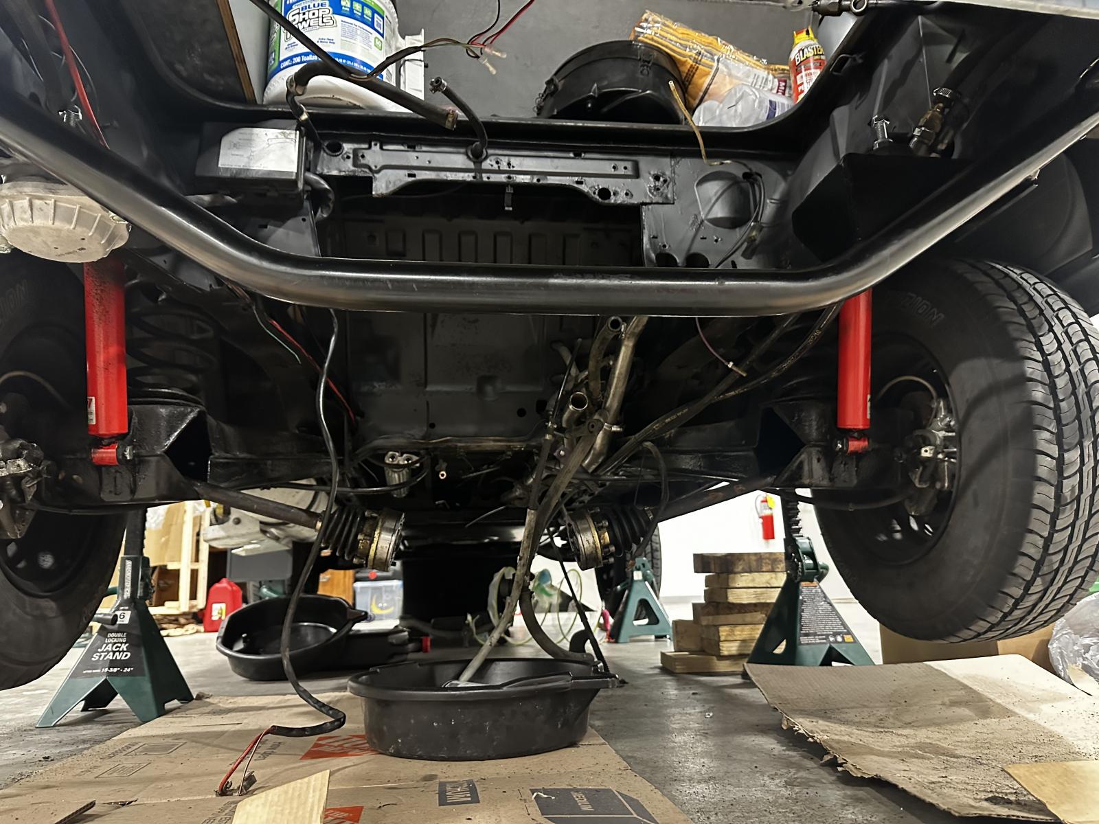

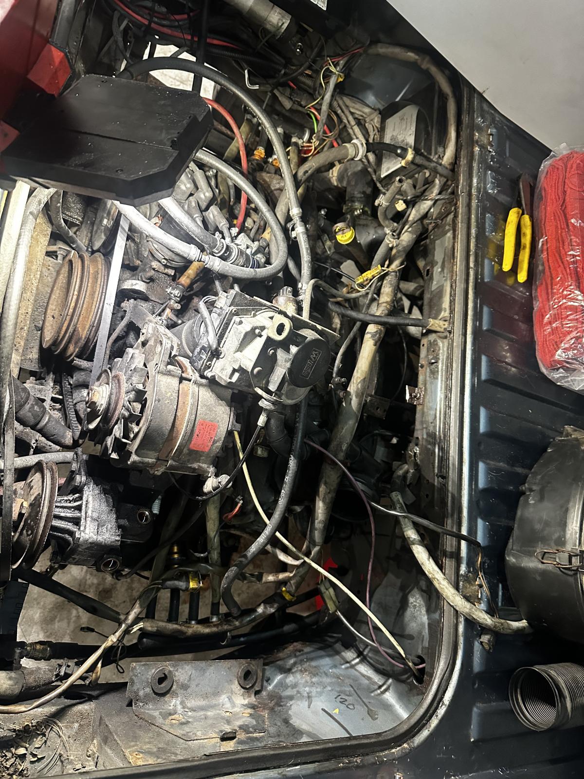

On to removal of the old engine! I was a little intimidated by this, but it wasn't that awful.
Drained all the fluids. I forgot how wonderful a little splash of collant in your mouth tastes.
I also think that I may have filled my power steering with power steering fluid instead of ATF a few years ago. Anybody have any ideas about how to flush it? I thought I could just put one hose end in a bucket up high and the other in a bucket low, pour some ATF in the high bucket and start turning the wheels back and forth...
almost there:
Out!
Engine:
Rusty but in great shape trans:

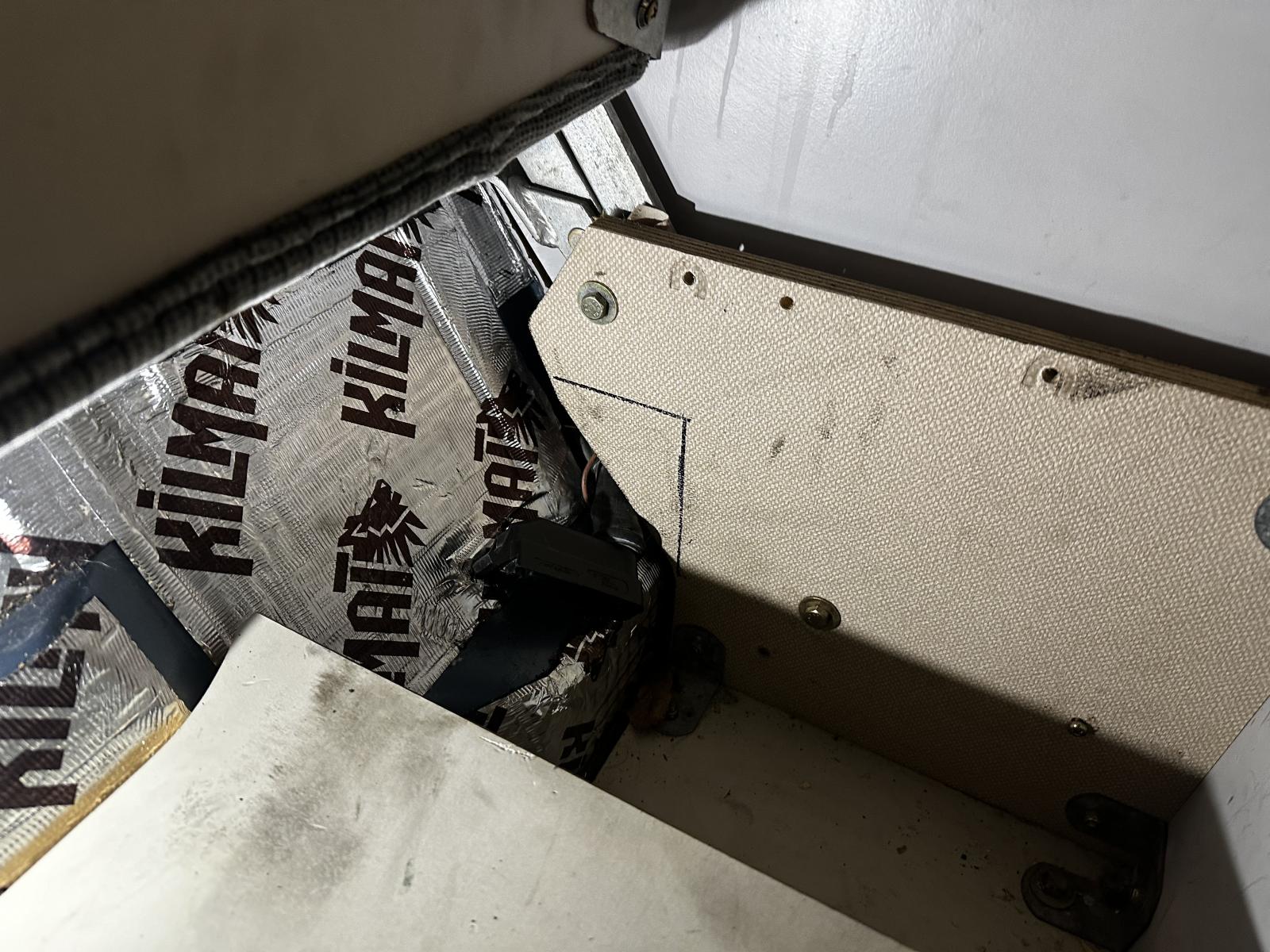

Next I made the suggested cut to the rear seat to ease removal of the existing wire harness and ease intallation of the FAS harness:
before:
after:

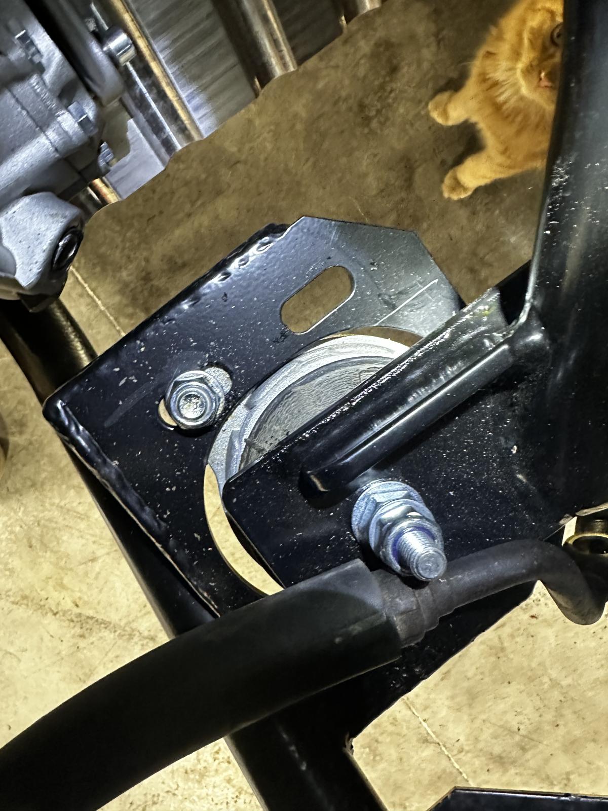

First - test fitting the engine cradle!
Had a little misalignment on the mounting blocks and wallered out the holes to get it right.
Got the engine cradle mounted, but needed to trim a little for fit…
Mounted
Interference on driver side:
Interference on passenger side:
Interferences trimmed and engine cradle set aside:

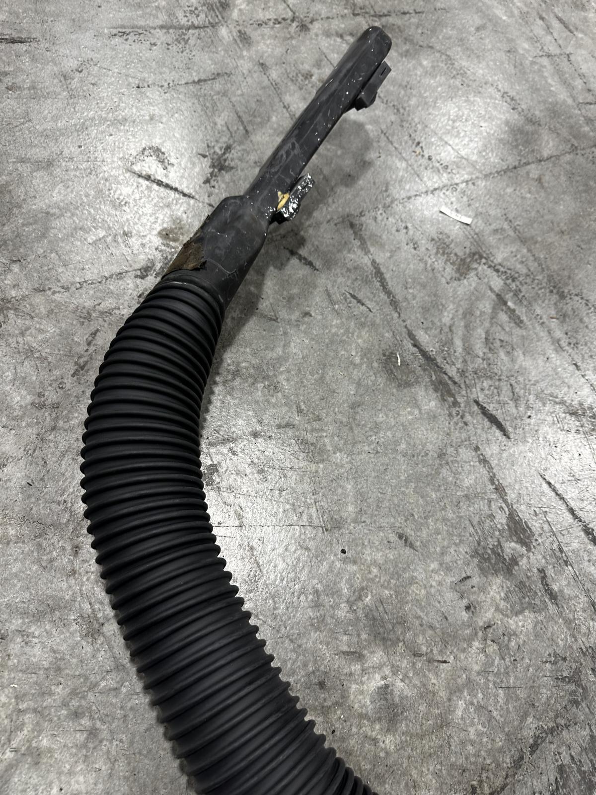

Next I needed to ensure I had good air flow up the D pillar, pulled the snorkel and the old dryer vent I had jammed in there and replaced with the GoWesty ribbed vinyl alternative - should last 40 years!

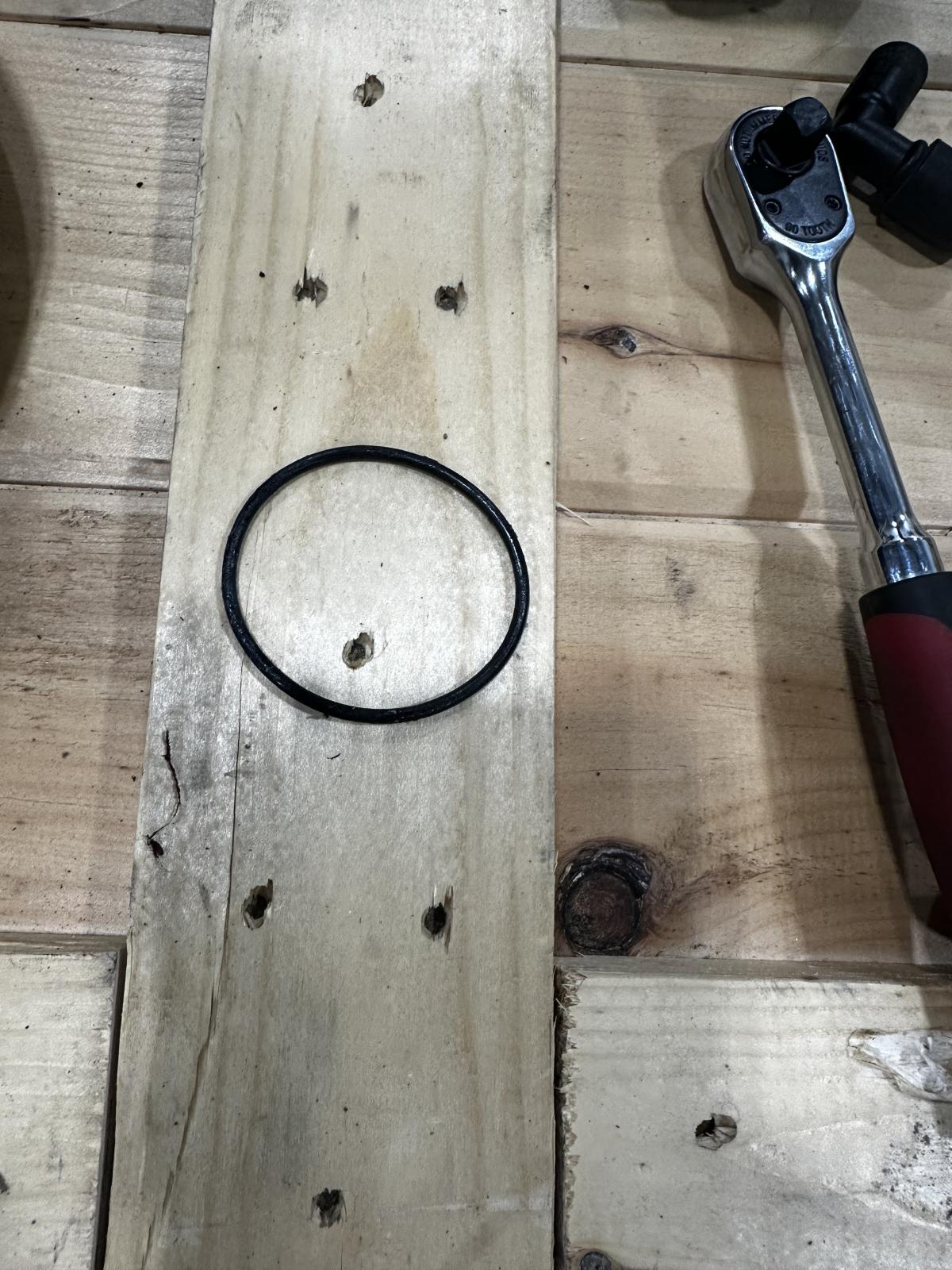

I also checked the old TC seal while I wait for the new one from GoWesty - maybe I jarred it when I was pulling the trans - but it definitely needs to be replaced!

This likely won't be an issue but be sure the join between corrugated hose and intake snorkel won't let rain water into the hose.

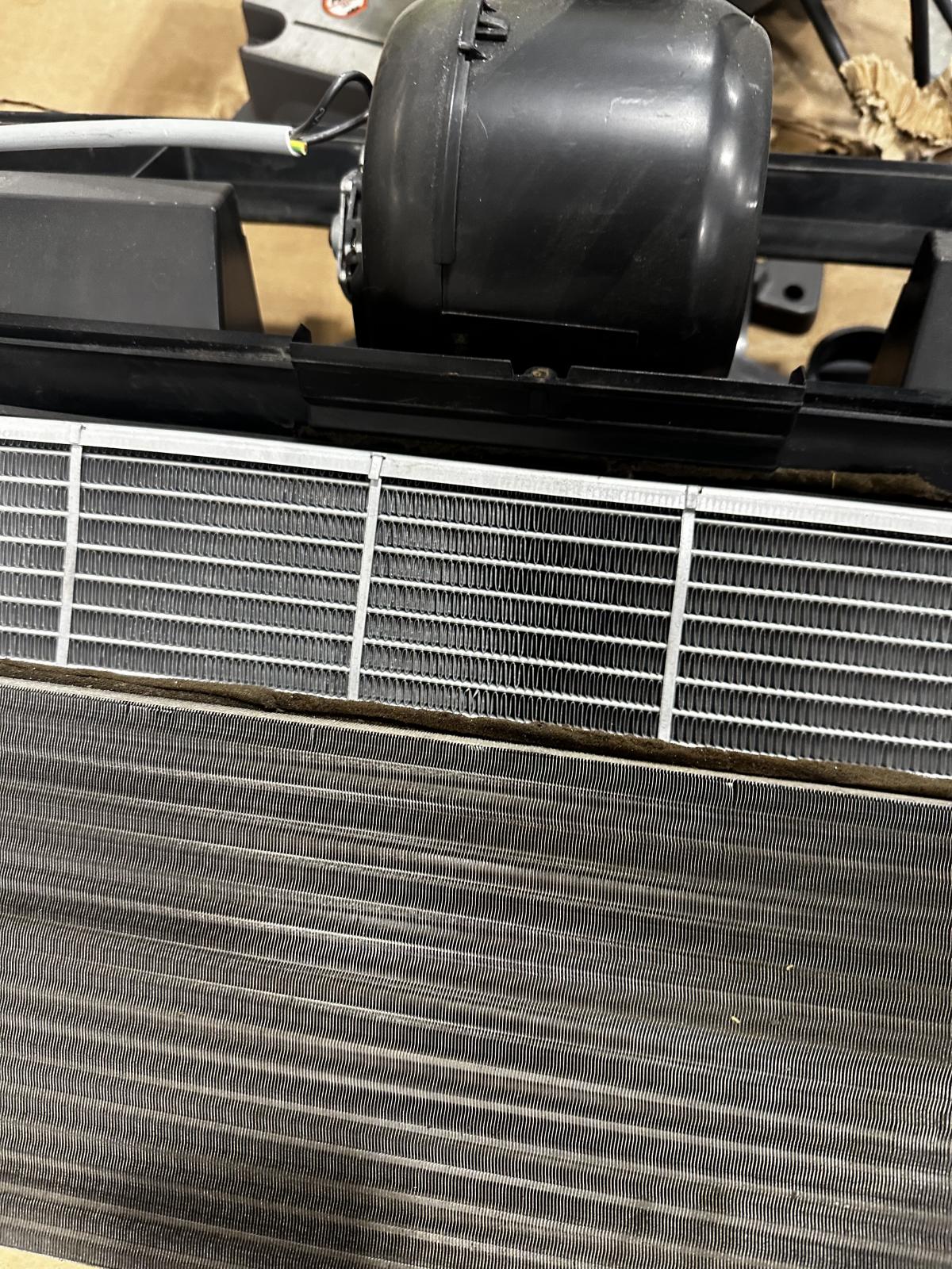

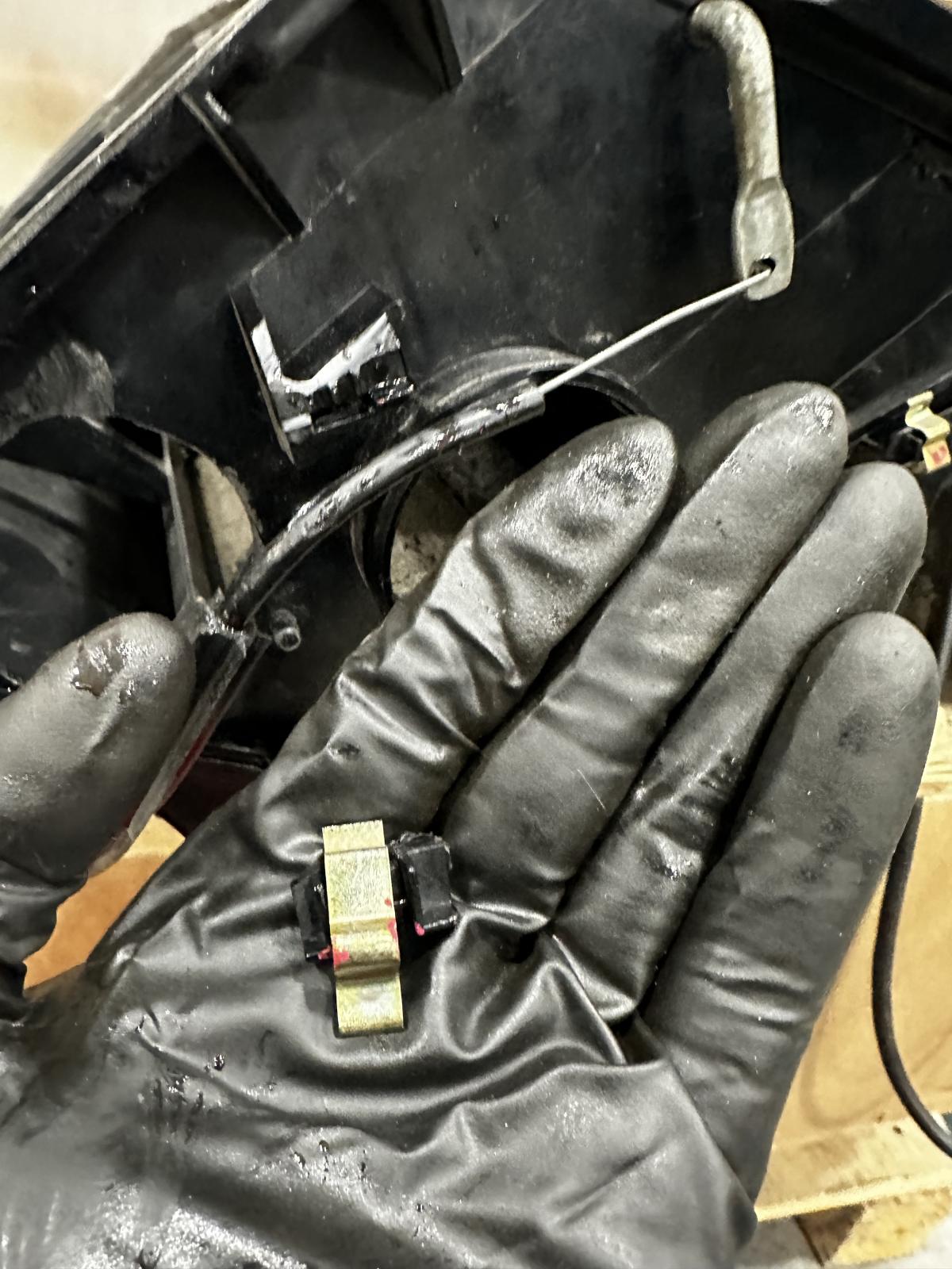

I prepared to rebuild the heater box and put my new to me heater core in and immediately broke a tab.
A few hours and judicious use of super glue, it seems to be repaired. But I was reminded how delicate this old plastic is getting and slowed down even more.
Here is the heater core I got from GoWesty a few years ago compared to the original I got. The number of fins in comparison is crazy, there must be 3 times as many!!!

And finished cleaning up my old transmission and changing the TC Seal

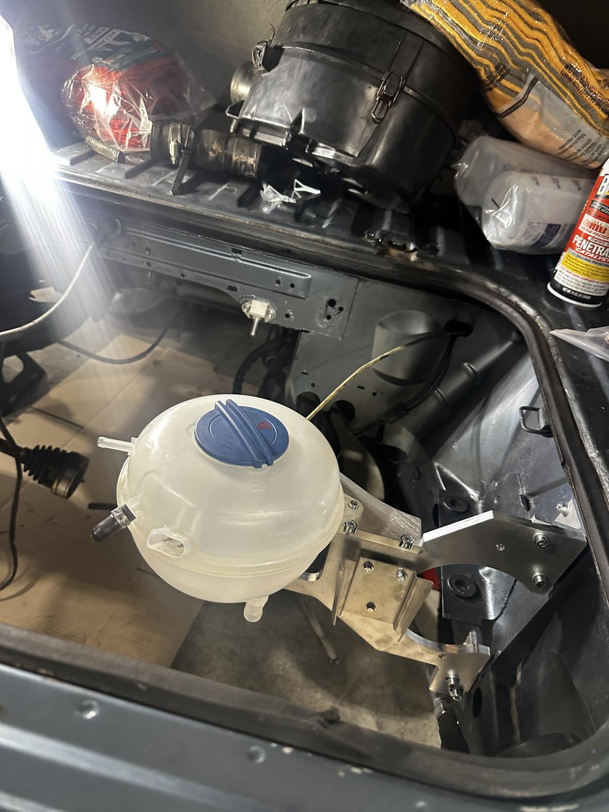

And finally mounted the coolant bracket.

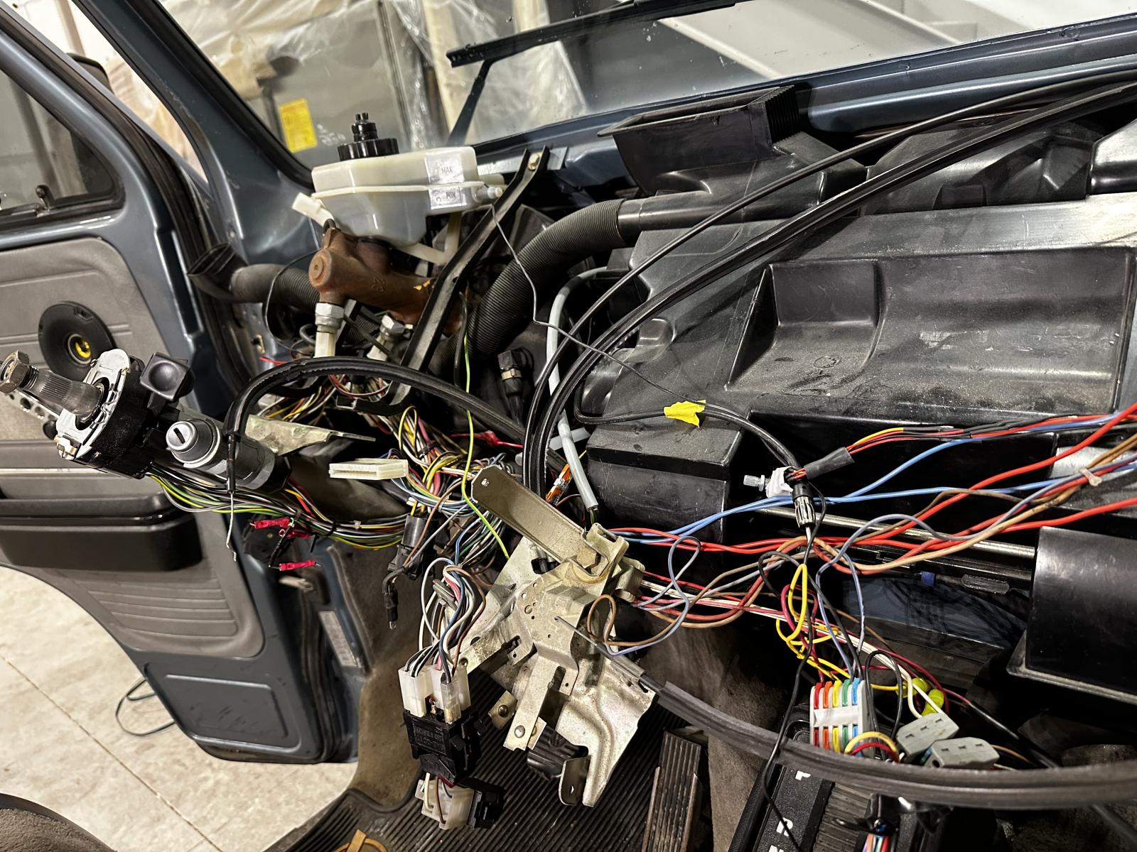

Then I broke into the wiring harnesses and started the ‘to dash’ harness. The FAS instructions were not totally clear about where the hole should be - when I drilled a test hole next to what looked like the right spot from underneath, I came up underneath the rear heater! Broke out the tape measure and ended up with this hole right where it should be…
And looking up from the bottom:
I like the label on their harness wire too!
‘Your bus will like us!’
While I waited for paint to dry I drilled a hole in the crossmember right behind the gas tank. The hope was to feed the harness through without dropping the tank.
Well no such luck - of course. The tank drop is one of my least favorite chores. I only had to lower it and didn’t have to disconnect the filler and crossover hoses, but I’ll have to go back and make sure all those annoying fittings are still inserted into the tank. Finally got the harness fed over the tank and routed up through the passenger headlight and drilled my final 1.5” hole…

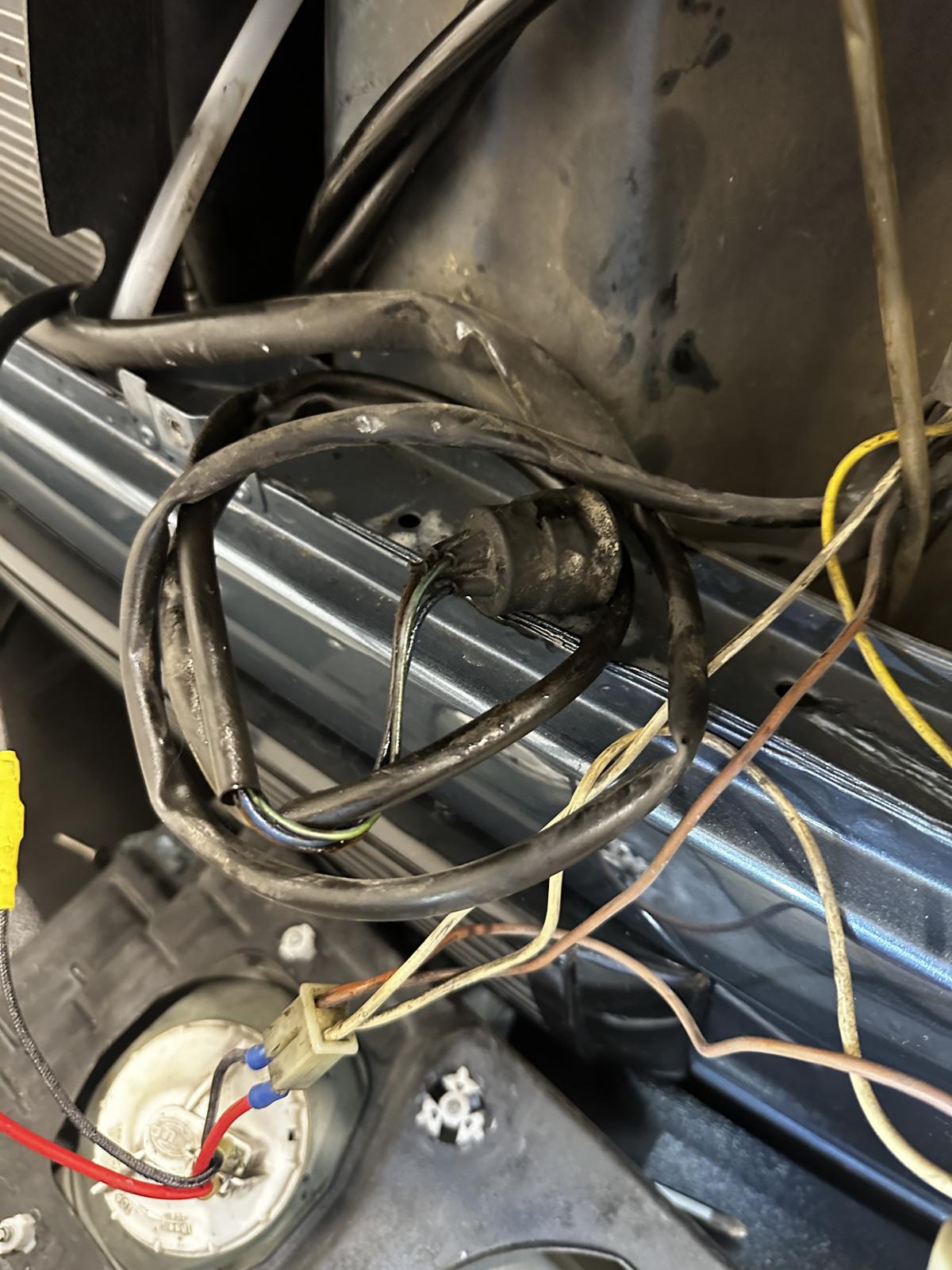

Harness in run from the back seat to the front, still need to tie wire it appropriately…
Next it was time to wrangle the engine harness through the original engine harness hole. I had already trimmed the bench but it could not get the harness to fit. I finally, delicately trimmed some of the wood off of the cabinet with the water tank behind it. I was terrified I’d hit the tank the whole time, but I was successful and the whole harness squeezed through!

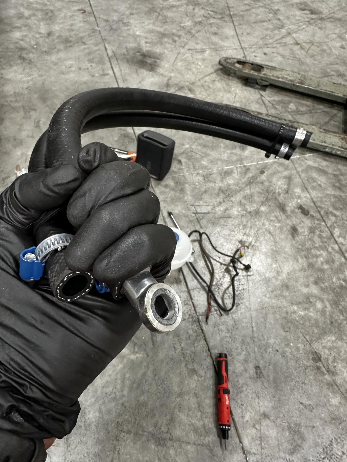

Moved on to some more work - mounting the new coolant pipes! I still have to flush the system..

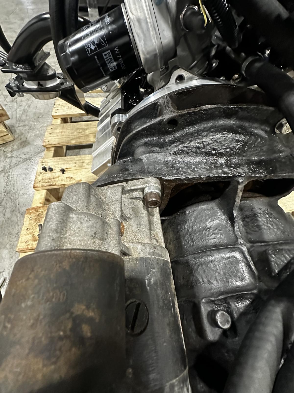

Next I mounted the trans to the engine. Pulled the engine out:
I spent an hour struggling and trying over and over again until I realized the torque converter was not all the way in! Here’s a pic of an improperly mounted torque converter:
The Bentley says the TC should be 10mm inside of the edge of the bell housing. I wiggled a little and -“clunk” it inserted.
Everything was going smoothly until I realized that the bolt for my starter (a GoWesty kit?) was a little too long. I thought the instructions said I would get a bolt with the kit, but I found nothing. I think I needed a m10x125mm bolt, ACE didn’t have it, so I built a little spacer. I also had to buy an m10x90 bolt for the other side trans to engine mount!
With the trans mounted I went to install the torque converter bolts. I spent 30 minutes looking for the hole to install them! Finally found it, bottom left side of the engine!

Well back to it!!!
It was finally time to get the engine in! A few hard lessons were learned.
1) make sure you have thought through your rigging if you are lifting it up into the van. I had to pick up, lower, pick up again, block it up, and pick up a final time before I got it right. I honestly wish I had bought the lift I saw on Facebook marketplace. It was hard work.
2) double check everything is clear before you lift the engine, it’s easy to break things!
Rigging attempt one looked like this:
This got it close but it was too rigid. I lowered it and rerigged with some ratchet straps which seemed to work a lot better. I was frustrated and got no pics of the ratchet strap setup. I also removed the coolant reservoir and power steering fluid reservoir to give me more clearance and room to see what was happening.
They also instruct you to keep everything loose until you are bolted up. That means the little blocks that the cradle mounts to also. I had them cinched down and had to loosen everything.
Also, during all the mayhem I snagged the hoses coming off the power steering pump and SNAP.
The inlet fitting for the power steering pump broke off. Dammit. I emailed FAS to see if I can buy a new fitting, but haven’t heard back.
Does anyone know if that fitting is available or do I need to buy a new pump? Also - my presumption is when I’m buying parts for this engine I’m looking for parts from a 2004 AVH Jetta???
Everything finally went in and I adjusted alignment. The mounts were clear…
And after a little wiggling I was within 1/16” from the bolt in the rear trailing arm to the center of the bell housing. Tightened everything up, checked again and it was on to the next frustrating task!
At this point I needed something easy so I decided to assemble the air box. Gave the filter housing a nice clean:
Then went to put the new gasket in. IMPOSSIBLE! I spent an hour trying to get the gasket (which is just an O ring, not the square gasket that came with the original connection) to stay on. I tried gasket maker, hylomar, screwdrivers, stretching. I could not get it. I finally fished the old gasket out and installed it.
I then went to install the intrepid overland from heater valve I had sitting on the shelf for the last several months, that went smoothly, but it sure is a tight squeeze…
Of course, I had help the entire time!!!
Now for the most embarrassing moment of my weekend. As I started hooking up the coolant hoses I realized there were three hoses that could join with my two heater hoses. Two in the back of the engine and one on top coming out of the oil cooler. Well, I stared at this for at least an hour. Poked around under the van for another hose I knew didn’t exist. I even sent an email to FAS.
When I woke up the next morning I smacked myself in the head - one of the hoses goes to the coolant reservoir that I took off earlier in the day to give myself a little more room. Just goes to show that sometimes you need to step away for a day or two - I didn’t even go near the van the next day - just decided to clear brush and put together a trampoline for the kids!

Make sure you connect the coolant hoses in the correct spot. It took me a while to figure out which direction the coolant was flowing. I painted arrows on all the hoses, big and small.
I drew a cooling diagram for this engine, based on observation and lengthy conversations with Jon (this is one patient man!). Let me know if you want me to find it.
