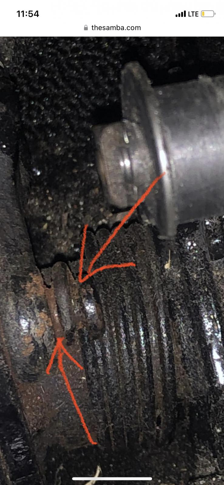

Im assuming this clip goes where the brake Return spring is. Does it go to the left or right of that spring hook and what orientation? Found it under the pedals.

Thanks, so the flat edge sits over the top of the Return spring. Where can one find these odd clips? Does this clip come off when changing a master cylinder? Or did this just pop off on its own?

PostPosted: Wed May 29, 2024 8:57 am    Post subject: Re: Where does the clip go? Brake Reply with quote
The left arrow?

PostPosted: Wed May 29, 2024 9:42 am    Post subject: Re: Where does the clip go? Brake Reply with quote
Yes. It is to retain the pushrod. The spring stays in its groove without any additional ‘help’.
