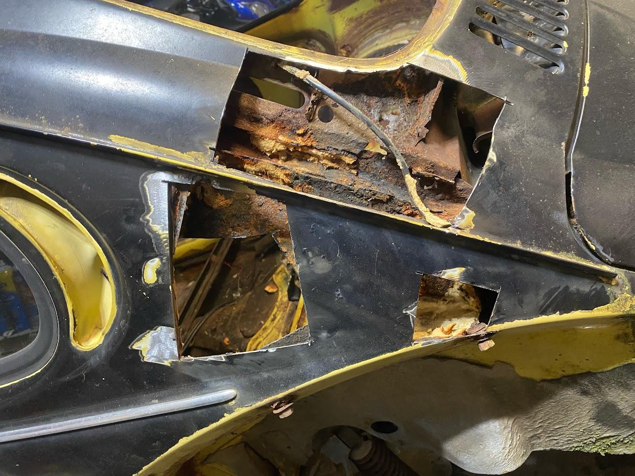

Howdy all, i searched but cannot find the exact thing i need an answer to.
i have my 73 super beetle that has a good bit of rust repair needed... I have a welder, i have repair panels and metal to make patches... that part i'm fine with.
However, its the treatment of said patch panels i need some assistance with. I'm going to be butt welding everything except for the floor pans.
1) For the body patch panels, would i just use weld thru primer and then coat with something like cavity wax? would i use epoxy primer?
2) for the floor panels, would i use the same weld thru primer and then seam sealer on the bottom and top? do i need to coat it with anything else?
3) I'm trying to avoid buying an air compressor if possible so i can have extra money for the repair of this bug. What are some good budget chisels for removing the floor pan spot welds? would these from lowes work? or would i be better off getting an air hammer/chisel and an air compressor?

I assume you are talking about painting the INSIDE of the welded patch panels?
If they are accessible after welding I would coat with Master Series or KBS Rust guard. These are moisture cured polyurethanes and are VERY tough and seal off the metal surfaces. They don’t need hardener and can be brushed on with great results.
With the pans I would paint again with KBS or MS, then if you want to use seam sealer, then overcoat the seam sealer with some more paint. I’ve found that if you flood the weld area with paint you may not need the seam sealer if you ensure you get it into all the pinholes.
With the pans, you can just cut off the pan at the perimeter leaving a 1” flap on the outer edge. Get a sharp chisel/ screwdriver/angle grinder and cut through the flap. Grab a pair of pliers (strong longish nosed pliers) and grab the end of the flap perpendicular to the flap and start twisting the flap around the pliers like an old fashioned sardine can. The twisting motion will easily lift the metal between the welds. With a bit of judicious twisting a lot of the welds just pop off and those that don’t can be coaxed off with any sort of chisel or sharp screwdriver you have. Then just grind the nibs flat.
If you don’t want or cannot afford the air compressor then this is an easy way.

Good advice given. It would not hurt to buy one of those manual chisels in your photo, just in case. Most of the spot welds will twist off. But there are sometimes some where the metal breaks off (weakened by rust), and you got nothing to grab. Compare this to the old pop cans where the opener broke off, and you had to use a can opener to get to the liquid. What size and length you get is up to you.
You appear to have rust in the usual places, Master Series is a good choice, I have used several quarts, and have an unopened can on the shelf for the next project. It is moisture cured, I think I read somewhere that it might actually pull moisture out of the rust as part of the chemical reaction. This might account for how well it works. You will have problems with the backside of the panels you weld in, as Master series applied to those will burn off from the weld heat. Get some cavity wax and one of those long wands, and stick it up in there and give it a good spray.
