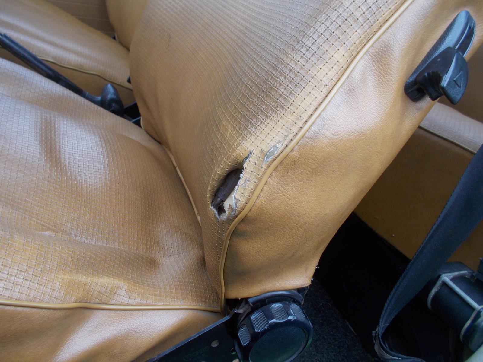

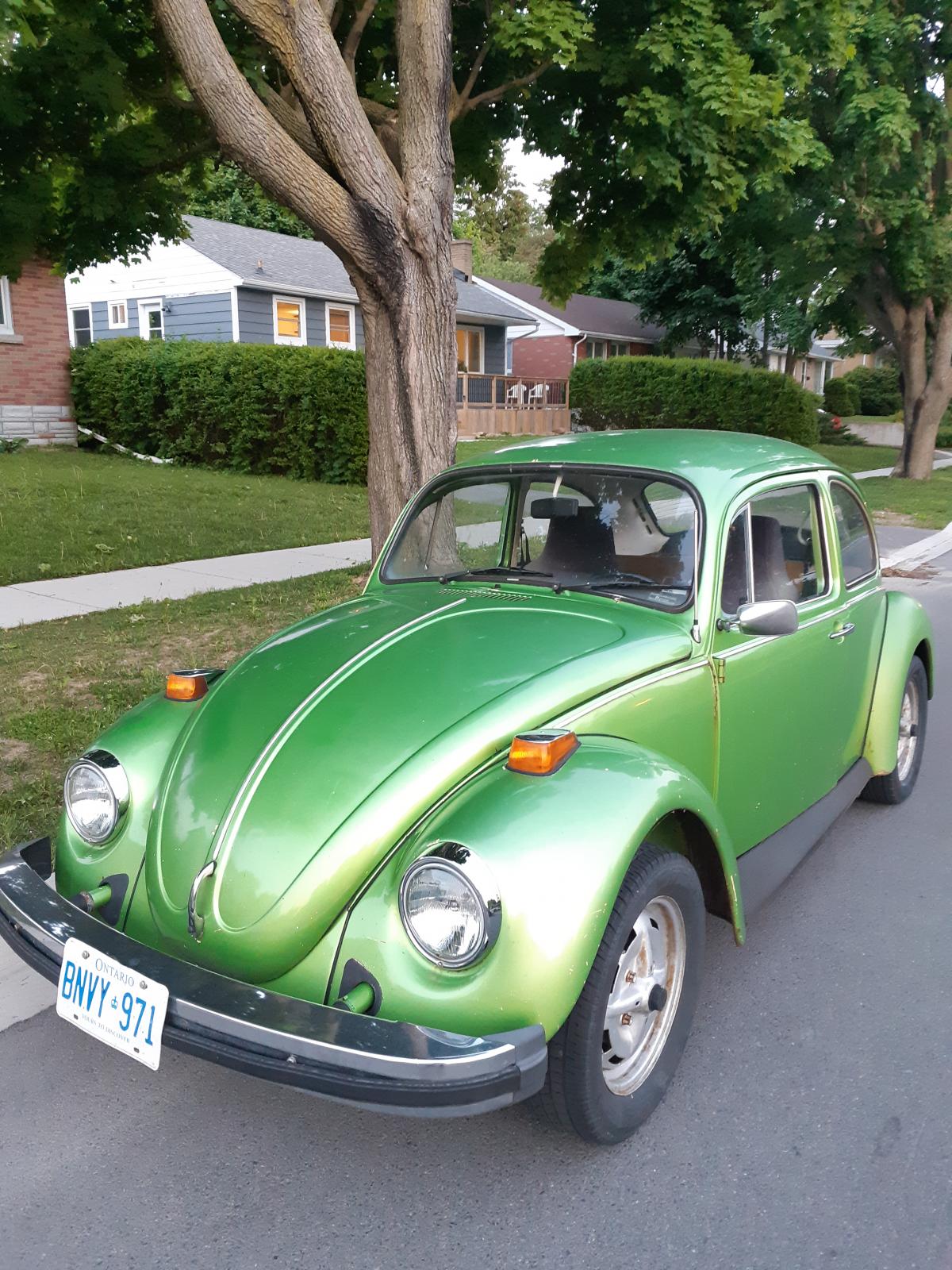

Alright so after debating about if this was going to be enough of a project to make a thread about it, I've decided it'll be slow, but i'll try and update with pics everytime I do something with the car or any questions I have for people. In the meanwhile, little background on the car:
Bought the car around 2 months ago, put a bunch of work into it, which included an all new front end, a tune up, repadding of the seats, and basically general cleanup of the car. Oh I also removed a crappy cassette player some PO had installed... it only worked sometimes haha.
The car is 100% Canadian, was bought new in Toronto, and the first owner had it for 20 years! Well, im the 6th owner now, and its my daily driver for the summertime when I'm not at school.
Enough of my rambling, PICS! (Sorry if they're a little blurry) Embarassed
So anyway, ideas? Thoughts on the car or a direction I should take it? Stock or change some things? I'm open to ideas so I wanna hear them Very Happy

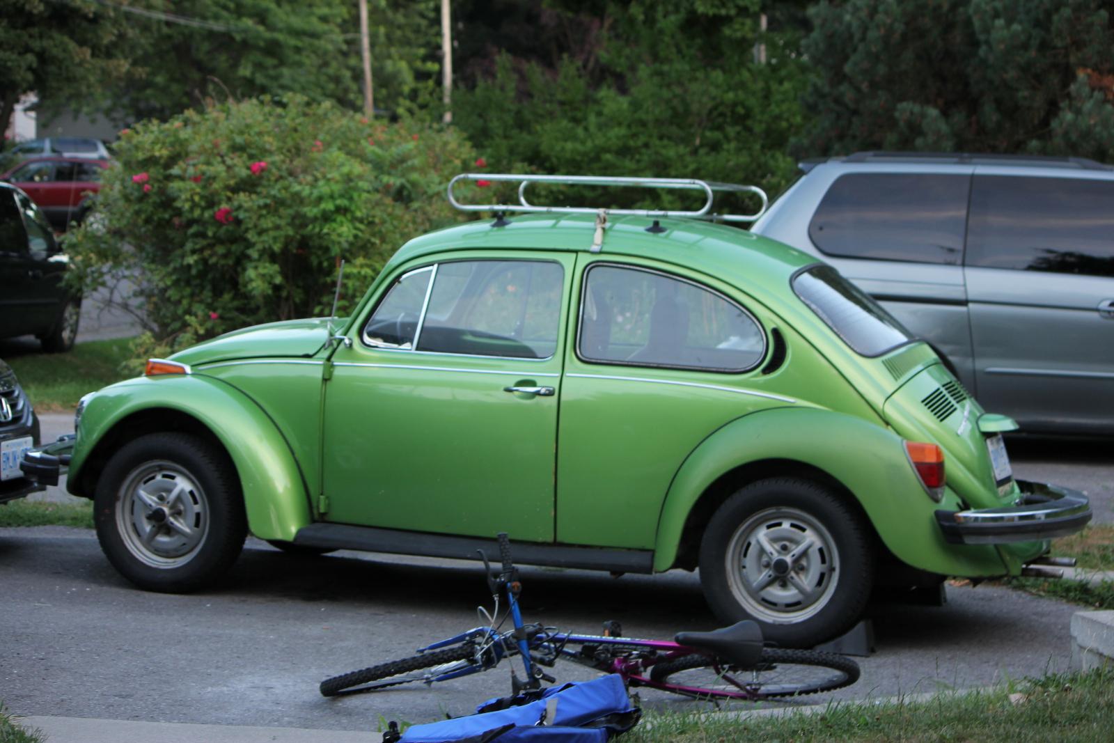

So once again with the updates:
Not much to report with the car, mostly been tinkering with it when I have time outside of work, I've done a few things.
-Replaced the plastic pitted and broken headlight rings with new metal chromed ones, they look pretty good compared in my opinion,
-Just replaced the steering wheel with a superior 500 wheel i picked up at a car show, really love the look and feel of it.
-New hood and decklid seals, haven't finished installing those yet but working on it.
Anyway, i'm having a couple problems with the new steering wheel. It won't cancel the turn signals, and the horn has ceased to work since I put it on the car. Anybody have any ideas to help me?
Always gotta include pictures too:

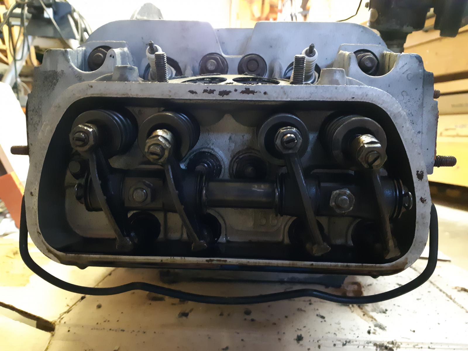

So this project kinda took a real interesting turn recently...
Its been a while since I updated this and this is why:

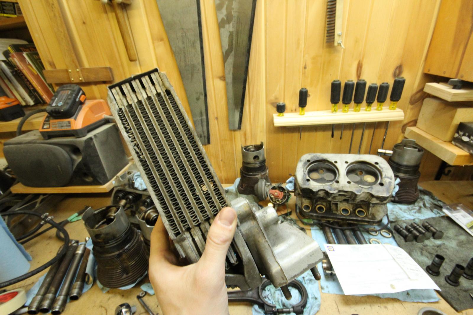

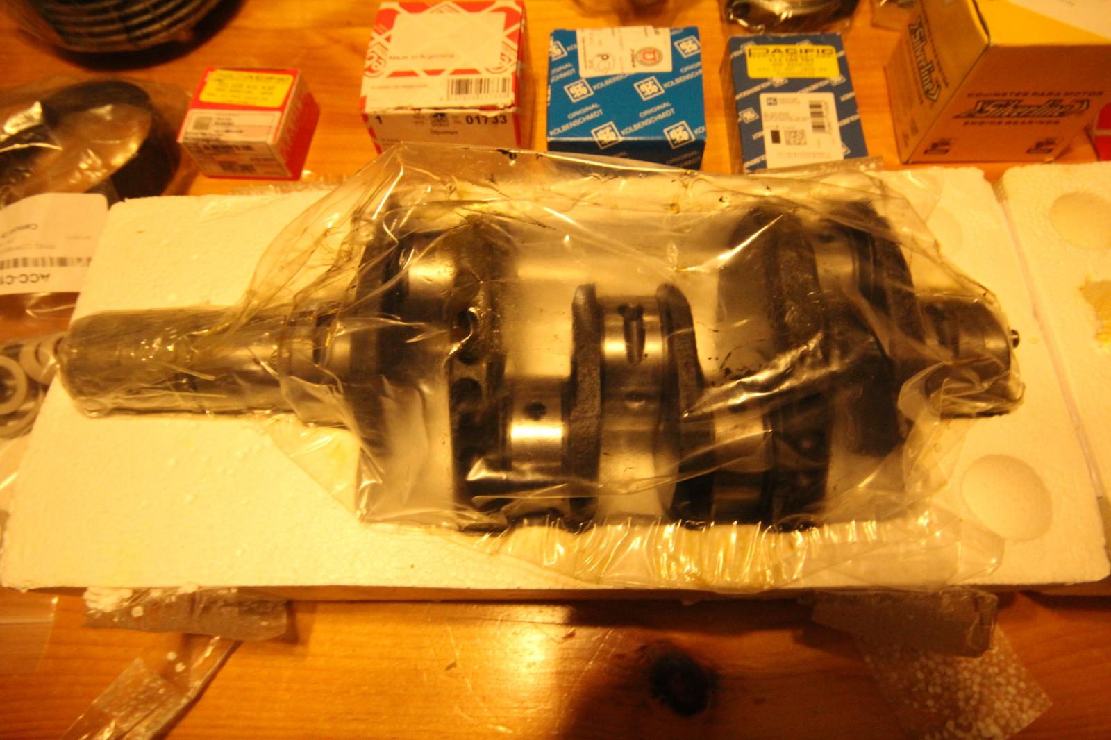

Turns out one of the rod bearings decided to shred itself onto the crank, locking the motor up. I took the engine out, totally dissassembled it, and now i'm in the middle of a rebuild.
The offending rod ^^

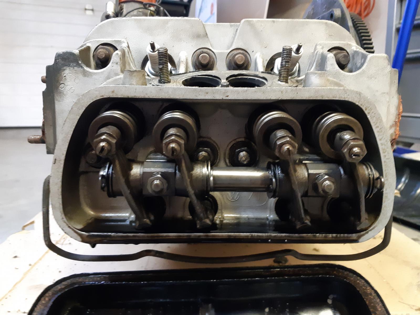

Lots of crank damage, ended up buying all new parts for it, decided to just play it safe.
P&Cs are getting replaced with Mahle 85.5's.
Lifters and cam were badly worn.
Cleaned up a few very oily pushrod tubes, gonna reuse them and the pushrods.
Oil cooler will need cleaning but will work when I'm done with it. Also needs the hoover bit i guess.

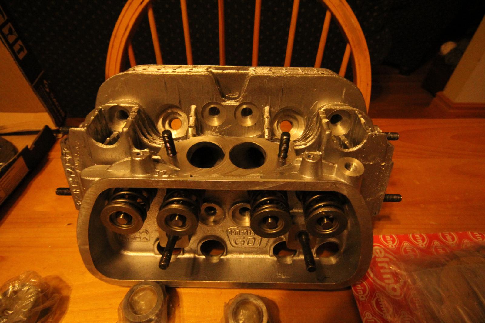

Heads are cracked, got new cast ones to replace them.
Gonna reuse the flywheel.
Been fixing up the engine tin, lots of rusty bits covered in oil too. The car leaked quite a bit before I tore it down, but almost all of the tin has been a simple repaint and hammering it straight again.
Oh also I re-greased the window regulator if you're wondering why I have my window glass sitting out.
These heater boxes have been weirdly patched as you can see. Confused
Seems as though a PO welded up the rod that controls the flap inside? Why they would ever do that is beyond my imagination. I'm not sure if i'm going to try to fix them or to replace, but we'll see. They're also missing the lever mechanism.

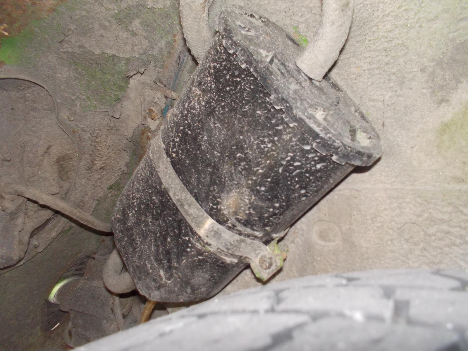

I cleaned and refilled the charcoal canister, no more smelling like gas in my car!
I plan on replacing the rest of the fuel lines with new reinforced 7mm hose. All the vacuum hoses will be replaced as well before the motor goes back in the car.
The gas tank is gonna come out, I'm gonna clean it out and re-seal it so I don't have another problem with crud in my fuel lines clogging the injectors.
The injectors are going for a sonic bath at a local high school shop class near me, thanks to a good friend of mine.
I also bought new transmission mounts, front and the 2 rears, plus the nosecone seal to the chassis. The car had quite a terrible shudder from torn mounts in first gear, and the shift rod coupler was sloppy as heck. I also picked up a new shift rod coupler. All those parts came from Wolfsburg West.
I also got a new electrical portion of the ignition switch from WW, replaced it and now I can unwire the PO hacked push start button underneath my dash. (I'll get pics of it later.)

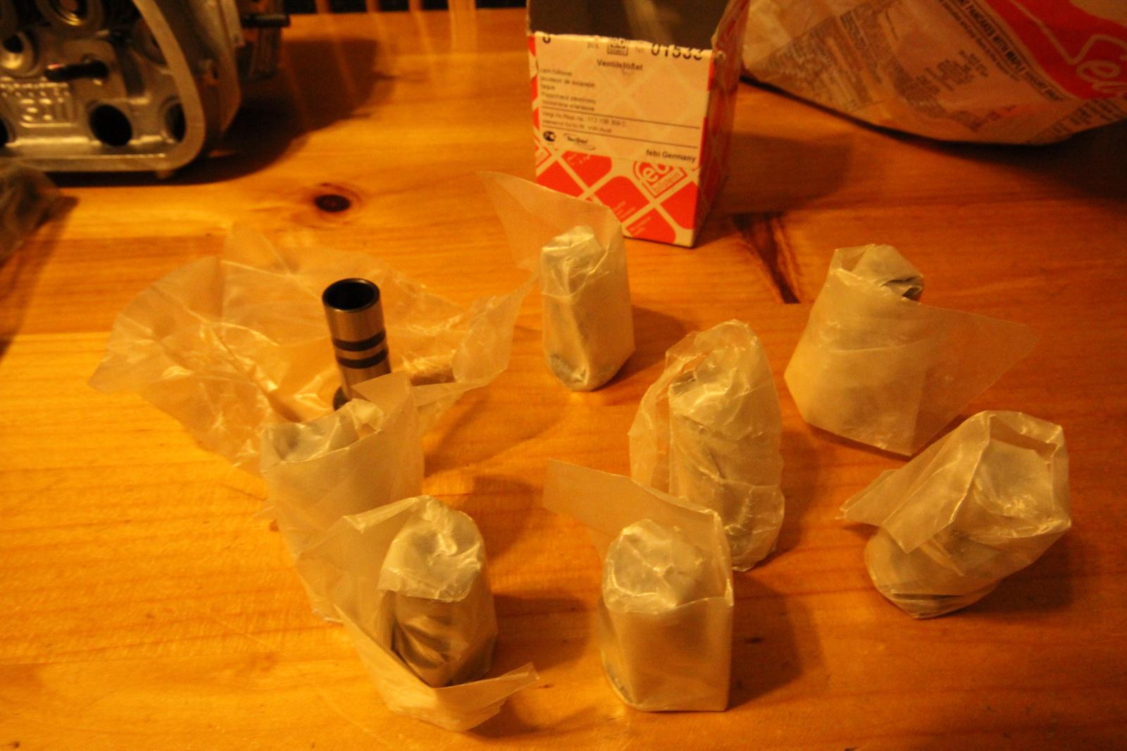

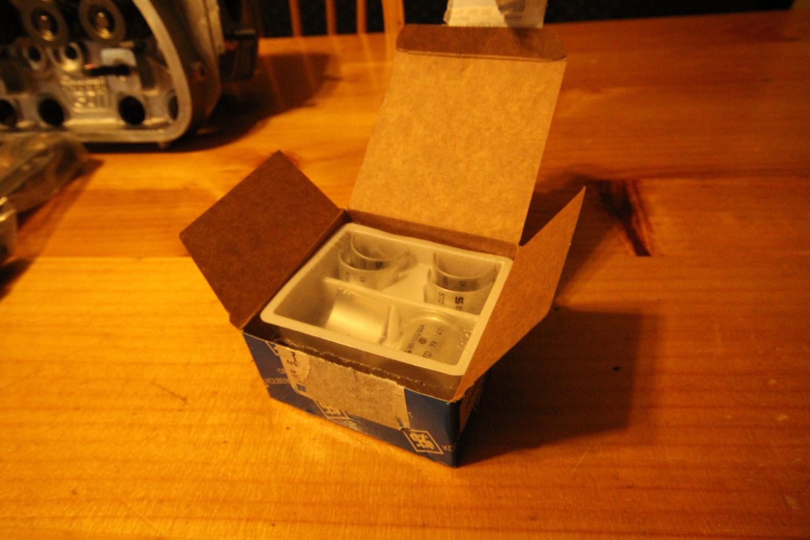

The parts all arrived last night, couple big boxes from CIP1 in British Columbia. They all look to be real nice and I think I'm gonna have a blast on my first engine rebuild.
New stock crank.
Stock grind cam.
Brand new lifters.
Brand new connecting rods.
Mahle 85.5 P&Cs.
New heads.
New clutch.

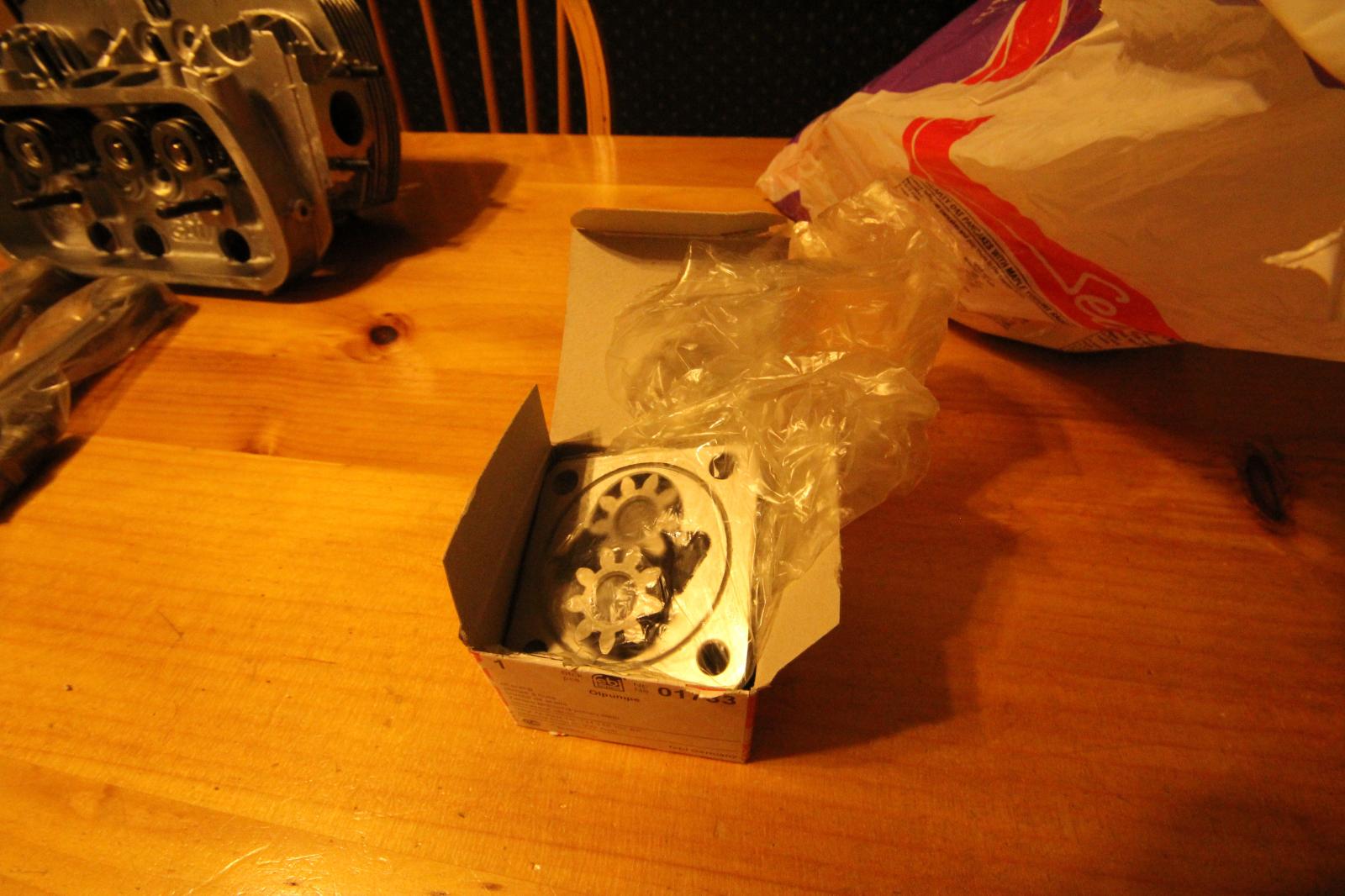

New oil pump, the old one I believe was failing and that contributed to the rod seizure.

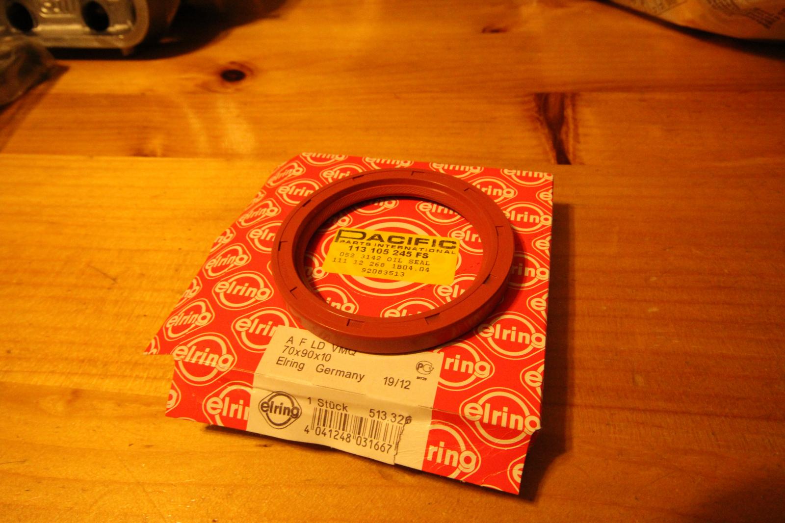

New elring flywheel seal, beautiful and soft rubber as compared to the one I pulled off the motor Rolling Eyes
New main bearings.
Cam bearings.
Rod bearings. Hopefully none of these decide to repeat their predecessors. Evil or Very Mad
Rod bushings.
So thats where I am with the car now, today I'm going to pick up some cam lube, lubriplate, assembly lube, and order some other miscellaneous parts I need for a few other jobs on the car.
I also need to go through the entire fuel injection system, cleaning all the parts and fixing some of the issues that the car had before it died. It started very badly, would take probably 10 or 15 seconds of turning over to start, which I believe is linked to bad grounds at the fuel pump or the double relay. It also would not idle without me on the throttle for the first 5 minutes. Only would idle when warmed up, so I think thats a cold start valve, or auxilliary air regulator issue. I'm going to troubleshoot it in a few days once i finish up my essays for school Rolling Eyes

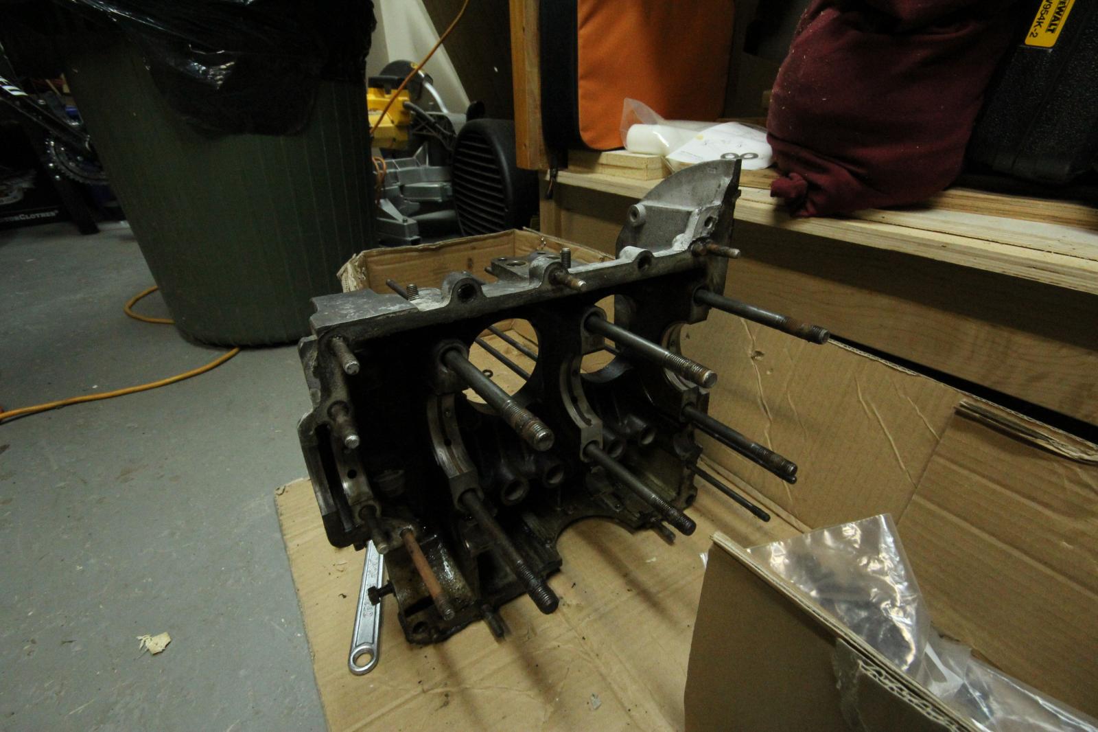

Looking good! Couple comments though. Is that a new case, or your old one? Did you havr it line bored? Why no counterweights on the new crank? Also your new rods should have new bushings installed, why buy another set?
AlanInMass54
Joined: August 29, 2003
Posts: 1105
Location: Massachusetts
AlanInMass54 is offline
PostPosted: Sat Nov 02, 2013 7:39 am    Post subject: Reply with quote
Slightly off topic- you don't plan on changing that excellent color I hope! If I were to get a late model it would be that color! Cool
AirCool909
Joined: March 13, 2012
Posts: 79
Location: Ontario, Canada, eh?
AirCool909 is offline
PostPosted: Sat Nov 02, 2013 9:04 am    Post subject: Reply with quote
Thats my old case, no need for line boring as this was a pretty low mileage motor, and everything is still within measurements. The crank is uncounterweighted because from all that I read, you only need that if you're going to be revving it above 5500 rpm? Also it was cheaper... Embarassed
And I wasnt aware that the bushings came with the rods, so I went on the safe side and bought them. They were really cheap anyway, and I'm sure I can find a use for them haha.

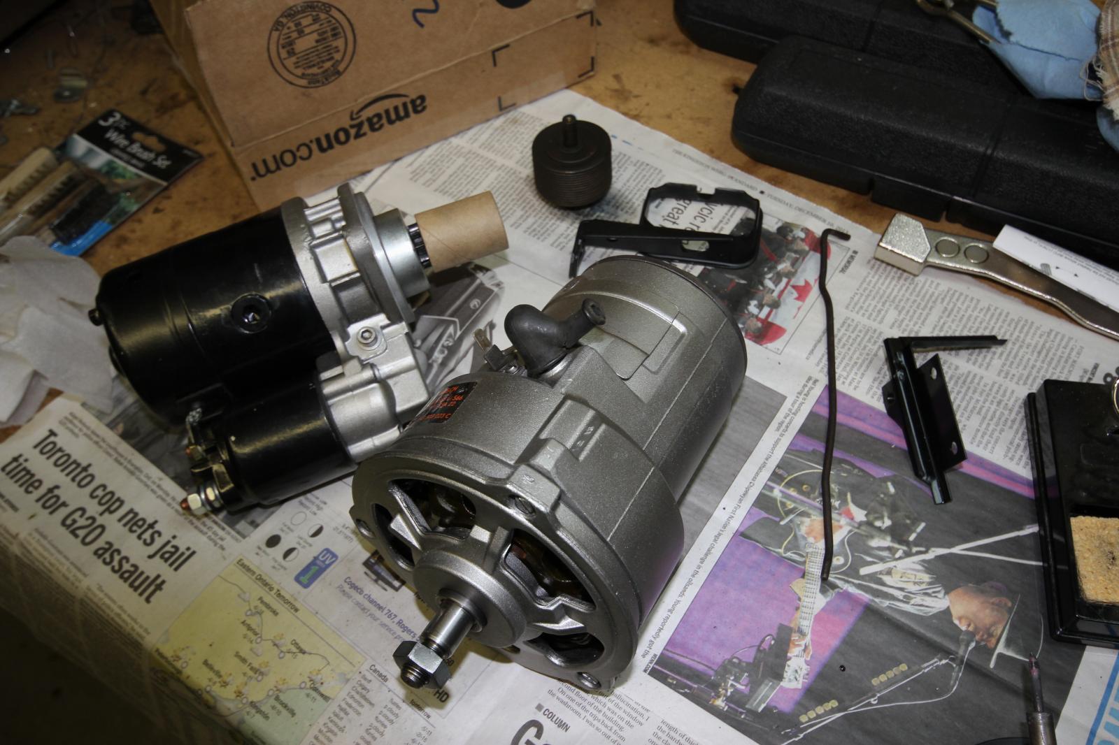

Finally, can anyone tell me what this electrical connector is for? Ive seen pictures of FI blocks with this black connector and a wire, but mine is broken off.
As well, does anyone know where I can buy a new one of whatever this thing is? haha.
That's your TDC (top dead centre) sensor, used for the diagnostic plug on the firewall (used the pickup on the #1 plug wire to set timing)... I honestly don't know if it has any effect on the EFI though.

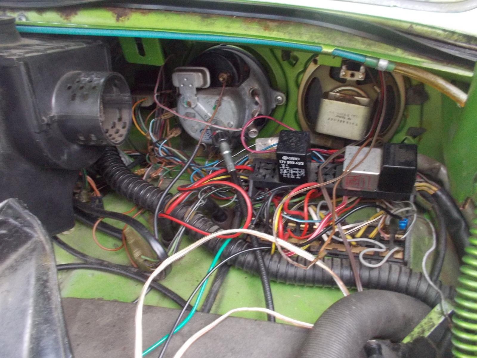

- Built the FI engine, but have problems with 40 year old wiring on the FI harness.

- Painted the wheels, inside and out, silver on the outside and flat black inside.
- Polished the rust off of the bumpers with water and aluminum foil, surprisingly works well Laughing
- Have a new master cylinder coming from WW, got new wiper blades, and the parts list still grows...
Now I just need to hook up the pre-heat system, and solve a hesitation in the low end while driving. Probably a combination of how cold its been around here lately, and the lack of pre-heat/thermostat/flaps.
For anyone wondering about Dansk heater boxes, the pair that I got work great, I just lack the means of turning them off for now though Laughing they put out lots of heat.

Alright, this is somewhat a follow up to my promised pictures of the headliner, and partly just trying to document the flaws/build of the car more thoroughly.
So turns out I do have a 5 bow headliner. Perhaps this is just a Canadian thing?
Another small project I'm trying to sort out is the bumper strip I mentioned in my previous post. The metal tab that bends over the bumper to hold it on has broken on one side, so I will be fabricating a new piece.
Good side.
Non-existent side.
Some other pictures/comments/problems with the car:

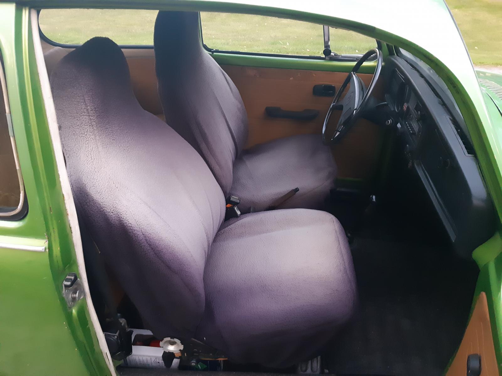

Seats are alright, when I bought the car the girl PO was driving around on the seat springs Shocked I cut foam to shape (which was bought from a local Fabricland) and recovered the seats with the original covers. There's a few rips, and the one big tear here to the drivers seat (was already there before i put the foam in, I did not make that rip).
My plan is to replace them with TMI sand tweed covers.
Refilled the charcoal canister a while ago, I plan to replace the other "smelly" parts of the evaporation system (filler neck hoses) cause the car still has that nice old VW smell Laughing
Bit messy, I've been eyeing a 12V washer pump from CIP1 which I'm going to buy to replace the stock pump setup. The amp and speaker setup in the car are pretty rudimentary (mostly $ free). I plan on cleaning up the wiring and installing a radio in the glovebox.
Nice rats nest... Also need to replace the speedo with the correct '76 dated unit (current is a '71), and the speedo cable's going to be replaced as the needle jumps around. Anybody want to chime in about which cable to buy? I can only assume since I do not have the EGR box and two cable setup, I would need a 71-74 cable?

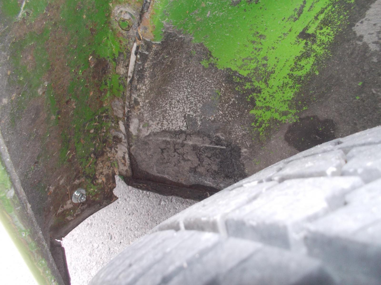

Pan is good, solid and I repainted the inside 3 years ago. It has a lot of undercoating on the bottom which has protected it these many years evidently.
There is evidence of an accident in the past however, the right door has been replaced with a red one.
Little bit of bondo in the rear right quarter from the accident repair probably.
Both front wheel panels have been patched, I will be repairing those with metal soon when the car gets painted.

Where does the time go? I can't believe that the last time I updated this page was in 2014 Shocked
So what's new with my car since then? Well, from 2014 till 2017, I drove with the engine I had picked up from a seller on here, and the car ran reasonably well and was a pretty reliable mode of transportation for me through university.
In fall of 2016, the car just didn't seem to run right. This was just before I stored the car for the winter in a storage locker, so I didn't get much of an opportunity to test or find the cause of my issue. The car still ran and drove, it just lacked power and was a real dog to drive anywhere.
Turns out the motor had low compression in all cylinders, so i pulled the motor in the spring and reinstalled my (original to the car) rebuilt 1600.
This new motor got the top end parts from the motor that was in the car, minus the fuel pump (no provision on a fuel injected block) and the degree pulley (replaced with stock pulley). Wired an electric pump under the tank using the old fuel injection pump location, and life was good again!
Current engine. ^
The other motor now sits on a dolly in the garage, waiting till winter to be torn down and rebuilt. I may decide to build this motor up into something larger than a 1600, if I have the funds.
Engine that got pulled. ^
One head is stamped VW...
The other has 156 on it.

Made some new seat covers to try to buy me some time to either make my own out of a template made from my existing seat covers, or to save some money up and buy TMI or Sewfine.
