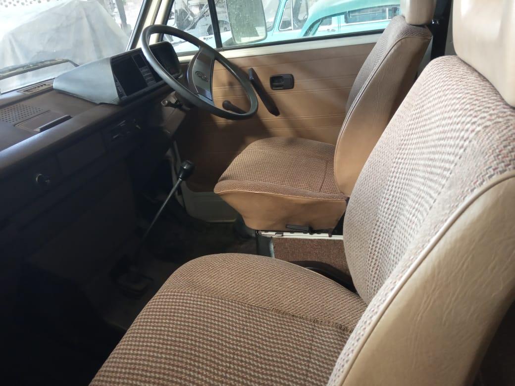

A friend here in India just picked up a VW Syncro T3. These were never officially sold here and were typically private, consular, or govt imports.
The seller had 2 Typ 3s. One was this syncro and the other a camper (without its TD engine).
We're trying to decipher some inconsistencies and need help on this.
The Syncro is RHD with a DJ code engine.
As I looked up the info, somethings did not seem to fit together well. The manf plate and m-code sticker are both there.

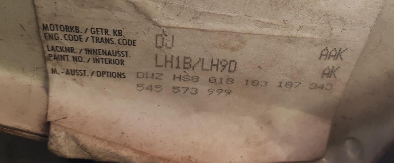

M-code sticker:
ENGINE CODE/Trans Code: DJ AAK
PAINT NO/INTERIOR: LH1B/LH9D AK
M-options: DWZ HS8 018 183 187 343 545 573 999
THe paint (Bamboo yellow lower, white on top) and other options seem to match.
I did not get info on DWZ and HS8.
So, what's going on here? Is the manf ID consistent with a Syncro?
If it is consistent with a Syncro, then the remaining inconsistencies would be: (1) the TYP showing as 253 which is listed in all the lists as a LHD while this is clearly a RHD. My friend believes he has seen instances of UK RHD Syncros with 253 as typ.
(2) typ 253-299 --> the engine seems to point to a 1.6L TD while the Mcode shows a DJ engine. Is it possible that in this case the 299 just refers to M299 (syncro option)?
(3) the DJ engine has a carb and looks factory. My friend was expecting DJs to be FI only.
Thanks!

PostPosted: Tue Jul 16, 2019 11:00 am    Post subject: Re: Help deciphering a Syncro Reply with quote
ZZZ is a european vin code

The 253-299 is the number for the chassis variant.
253 = window van with up to 9 seats
-299 = add on for Syncro
It doesn’t tell anything about Engine or RHD/LHD. Same with theChassis number, this won’t tell you anything too apart if identifying the car. The multiple Z’s in the European VIN numbers are used as spacer!
The sticker under the dashboard is relevant for engine code, gearbox, paint code and add on’s (M-Codes).
M-Codes List:
http://vwt3.com/t3-tech/t3-data/vw-t3-m-codes-options-list/
Cheers Arne

Any ideas on the DWZ and HS8 codes?
And, were the 2.1l DJ engines also offered with carb option?

PostPosted: Wed Jul 17, 2019 3:58 am    Post subject: Re: Help deciphering a Syncro Reply with quote
Don’t know what the other two codes are, could have been something internal.
The DJ was always EFI via Digijet.
Cheers Arne

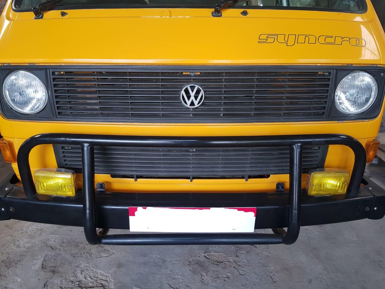

PostPosted: Wed Jul 17, 2019 8:09 pm    Post subject: Re: Help deciphering a Syncro Reply with quote
MY friend with his new syncro...

bnam

On the m-code sticker, the AAK apparently refers to open differential. Any ideas on what the AK in the second line stands for?

kamzcab86
Joined: July 26, 2008
Posts: 8471
Location: Arizona
kamzcab86 is offline
PostPosted: Wed Jul 17, 2019 9:31 pm    Post subject: Re: Help deciphering a Syncro Reply with quote
Upholstery code.
And, nice-looking two-tone Syncro! Cool

SyncroButter
Joined: February 02, 2016
Posts: 401
Location: Seattle
SyncroButter is offline
PostPosted: Thu Jul 18, 2019 9:16 am    Post subject: Re: Help deciphering a Syncro Reply with quote
Exceptionally clean Syncro, never seen a two tone before... clean looking carb conversion as well. Neat!
If he owns that why isn't he smiling from ear to ear? Laughing
