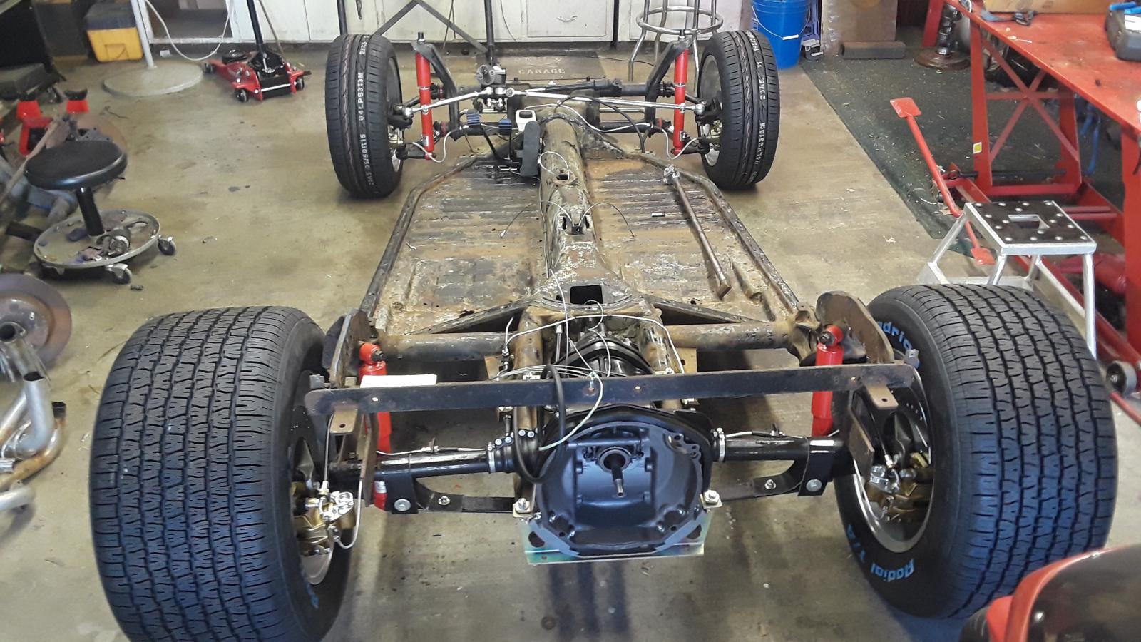

PostPosted: Wed Jun 26, 2024 6:40 am    Post subject: Re: Front brakes, discs or drums? Reply with quote
To this old knuckle dragger... It's a "no-brainer".
I have disc brakes front and rear. Better performance and less complicated and less moving parts. Easy Peasey! Thumbs Up

PostPosted: Wed Jun 26, 2024 6:52 am    Post subject: Re: Front brakes, discs or drums? Reply with quote
100% agree. To me it's like the difference between bias ply and radial. Drums can be a real pain-- I did a disc conversion couple years ago and have never regretted it.
