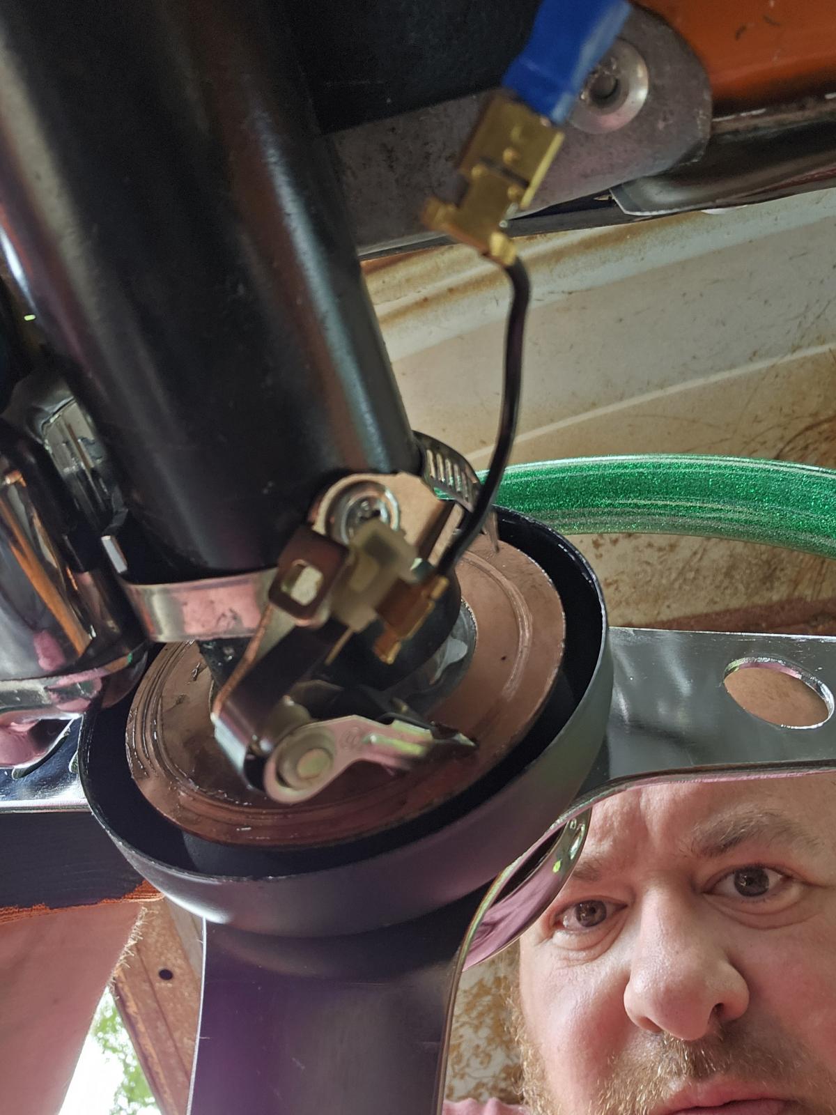

PostPosted: Sun Jun 09, 2024 10:51 am    Post subject: Reply with quote
Okay, did some playing and came up with my "fix" for the horn.
I get it that most steering wheel columns are hollow, mine is not. part of the "extending" my chassis was extending the column and to do so I used a large section of bar stock. so no go on the hollow column to shove wire through. I was looking around at the things I had available bc i wanted to use the center horn button on the new steering wheel.
looking at the adapter it has a "ring" that is suppose to ride against part of the original steering column, which i do not have, and looking into what i could do to adapt that to work on my ride I decided to try to do something.
I modified a old set of points from a distributor I had laying around in my parts bin. cut one leg off of it to allow it to spring open further and positioned it to the underside of the column as shown in picture.
The points slide on some dielectric grease on the rear portion of the grant adapter. hooked it to the ground terminal of the horn and now when you push the button the circuit is completed by the points and the horn beeps....
i know this isnt the way to properly do it but its what I came up with out of the parts and debris I have left over in my garage. It works, its a rat rod, I like it and am strangely proud of this rigging of parts to fit a need, odd or not. lol.
