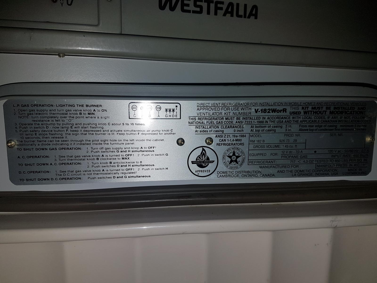

Hi all
Trying to start the Dometic fridge on LP. This thing hasn't been used in a while apparently.
When I select the Gas mode on the switches to the right, the manual says that the red light above should start blinking (sign that the piezo is sending sparks).
Nothing, no blink, no light, no spark that I can hear.
What I've done so far: I checked the fuses on the B-pillar, they're good. Only the right one has +12V, the other one has 0.
The fridge works on 110V and on 12V.
Any thoughts ?

PostPosted: Sun Jun 03, 2018 6:14 pm    Post subject: Re: Dometic Fridge - no red light = no piezo/spark? Reply with quote
Mine is somewhat different as it is an 84... but it looks to me like you have the gas turned off.
For starting I think the dial with OFF and ON should be turned to ON.
Also the dial that turns from MIN to Max should be on MAX.
I will also mention since you are new to this - the valve on the propane tank also needs to be open.

PostPosted: Sun Jun 03, 2018 7:13 pm    Post subject: Re: Dometic Fridge - no red light = no piezo/spark? Reply with quote
davevickery wrote:
If it lit instantly, then you wouldn't see it sparking. The sparking stops as soon as it is lit. That seems to me the most likely option without looking at it in person. The plug under the sink could be loose or unplugged, but it wouldn't work on 12 volts if so. So maybe not that. The igniter part behind that 3 button selector could go bad or the sparker wire could have come out of it. Those electronic sparker do go bad sometimes, but not too common. Mine seems to not work occasionally, I think from condensation possibly. When I try it later it seems to work fine. (I added a manual piezo as a backup). You could double check at the plug under the sink to make sure you have 12Volts there. Taking the fridge out is a hassle, so start with anything you can do with it in place.
Unfortunately, odds are it isn't sparking instantly... It just never blinks.
I've checked the connector below the sink, I have +12V between brown wire and blue wire.
I took the picture after I has turned everything back to OFF, nice catch Razz
Given that the red light should blink before the as is actually ignited, I don't think it's a gas issue, but rather electrical.

PostPosted: Sun Jun 03, 2018 8:24 pm    Post subject: Re: Dometic Fridge - no red light = no piezo/spark? Reply with quote
For these ultra-late model electronic Dometics, I can attest that the light flashes with the gas knob off, with the tank regulator off, and both on but with the tank empty/clogged regulator.
So, something is amiss with Vic's fridge; it may have to be pulled to test/repair the igniter/wiring/connections, especially if you don't hear the piezo going <click, click, click> in a quiet environment, or with your ear near the flue.

To clarify, to start, (A) is on, dial (B) that turns from Min to Max should be on Min. Once the light (E) goes out, which tells you the gas has been lit, you then turn the dial (B) to Max while holding in the igniter button (F).

All I have to do now is get the propane to ignite. I guees I'm back at all the existing topics on how to light the thing up.
I'm glad I don't have to take it all apart now, a few days away from leaving. I'll keep you posted.
The one downside to those electronic sparkers is what you experienced. They seem to need regular exercise. Either it is internal to the electrical sparker box, or the connections get a little corroded or loose. When the light glows solid, that is supposed to be an indication of a ground issue, so it could just be gunk building up on the contacts.
The fridge should start a lot easier if you run it on 12V or 110 for 5-10 minutes before switching to LP. The electronic fridges don't need that as much as the manual spark versions, but it still helps to get fresh air moving into the burner box.
