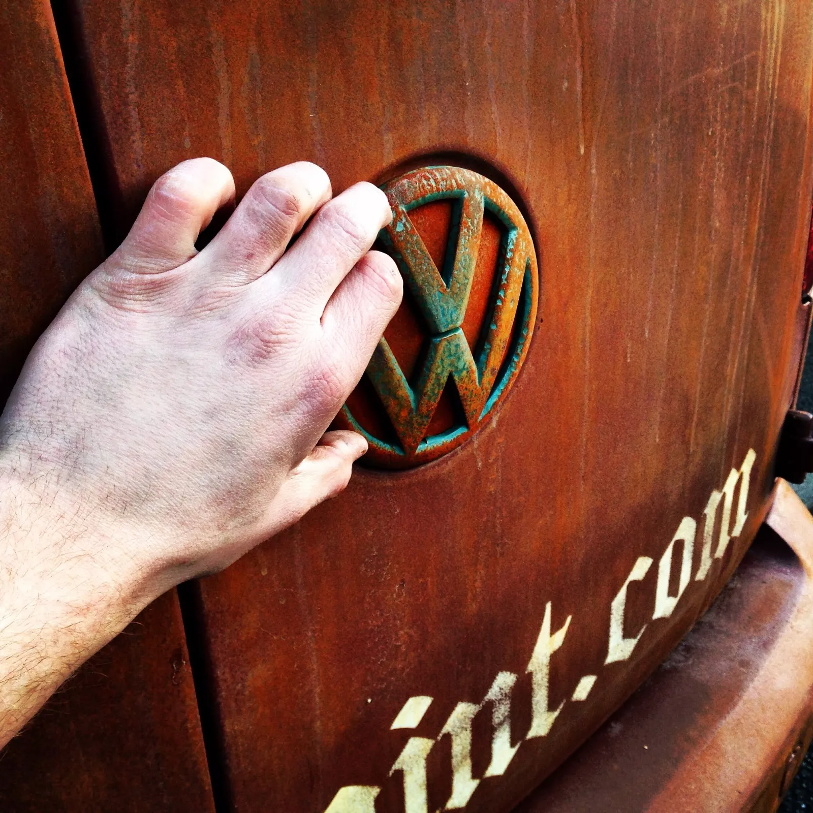

in the uk there's a paint called 'rustypaint' and there are other types of rust paint available - might be easier than swarf dust and salt water...
https://www.rustypaint.com/Instructions-FAQ.php
That’s cool, i will see what i can find on this side of the world
