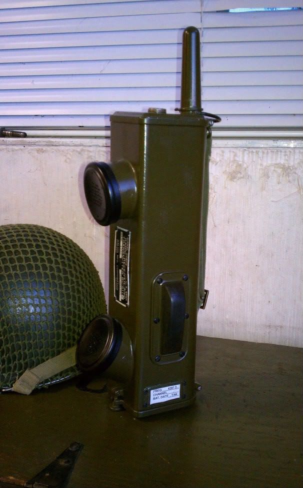

Well years ago I restored a WWII BC611, and was lucky enough to still be able to find the correct wrinkle finish paint in a rattle can.
Not the best pic below, but it is wrinkled.
Unfortunately the supplier that I got the paint from is long gone. From what I have read, they are now using black or grey wrinkle finish (readily available) and then once dried spraying flat od over that. Ive never tried it, but you might give it a try.
