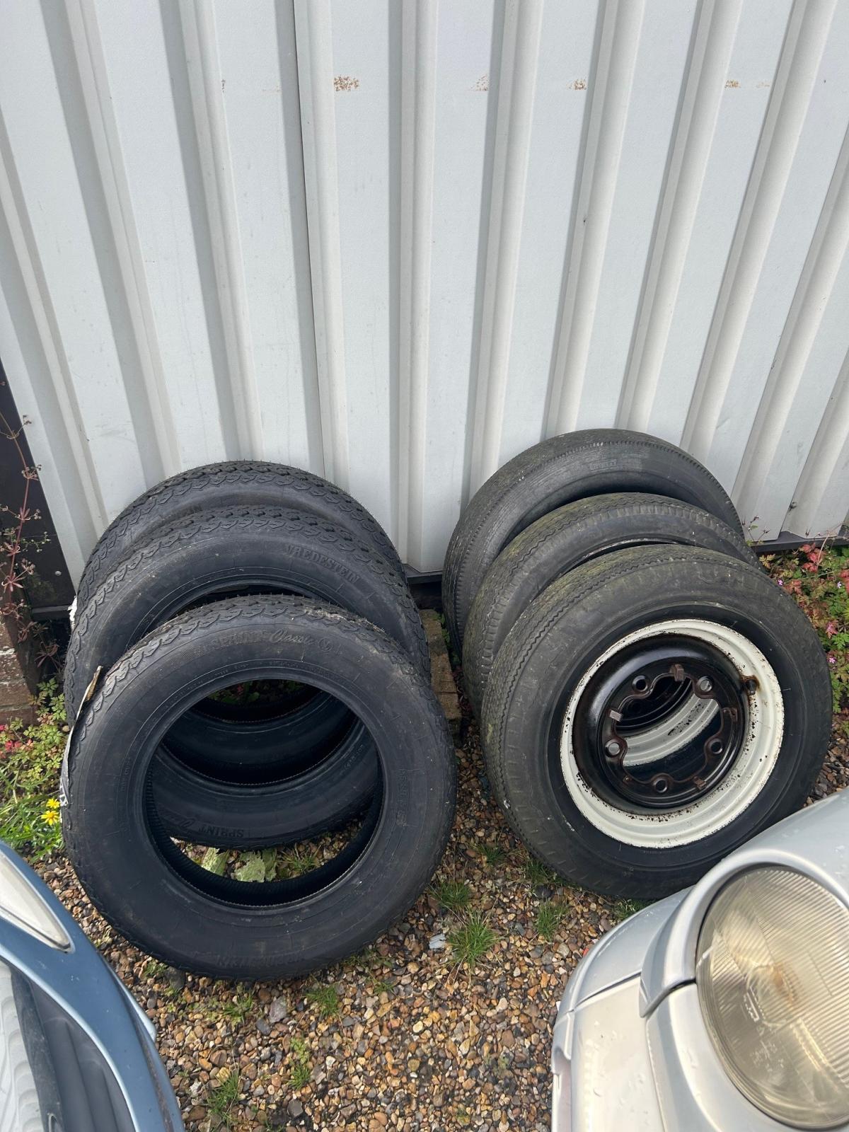

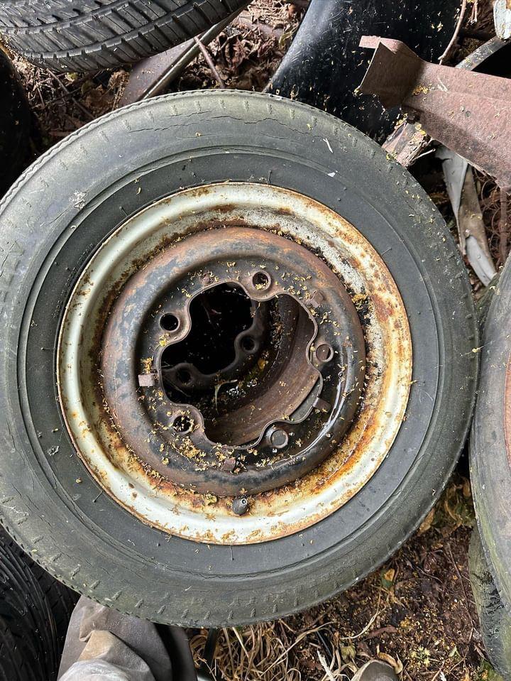

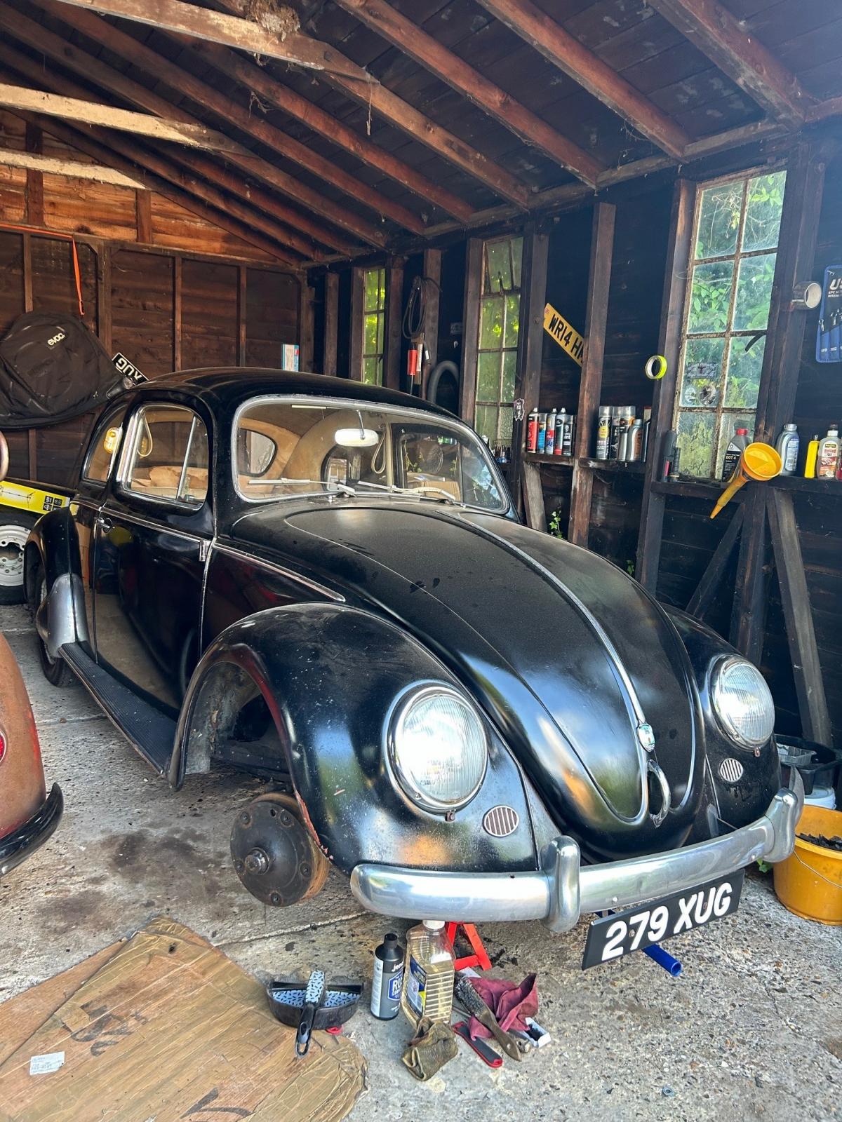

Hi All, this is my 1958 Swedish import i recently picked up in the midlands of the UK. I don't have too much history on the car just that it was brought into the UK around 2006 and was on the road and sold to the previous owner in 2007, it then sat in his garage till last month when i purchased it.
Here are some photos of me picking it up. I know it hasn't really been touched or altered too much. Which is really good for originality. It was a bit of a shame that it didn't have the original bonnet but it did come with the right 4 tab one. I have one original wheel but still looking for a full set. Thinking it would be great to see it back to stock for a while.

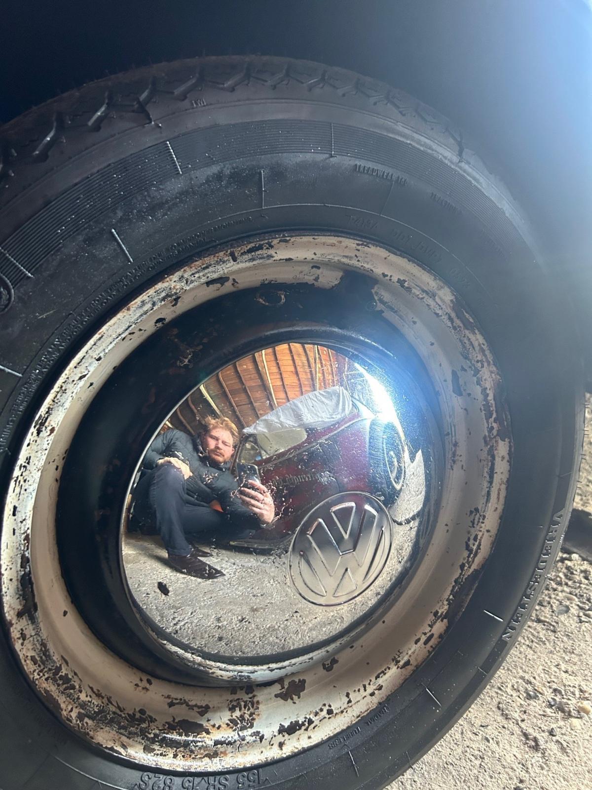

Theses are also a couple of photos after cleaning the car, I still have the original front carpet and panels so once I tidy up some areas of rust I will look at putting them back on.
I have a few more updates on the car and will put that in my next post.

After a couple weeks I wanted to get it ready to go to my local village show, It didn't need to go far just a mile in total. I managed to source a set of 4 60s patina wheels and new tire's 155/SR15 82s (Sprint Classics) as they were relatively cheap. I cleaned up the wheels with scotch pads and some fine steel wool then placed a clear over the front and backs.
I needed to clean out the tank, place a filter under the rear and rebuild the carburetor. There was some rust in the tank that i was able to shake out and clean. To be expected the carb was full of junk. Here is the engine after.

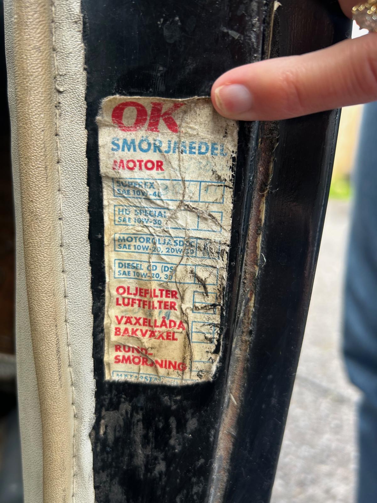

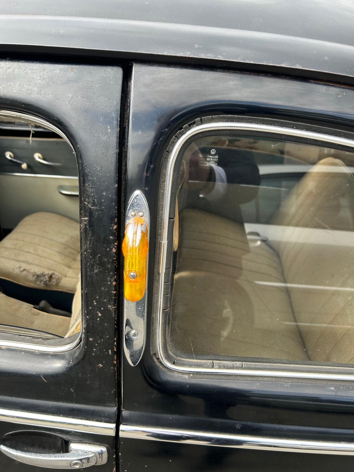

I also found a service sticker and thought it was a cool thing to see still on the door frame.
My local VW aircooled parts place sells the old classic number plate style that I like. I knew that it was going to be the first thing i would change.
So after not being on the road since 2007. Here is the beetle at the local village car show.

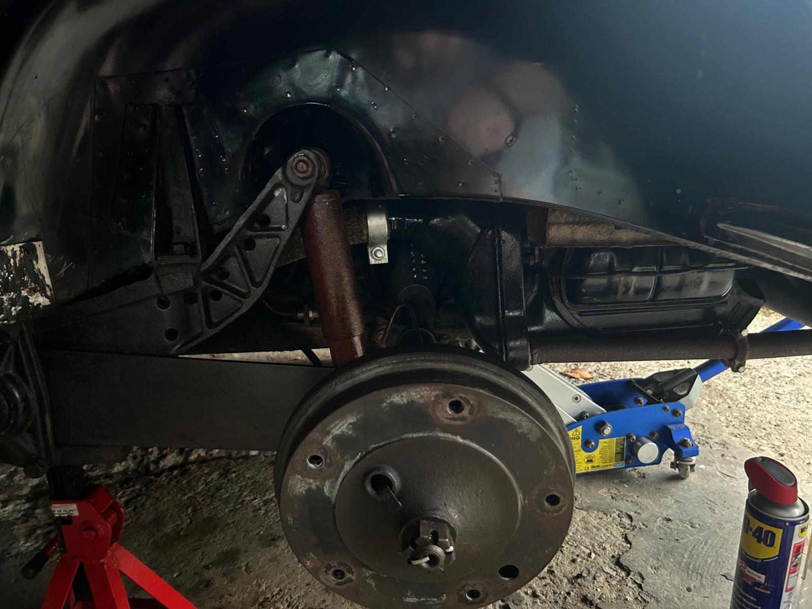

I haven't managed to take the beetle for a drive this week as I have been busy removing the under coating. I think it looks much better and gives me an idea of what needs attention. For the last 2 evenings I have been using a heat gun and some white spirit to remove the old underseal. It has preserved the original paint quiet well but where it begins to crack it tends to hold water and start to rust on the surface. It is a long and slow process and i will look to buy some better scrapers to speed it up a little. They have put a thick coating on and it is not dry meaning it wont flake off in chunks.
I have only managed to do about 70% of one arch and fender so it is going to take a long time but very rewarding. I will then rust convert the areas needed and seal it off.

One wheel arch pretty much done there is a bit more to go on the inside of the fender but that can wait.
Next up is the front.

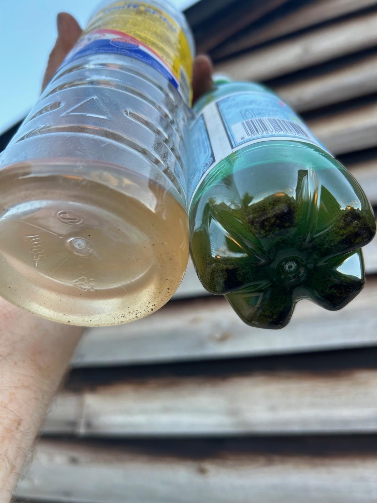

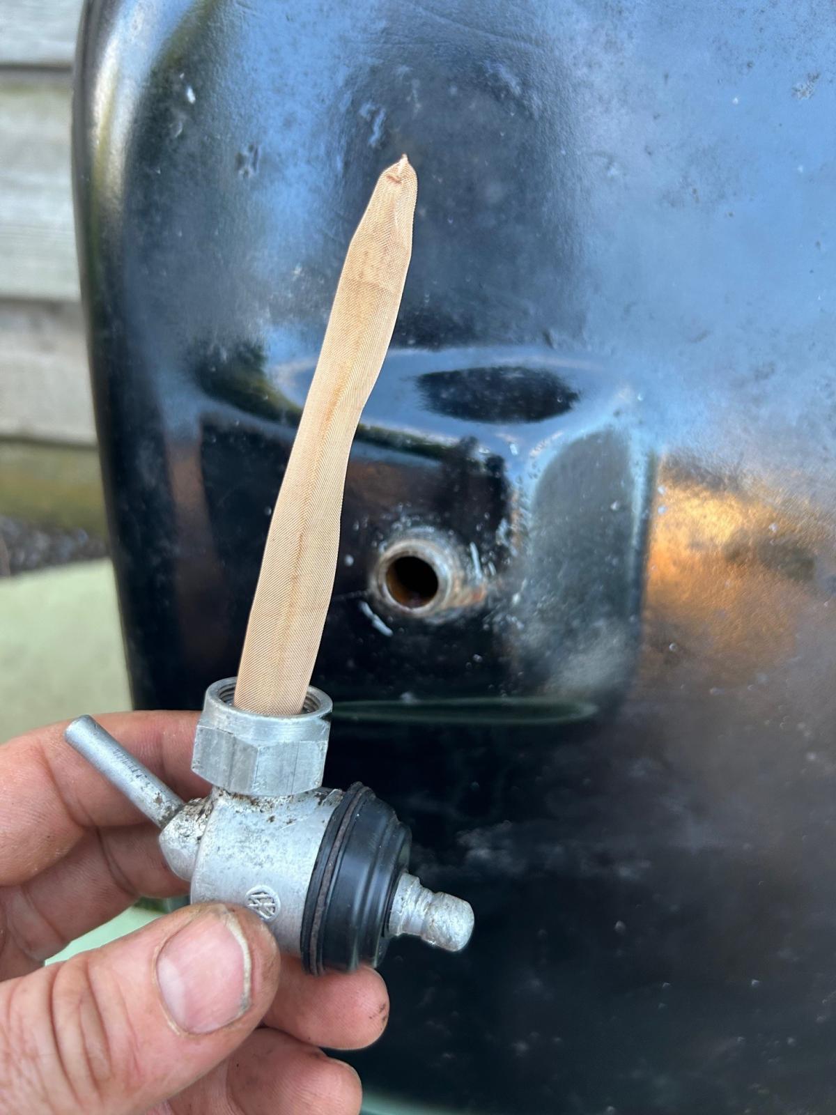

Its been a while since posting an update, This evening i decided to tackle the fuel system and issues that i had been experiencing. Thanks for all the comments. I ordered a new fuel filter & tank screen. I had only just put about 15L of fuel in the tank so it was a bit of a bugger to move around. I had previously been in the tank to clean out the rust so I was used to the process.
I replaced the screen ( I just assumed it made a seal with the lower part of the fuel tap & it did) no leaks in the end.
This is what came out of my fuel line whilst flushing. it cleared up a lot after 3 to 4 flushes so i changed bottles to confirm. I used a bit of curtain bungee to push down the line and clear any debris that may have been caught.
Started the car after putting on a new fuel line filter. No issues running. I am yet to take it on a long drive but will do that in the coming days to confirm no more issues. Also i had cleaned out the hard lines in the engine bay to make sure that wasn't an issues.

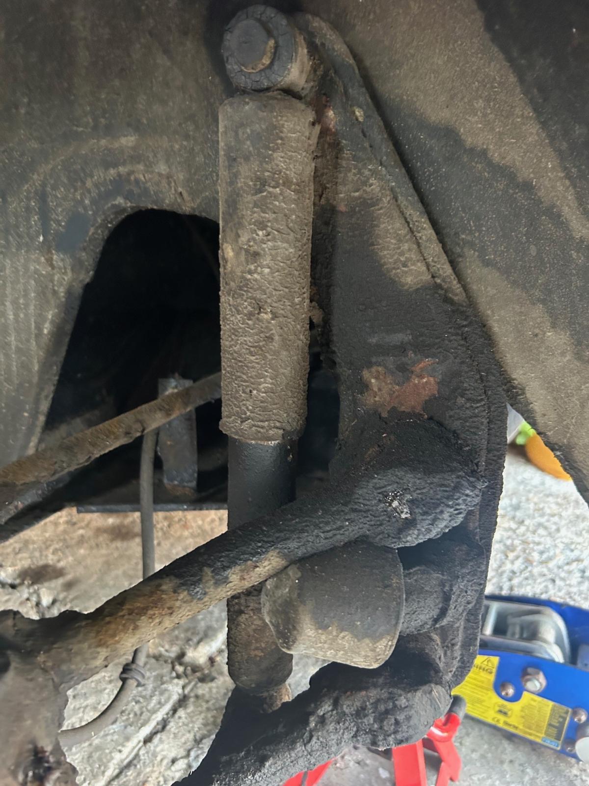

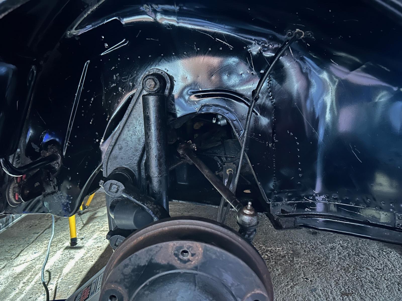

I have also been working on removing the underseal in the drivers side wheel arch. Here is the results. Once i removed the the under seal I have been converting the areas that have surface rust and been effected by water getting through the cracks. It seems to be a problem more around the arches where dirt has built up. I also accidently cut through the front bucket drain plugs but managed to order some online and put new ones in. Always good to pull the headlight and clean behind. I have also replace the bump stop as it was completely rotten away.
Cool to see all the original spot welds. I will continue to update the progress.

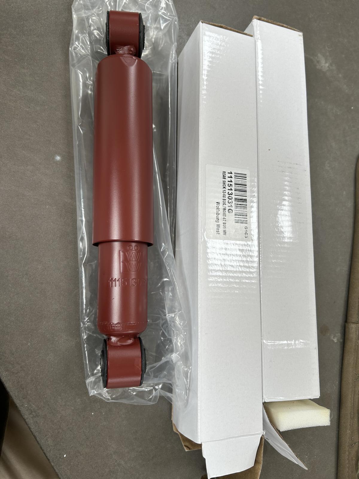

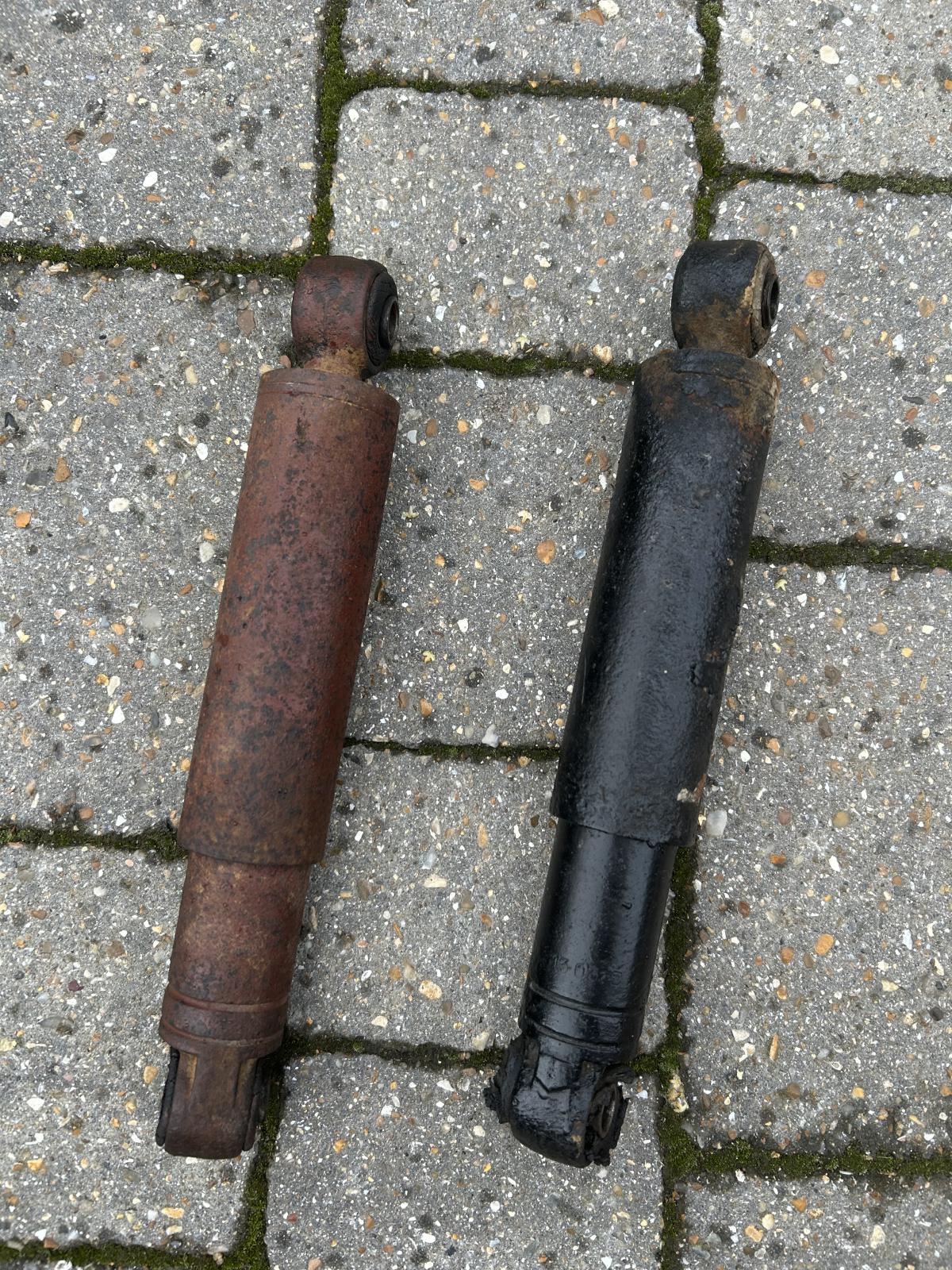

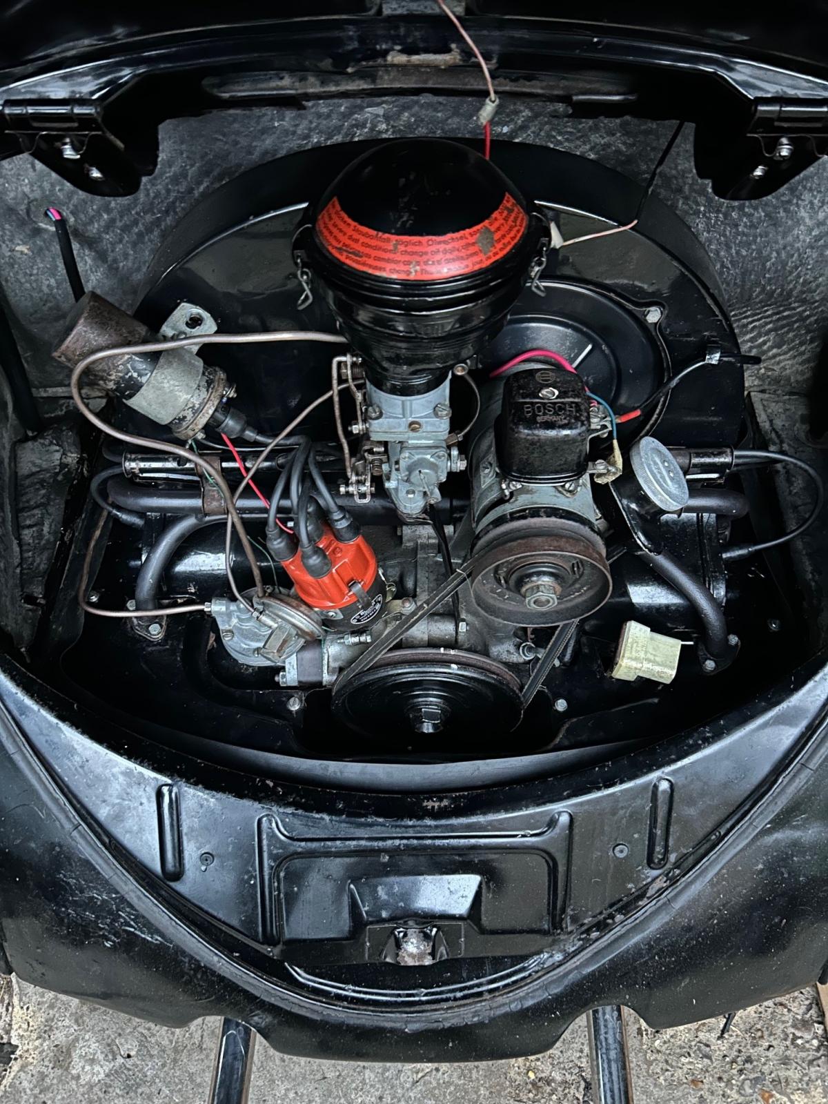

Here is some photos of the weekends activities. First is the engine seal replacement, I definitely noticed the difference in the engine bay temperature after the drive. Bit of a pain to replace with the engine in but i just needed to remove the front tin and work it around. The previous seal was nearly non existent and super dry.
I polished up the hubcaps that have a bit of patina using Autosol metal polish.
Before:
After:
Also cleaned up the original stainless gravel guards.
One side of the beam was previously cleaned so I have been working on getting it ready for painting. I have also been slowly working on getting the underseal off to match the other side.
Before Cleaning
During & After Cleaning
I have since painted the beam end, king pin spindle and replaced the bump stop. I am also still progressing slowly with he underseal removal.
