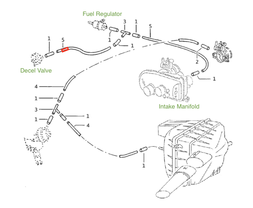

I am in the process of cleaning all my vacuum lines, and when I tested them by blowing through them, I realized that one of them was totally blocked. (These are the vacuum lines that go from the decel valve, to both the intake manifold and fuel return valve on my 1978 Type 4 FI bus)
When I pushed in a fat piece of wire from the other side (and applied some pressure), suddenly this metal piece popped out. (the red box shows where it sat)
Based on the force it took to get it out, this was definately 'put' here by a PO. This is on the thin vacuum line that goes to the decel valve (the plug was close to the decel valve) (it was located at the 'red box' as shown in the image below)
Here is a pic from the microfiche showing the location:
So my questions are:
- I assume this is not stock from the factory, so why was this done? Does this 'disable' the decel valve entirely?
- Should I put it back or leave it out?
- I have noticed that when I drove downhill and let off the gas (in gear) I get some pops and bangs - which I assume is related?
Any advice here would be much appreciated.

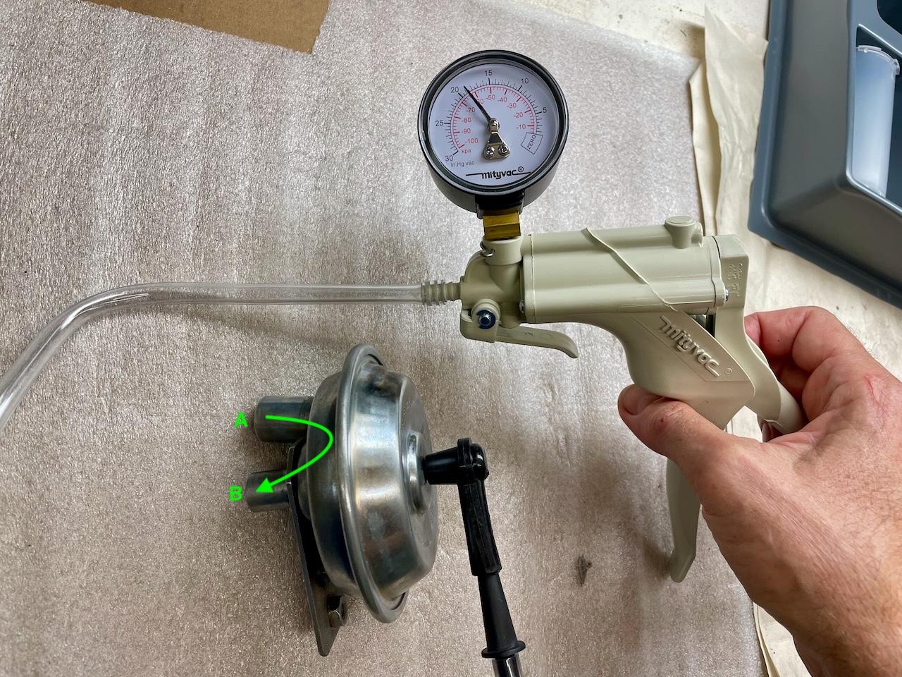

Thanks for all the responses. I uninstalled the valve, and first cleaned of 45 years worth of gunk before testing the decel valve:
18 in.Hg: I can now start to blow air from A -> B (or conversely suck air out B from A)
20 in.Hg: I can easily blow air from A->B, but also a bit from B->A
22 in.Hg: I can easily blow air from A->B, but fairly easily from B->A.
Is my assumption correct that this is pretty much in-line with how it should perform?
I am planning on reinstating the decel valve properly, especially if that means it will extend the life of my cat.

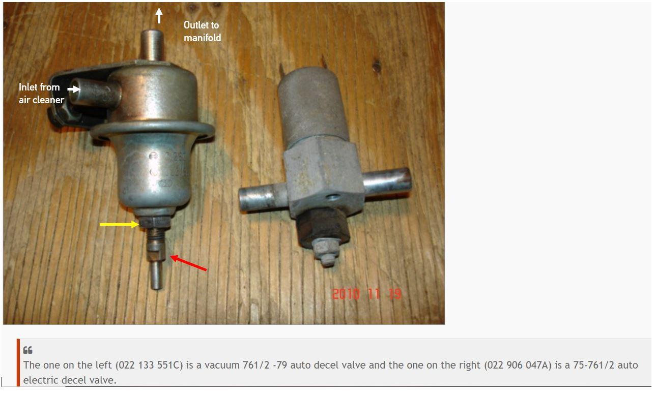

This is stolen from Itinerant aircooled...
The valve on the left is what is used in 411/412/914 with D-jet and a manual transmission. The one on the right is automatic ony in 411/412/914.
He lists that the one on the left is used for automatic in 1976.5 to 1979 buses? And the one on the right is automatic too? Does not sound right but OK.
Note that the yellow arrow points to the locknut and the red arrow points to the place on the vacuum nipple where you put the 8mm wrench to adjust the valve's sensitivity to whatever vacuum signature you have to open at a specific throttle closed rpm on deceleration.
Here is the parts book for 411/412. The top diagram is automatic transmission showing the deceleration valve, the vacuum switch and the relay. The one on the bottom is the manual transmission version disagram.
The difference is that on 411/412/914 and type 3 the part # for the deceleration valve is 311 133 551. From dim memory...I will have to check...I believe these valves are the same and have several part #'s on them... 022, 028 and 311 part # prefixes.
The reason(s) it is also important to have an ADJUSTABLE deceleration valve is that the compression of the engine, the state of wear of the engine, the ignition advance system, the camshaft used and especially...the gear ratio of the transmission and tire size, all make a BIG difference in what rpm and vacuum level you will be running with throttle closed on deceleration under any given circumstances.
The way the manual transmission deceleration valve is described to be adjusted in the 411/412/914 Haynes manual is to disconnect the inlet hose from the air cleaner, start the engine and rev to a specific rpm number with your finger over the inlet port.
