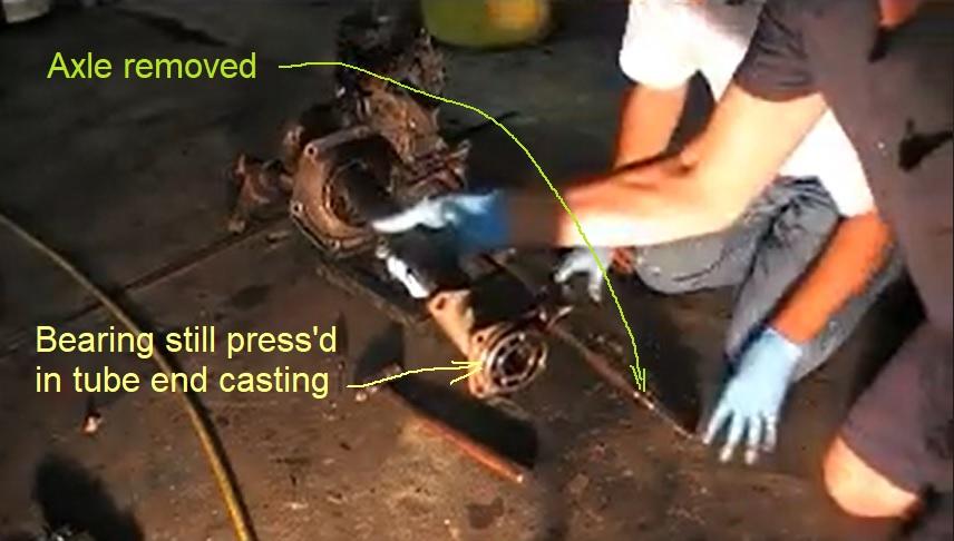

It looks to me that axle can be removed withOUT removing bearing from tube end casting:
Or, is there some other bearing I'm not seeing?

MrGoodtunes wrote:
It looks to me that axle can be removed withOUT removing bearing from tube end casting: Or, is there some other bearing I'm not seeing?
No, you've got it right...there's no other bearing to deal with. Removing the axles while the trans is still in the car is a bit trickier though. The frame horns get in the way of removing the axle tube retainers.
Being that the rear wheel bearing is press-fit onto the axle, a 3-jaw puller will help in removing the bearing housing/axle tube assembly, together with the bearing, from the axle before removing the axle shaft from the transmission.

I actually like that method shown in the video because it pulls concentrically on the axle tube retainer as it breaks it free from the side cover, thus no prying around the sides later on.

He never actually got the axle out during that video, he fought with the snap ring without success. I can’t imagine trying to do this while still in the car.

ppilotmike wrote:
He never actually got the axle out during that video, he fought with the snap ring without success ...
Yeah, that huge C-clip is daunting! Maybe they cut the video short there due to the language he may have used for venting frustration? He does have a continuation video which starts with the axle shaft already out loose.
