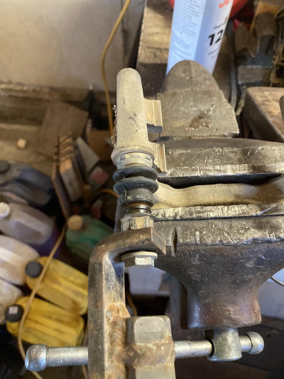

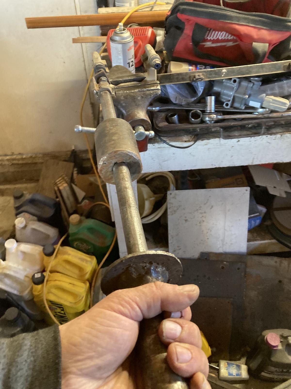

The right side is done and went as expected apart from the lower caliper mounting pin. It was seized in place and took about 3 hours to get it out. Ended up taking the caliper mounting bracket off, putting it in a vice and between penetrating oil, breaking it loose with a long swing handle and using a slide hammer alternately it finally came out.

No mucking about this time, penetrating oil, break it loose with a swing bar, then straight to the slide hammer!
It was not stuck near as bad as the last one.

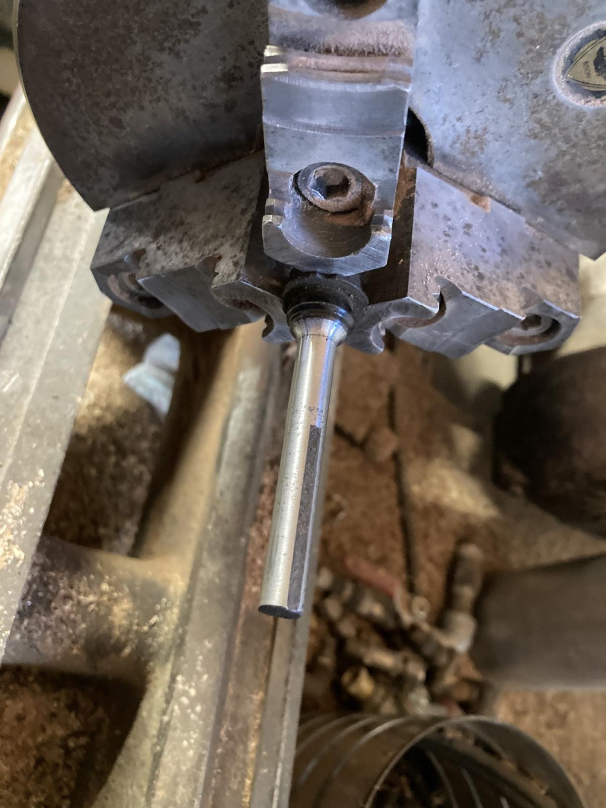

Shine up the pin.
Drill out the rust.
