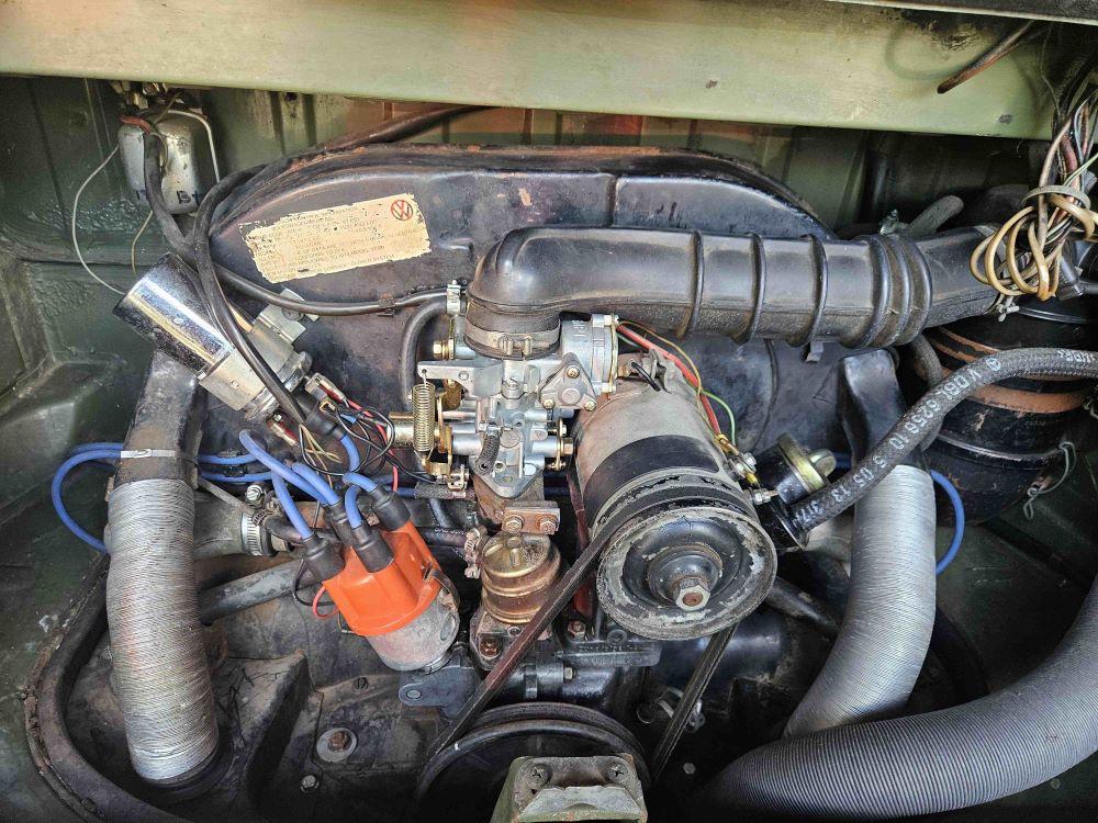

PostPosted: Fri Sep 06, 2024 3:40 pm    Post subject: Re: Engine issue has me stumped Reply with quote
First pic is with the 009. It was running beautifully at this point.
And this was yesterday after I installed the SVDA and got it running:
Pics just for info. The chrome coil is a Pertronix model. I normally avoid anything chrome, but that's how it is and it's supposed to be matched to the CDI.

So, this problem seems to be resolved at this point, but it was a long road to get here and I broke the 1st rule of troubleshooting - I changed more than 1 thing at a time. I'm posting this 'resolution' post just to maybe help people in the future with this problem.
I made a lot of assumptions based on the fact that since I purchased the Thing as a father son project in 2018, did a lot to it, including new fuel tank, lines, filter, etc. that that was all still good. It wasn't. Even though it had like 10 miles on it. So, to begin with, never assume.
Yes, the tank was 'new'; but in the years since I purchased it, sitting there with gas in it, it got really gunked up. It was stupid of me to believe otherwise. When we eventually got around to pulling and draining the tank (and the nasty fuel that was in it), and pulling the filter sock out of it, it was nasty. If you believe you might have a fuel delivery problem, pull the damn tank and ensure it's clean. It's got to be the easiest tank to pull on any vehicle ever made. I don't believe I had a fuel delivery issue, but I feel a lot better about the system now that we have thoroughly cleaned the tank, replaced the outlet elbow (old 'new' one leaked), new fuel lines (again), cleaned central line, and replaced the fuel filter (that had 10 miles on it).
Then I replaced the ignition coil with a new Petronix unit that measured the right resistance. At this point the problem was probably solved, however, when I tried to test drive it, it had no brakes. This is the reason the this 'resolution' post is soo late. I spent the last 2 months going down a brake issue rabbit hole. Ended up replacing reservoir (original was cracked), then the wheel cylinders, then flex lines, then the master cylinder, then the brake light switch. It was a mess. It was probably the leaky switch the whole time, but now we have a pretty much new brake system, which I guess is the bright spot.
So, the down side is I cannot definitively say it was the ignition coil that was 'the solution' in this case, but it probably was.
The up side is that we are now really confident of the:
1: fuel system (cleaned tank, new outlet elbow, new fuel lines and good hose clamps, thoroughly cleaned carb (including fuel pump on carb which I skipped cleaning prior to a suggestion in this thread)
2: brake system with new reservoir, MC, brake light switch (only replaced 1), flex lines, wheel cylinders, proper adjustment and brake bleed
3: ignition coil which is new and measures out correctly
And my son is now REALLY comfortable with bleeding brakes, adjusting brakes, adjusting axle nuts, bearings, setting timing, etc. All the things I had hoped to get him used to in 2018 when we first started working on this father son project. It's 6 years later than I had hoped, but he's really taken ownership, and that makes it all worth it.
Moral of the story, I guess, is don't give up if you find yourself in a similar situation. If the problems seem to multiply, keep working through them. And don't assume. Start at the beginning and work from there. You will find the solution. It's just a car, and a simple one at that. And when you eventually get the end it will be satisfying and you will both have learned things and be more confident in your skills when the next problem pops up.
Thanks again to all the helpful posters.
