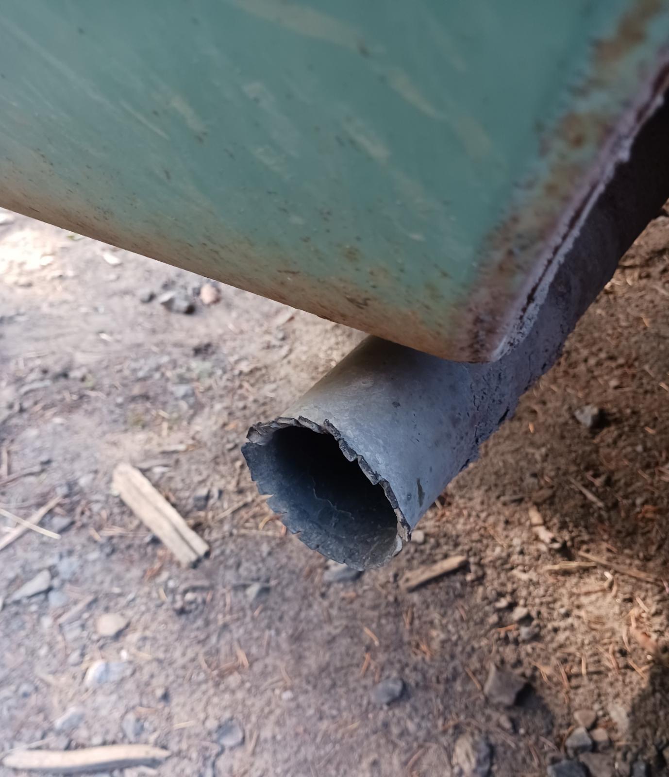

I have never tried this on a bus, but back during the 1940's and 1950's, some cars came with the tip of the tail pipe slightly collapsed, this would certainly change the tone of the exhaust if not knock the decibel level down a bit. It would be easy enough to remove the bus tailpipe and use a dull chisel to collapse the end of the pipe by 30% or so. You would want to collapse the inside of the curve, leaving the outside of the curve where the velocities are going to be the fastest nice and smooth. If you do this get back to us to let us know how it works.

Saw this a few days ago, wonder if there is much difference in the sound.
