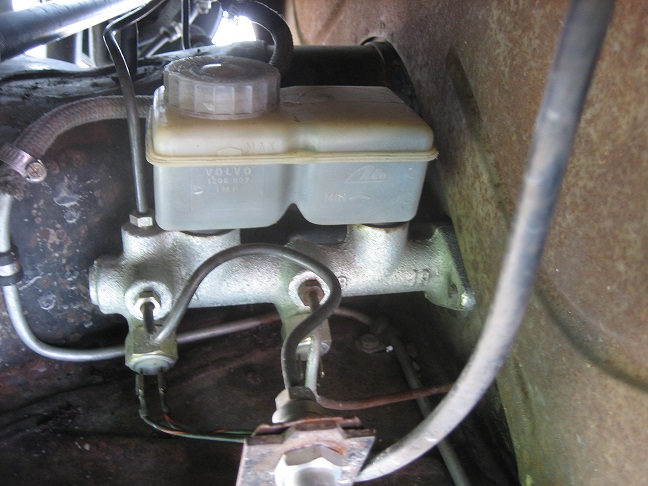

As for as the reservoir, i went this route on my 56. Kept the original reservoir in place just to keep it stock looking.
Not my car,pic found in the gallery.
Contact Russ at Old Speed, I'm sure he has everything you need. Rear disc also.
