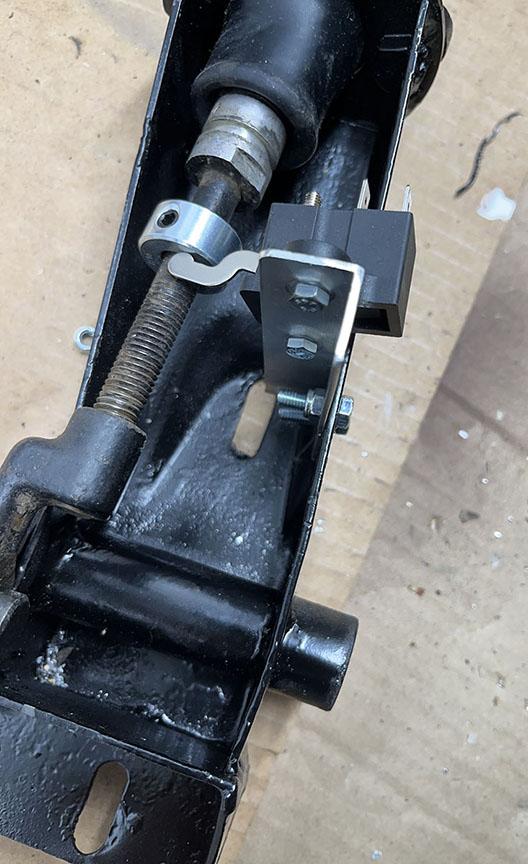

Just thought I would throw up some pictures showing my installation of a 911 brake light switch on my '56 Speedster. The switch will be wired in tandem with the hydraulic switch, but it will turn the brake lights on when the pedal is moved 1/2 an inch. I can activate the brake lights without activating the brakes by tapping on the pedal - gives inattentive drivers more notice that I will be stopping.
I worry about being rear ended in this car with those tiny lights in the back. I'm putting a 3rd brake light on the engine grille too.
