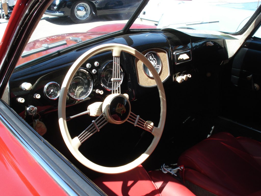

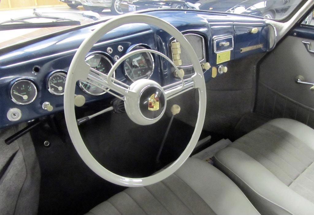

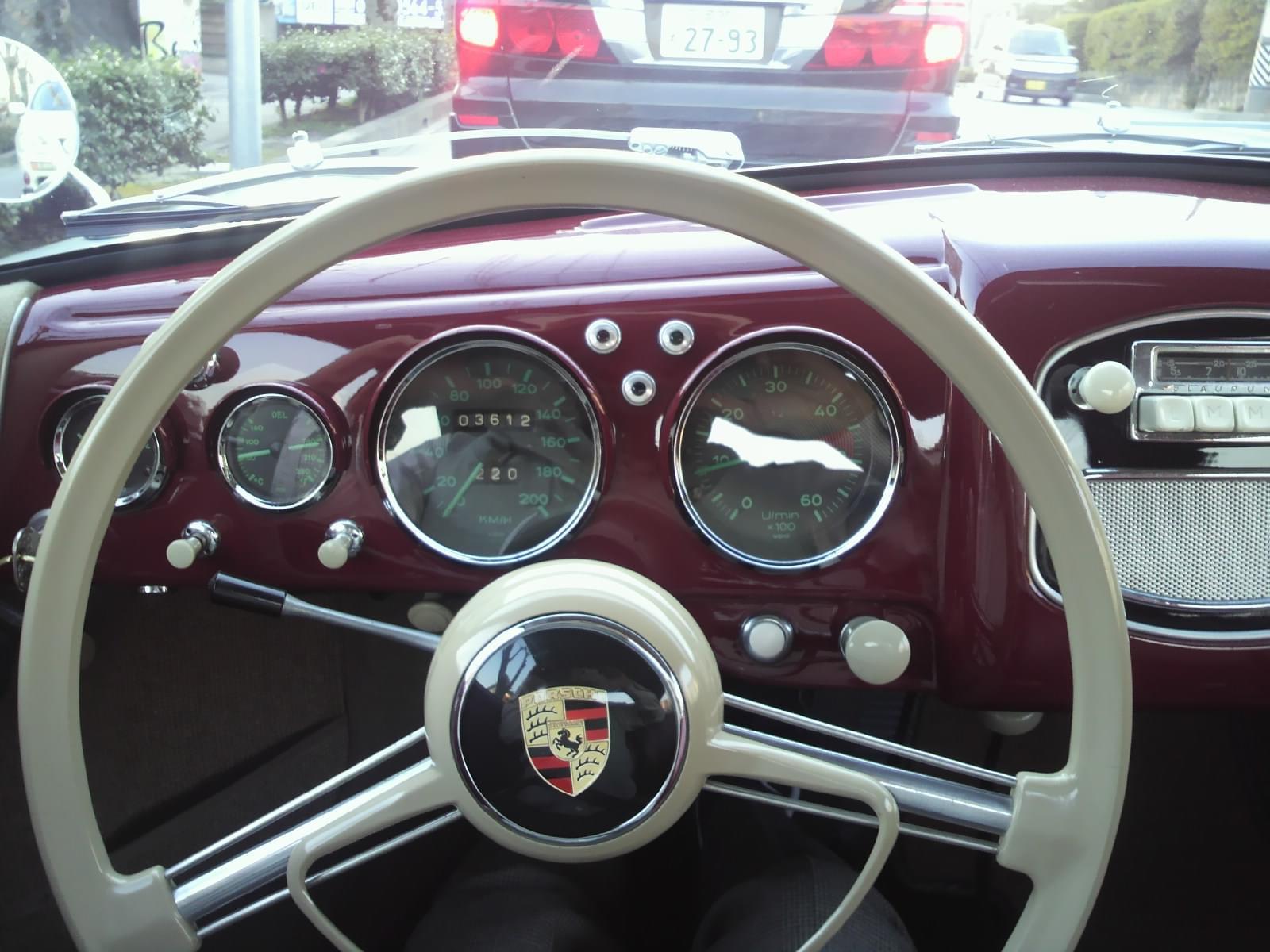

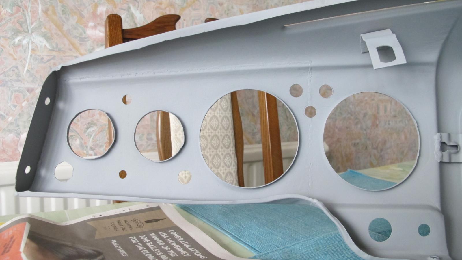

I thought this could be a Picture Thread for the 1950-55 Pre-A dashes.
Art Deco
The Porsche Pre-A dash in particular has a real Art Deco feel - the overall dash shape, the pod plinth and the glovebox details.
It is more cluttered than the Split Beetle or Barndoor.
Detail
I’m particularly interested in:
1. The little details that help you date the dash & therefore maybe the car*
2. What radios were original fitment back in the day (the Telefunken ID52 seems to be installed most often today)
3. The steering wheels & their original colour (I prefer the second generation wheel, the VDM 2-spoke)

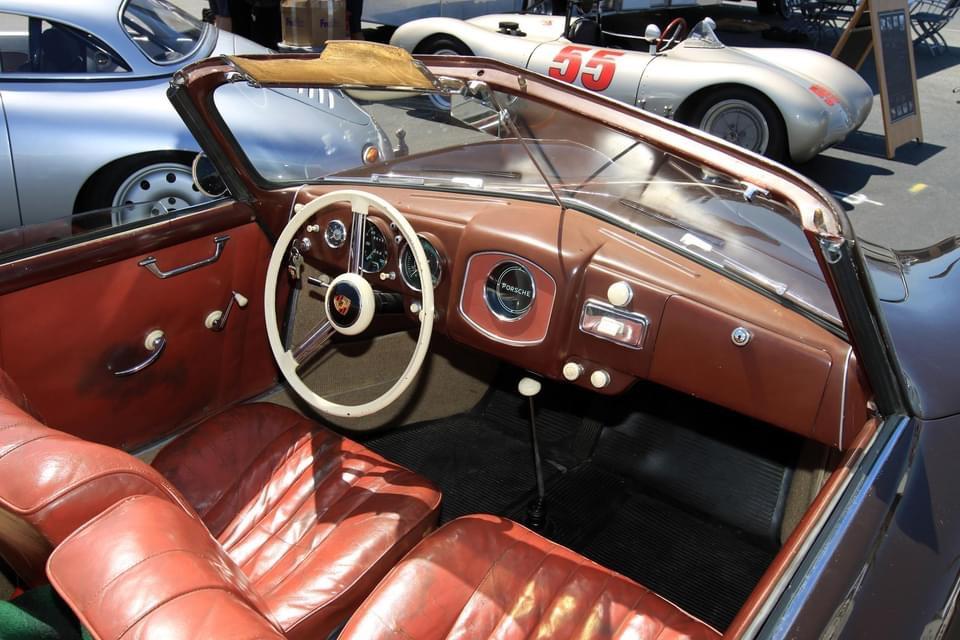

Who can resist looking at a Pre-A dash?

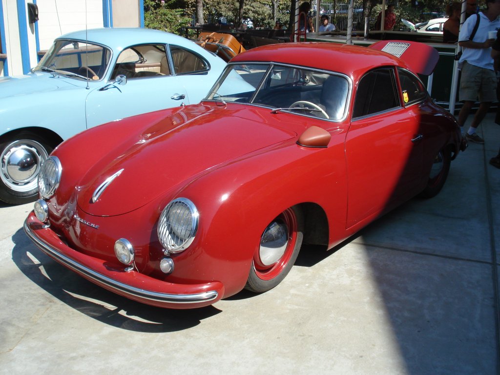

Approximately 9400 Pre-As were made
Up to a third are thought to have survived…so around 3000 cars

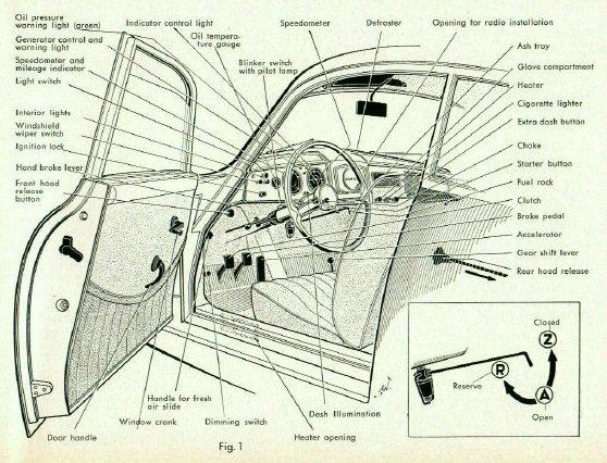

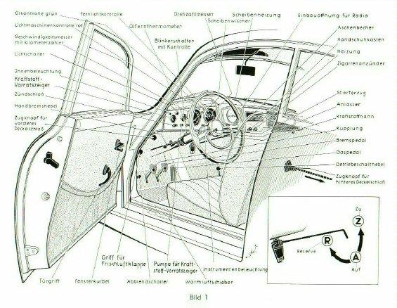

Dash Diagrams
From the Owner’s Manuals. All show the early offset door handles…
1950: Early wheel, 2-piece screen
December 1952 to February 1954: Late wheel
June 54 (German): Fuel gauge, far left:

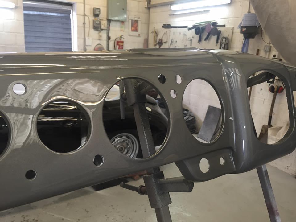

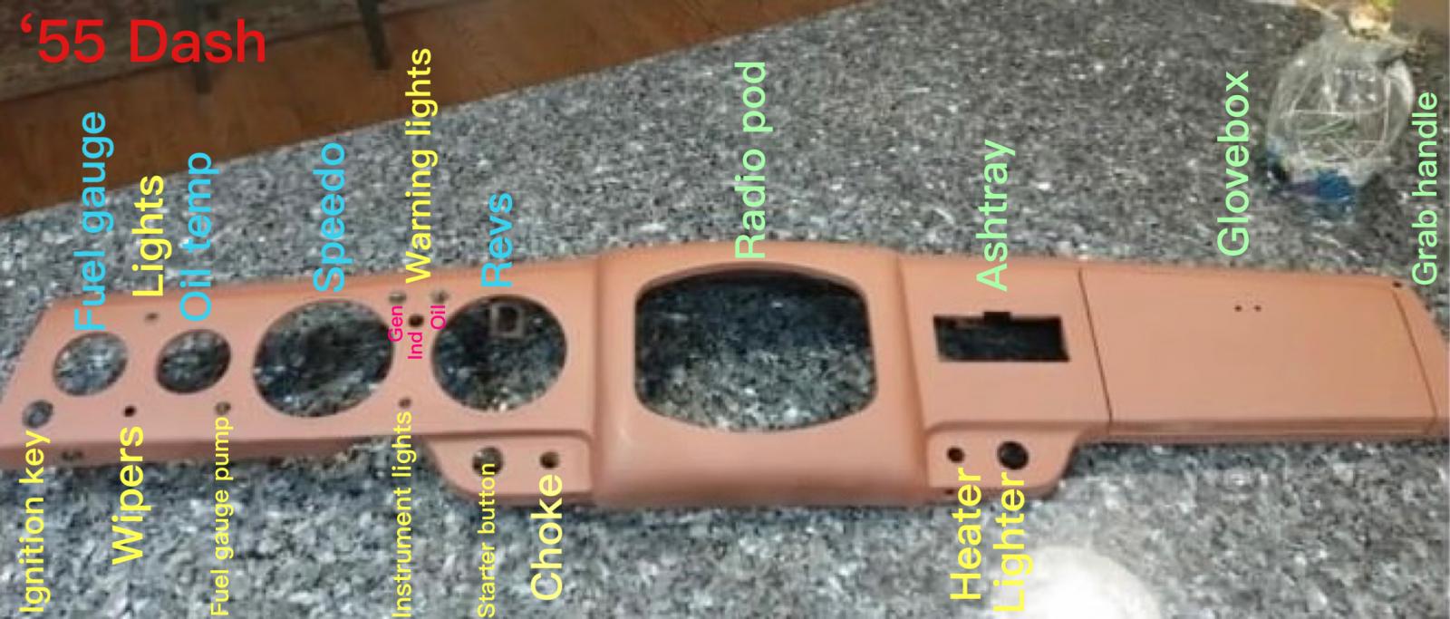

Dash Functions
The fuel gauge hole and the grab handle hole are the main ‘55 clues…
The heater pull hole was deleted Jan/Feb 55.

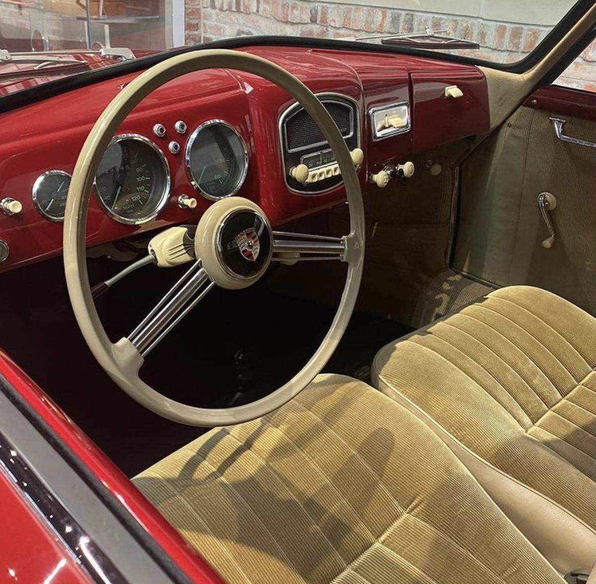

Year by Year Summary
Treat dates as approximate.
The steering column was Black throughout the Pre-A period.

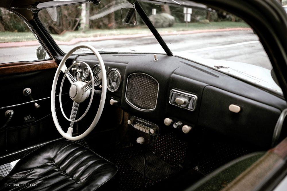

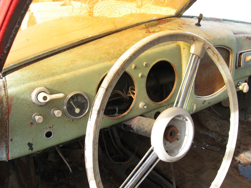

1950 Dash
>2-piece screen (Split Window)
>Offset interior door handles
>Opposing wipers
>Wooden doortops (beech)
>No door panel pull handles
>VDM 3-spoke wheel (all Ivory)
>Veigel gauges
>2-gauge dash (speedo, clock)
>No oil temp gauge
>No fuel gauge
>Waterfall ashtray & glovebox handles
>Metal glovebox (on LHD dashes until 52, and through 55 on RHD dashes)
>Forward dashtop indicator switch
>Large door pocket (to forward corner)
>Straight, short gearstick (used on crashbox)

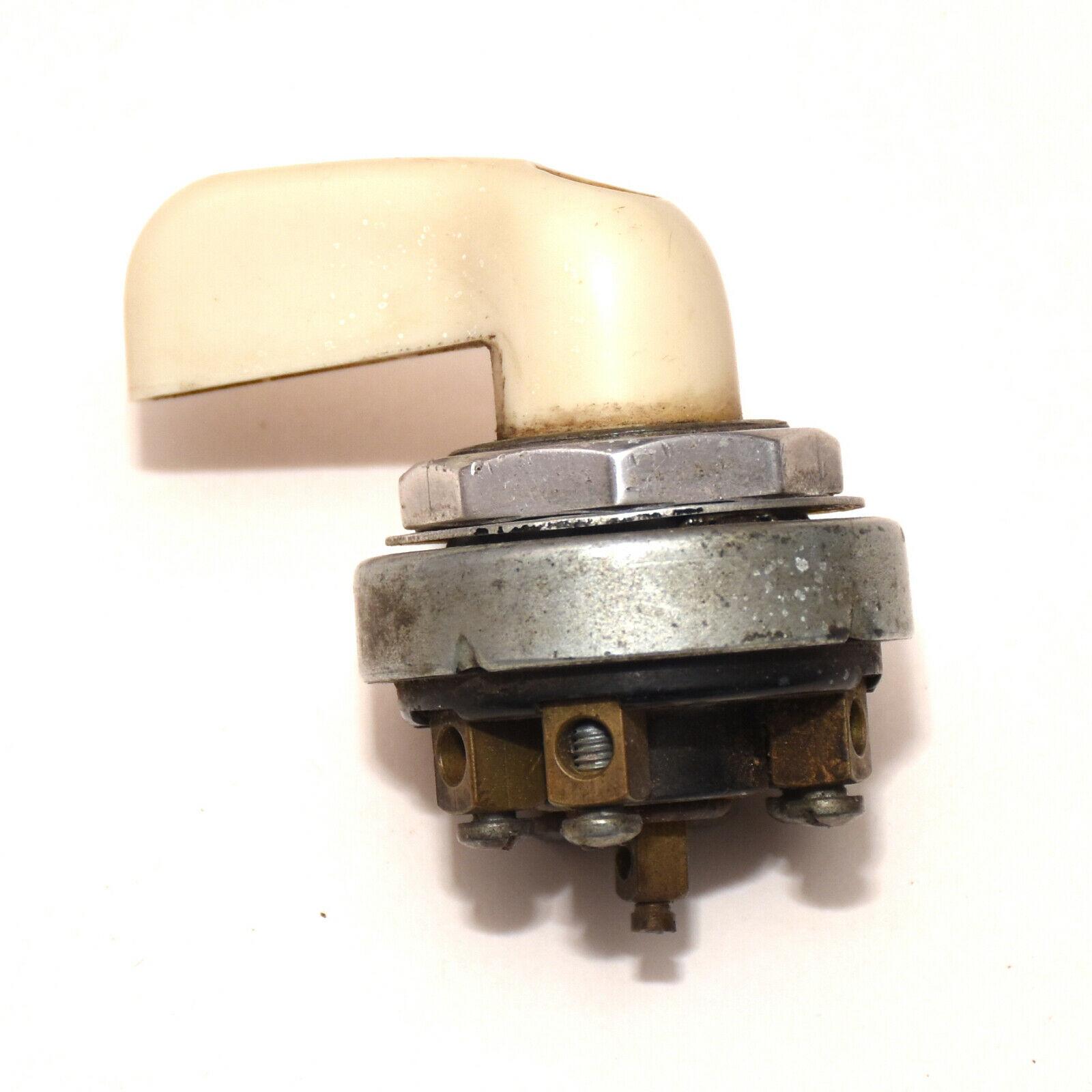

>Lever lights switch - into mid-51 - initially in a row of 3 (with wiper switch & interior light switch) but then with light switch above when oil temp gauge added
>Black push button start (to April 52)
>All other switches are Ivory (to April 54)
>The very early cars - 4-digit VIN - had a clock & not a tacho (into early 51)
>Centre pod blanking plate held a circular Porsche dummy gauge (to May 54)
Body clue: body-bumpers, inset front indicators, low rear arches, rectangular brakelights

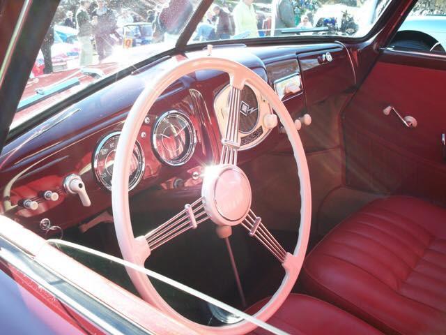

1951 Dash
>2-piece screen
>Opposing wipers
>Wooden doortops
>Veigel gauges
>Changed to a 3-gauge dash when the oil temp gauge (single needle) introduced in ?
>Clock replaced by a tacho (date ?) so from here on, no clock
>Tacho design mimics clock with continued use of the chrome ‘inner circle’
>Light switch now above wiper switch & interior light switch in a triangle formation
>No fuel gauge
>Metal glovebox until 52
>”Ashtray triple switch”…Heater pull, Lighter, Dummy switch

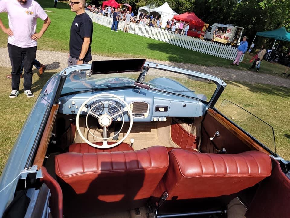

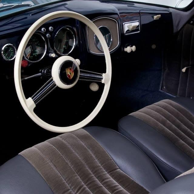

1953 Dash
1953 saw the introduction of revised interiors, and revised bodywork (bumper areas, higher rear arch, all 4 taillights now circular)
A handful of cars (100-150) retained the old light layout with the new ‘53 bodywork
>Indicator arm now Black (May 53)
>Single piece screen
>In-line door handles
>Opposing wipers
>Painted metal doortops
>Flat door panel pull handles
>VDM 2-spoke wheel
>Veigel gauges
>3-gauge dash
>Initially single-needle oil temp gauge tbc…changed to dual needle date tbc
>No fuel gauge
>Waterfall ashtray & glovebox handles (Reuter was known to install these inverted in 53 & 54)
>No door pocket tbc
>Carpet pockets, footwell
>Longer, cranked gearstick…positioned further forward (with new 519 gearbox, synchromesh…March 53?)
>”Ashtray double switch” from early ‘53 (the rhs 3rd button below the ashtray, the Extra Dash Button, was deleted between coupe ch.50523 & 50599)
>Map light above ashtray on Cabriolets
Body clue: In-line front indicators, beehive brakelights, higher rear arch, late short detached 53-59 bumpers
James Davies wrote:
‘53 Detail
Just about every knob and gauge (except for the Störk oil temp gauge) will be different on the '55 dash vs the late '53 dash. Here's a summary of knobs, gauges and doohickies for the '53 dash:
Bosch headlight switch with stepped knob
3x small pull switches for interior light, wipers and gauge lights
Bosch B-code key ignition switch
Stork oil temp gauge with 2-ended needle (same as '55, though different probe)
Veigel tach and speedo
3x dummy lights, same as '55
push button starter
"S" choke pull, knob similar to hood/trunk release pulls
"H" heater pull, below ashtray, knob similar to hood/trunk release pulls
Autofume cigar lighter, below ashtray
2x waterfall knobs, for ashtray and glovebox (for coupe)
All knobs are ivory

>June 54, VDM fuel gauge (hooded) added far left…so now twin small dials to left of speedo…’4-gauge dash’

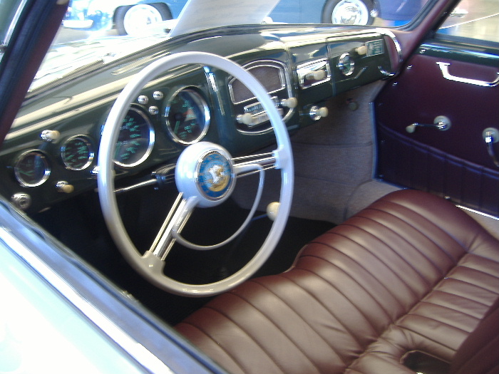

1955 Dash
Until Sept ‘55
>Single piece screen
>Parallel wipers
>VDM 2-spoke wheel
>Lozenger ashtray & glovebox handles
>New knob style (Porsche own)
>Steering column indicator arm (Black)
>Grab handle far right
>”Ashtray single switch”…a single switch below the ashtray for the autofume cigar lighter
>Heater pull knob (left, under ashtray) relocated to the floor Jan/Feb 55
>VDM fuel gauge far left (4-gauge dash)
>VDM gauges
>Small door pocket
Body clue: Long bonnet/hood handle, grilled front indicators

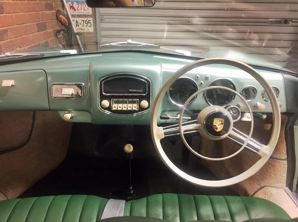

Radios
Acceptable radios for your Pre-A!

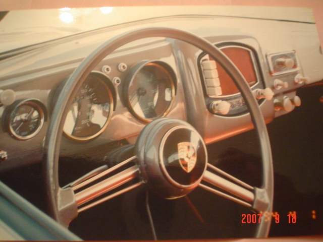

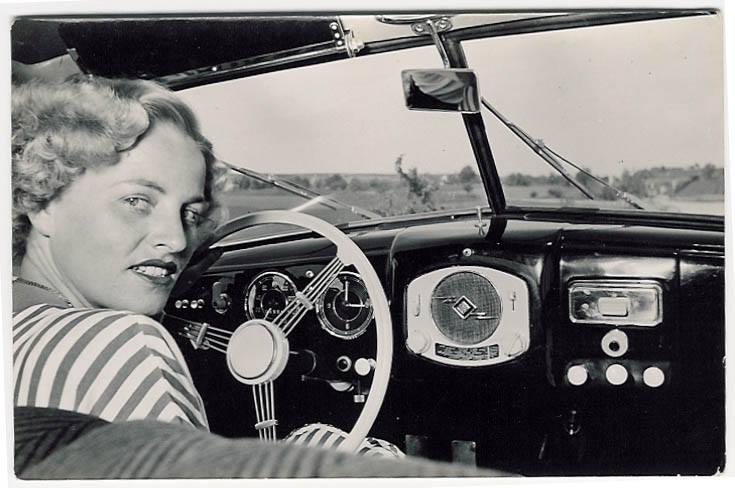

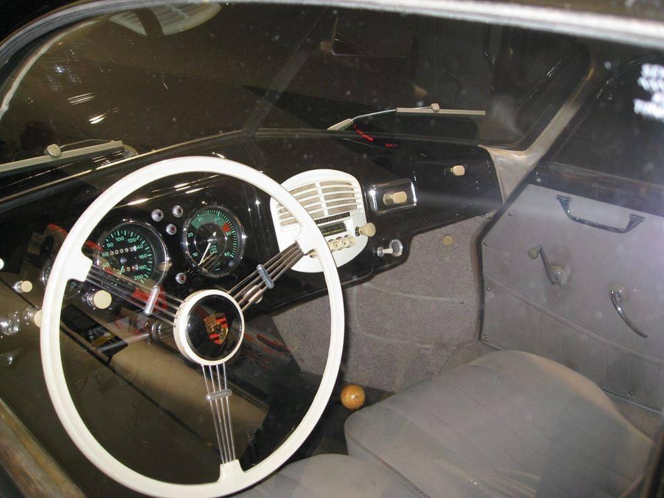

There were numerous similar-looking pod radios available for your Pre-A. The Telefunken ID52 is a popular choice. Radios marked with a * are known to have been installed back in the day. When retro-fitting, some owners like to dovetail the radio with their Pre-A year. Or just go with whichever radio takes your fancy - if you can find it! I think it’s cool to see the lesser-seen radios installed. Which is your favourite? Only a few Pre-As appear to run with a blank centre pod (ie without a radio).
Please chime in if you have a period picture that shows a radio installed, or if you know what radio your Pre-A had back in the day.
*Telefunken IA50/IA51
Pod style
Lightning radio
Good for the 2-piece screen cars, pre-52 (offset wiper motor)
But too boxy for the >53 (fouls central wiper motor)
Available 1949-1951

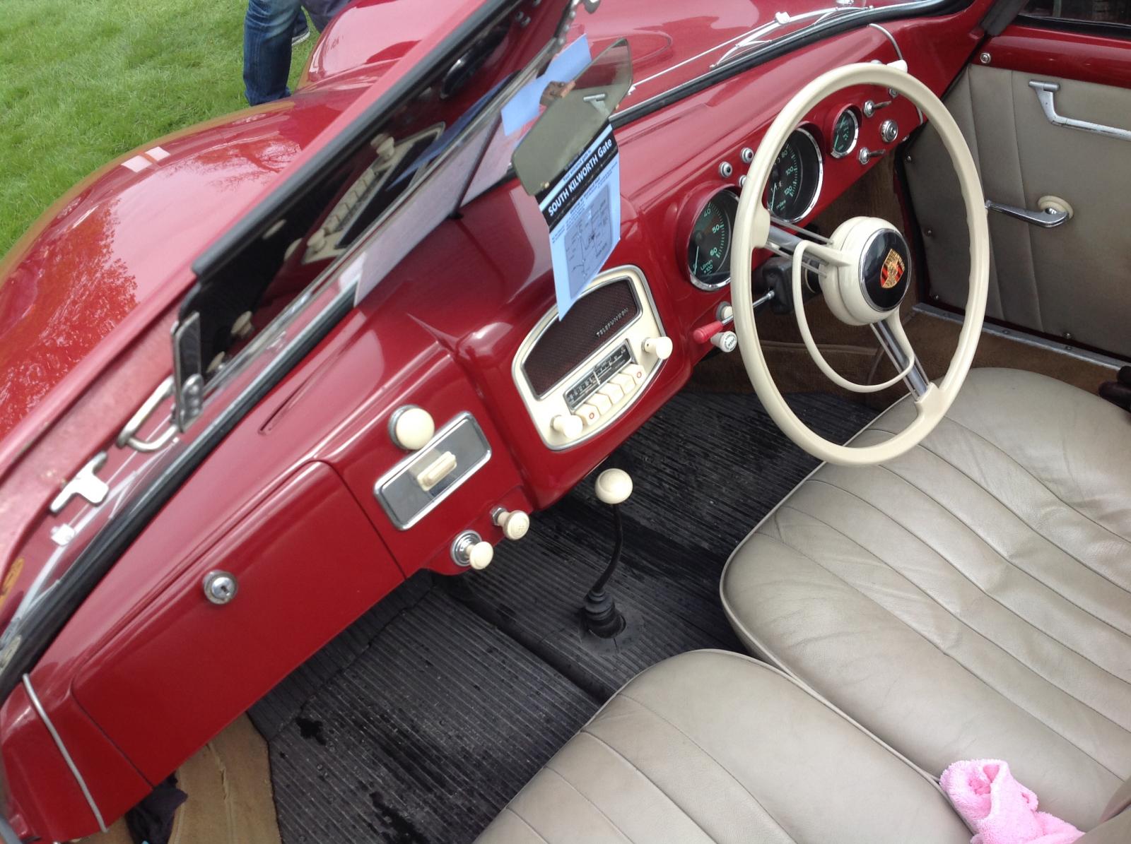

*Telefunken ID51/ID52
Pod style
Vertical push button
Factory installed 1952-July53?
Available 1951-1953
Telefunken ID53
Oblong style
With speaker faceplate
Speaker above radio
Factory installed Aug53-55?
Available 1953-1955
*Telefunken ID54
Oblong style
Looks very similar to the ID53
Speaker above radio
Available 1953-1957
Loewe-Opta (Löwe) 5651
Pod style
Available 1949-1951
*Blaupunkt AutoSuper A610B / A51L / A51EM
Pod style
Concentric circle design
The earliest A610B has the multi knobs behind the main knobs, and 3 dots on the faceplate above each main knob
The 1953 A51L also has the multi knobs, no dots
A51EM, no multi knobs
Factory installed radio in 1953
1950-1955?
Blaupunkt Frankfurt tbc
Oblong style
Radio is installed above the speaker
Factory installed radio, 1954/55?
*Becker Mexico
First in-car radio with fully automatic FM station scan
Becker Monte Carlo
Chrome & no lower knobs

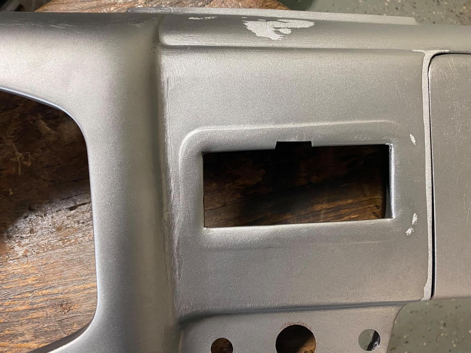

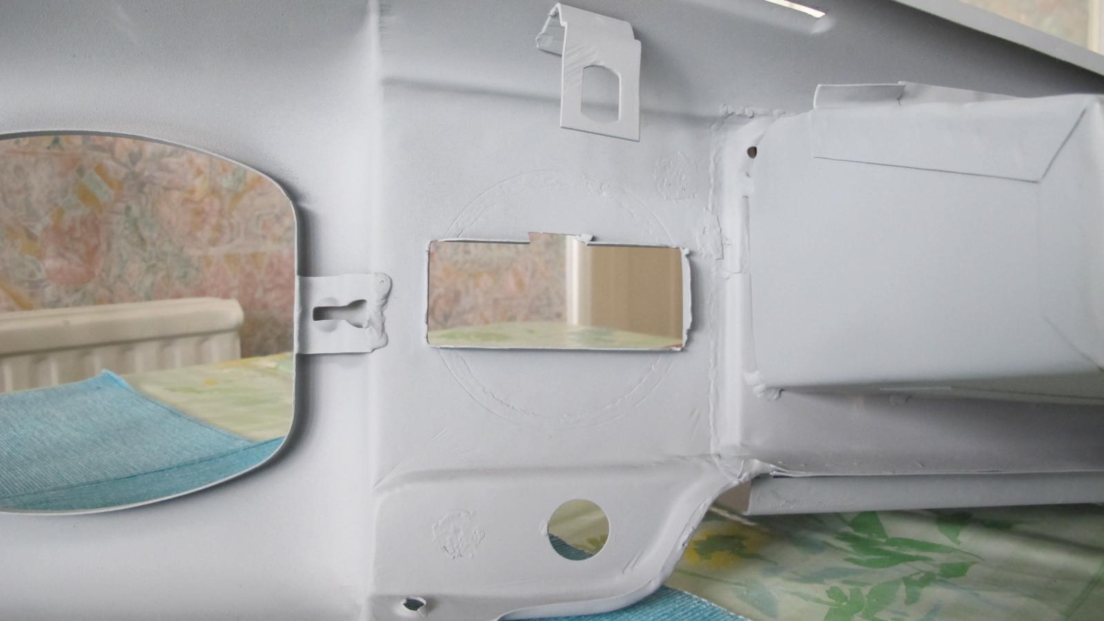

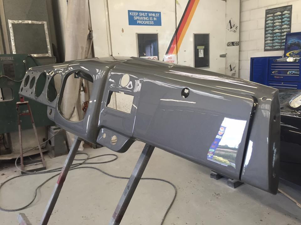

Naked Dashes
Prototype?
The boys
1950 into 1951?
Main fingerprint:
>Metal glovebox

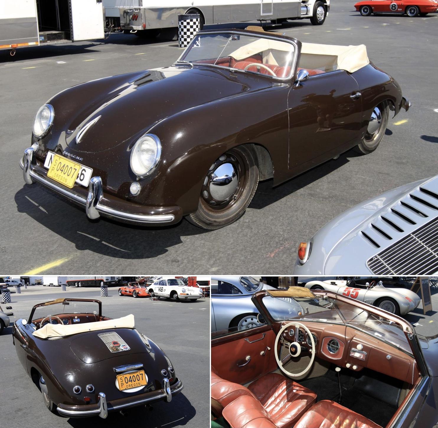

Example 1
Example 2
1953
L273 Beige Metallic
Map light hole above ashtray
Cabriolet
1955
Main fingerprints:
>Twin small hole, far left (accommodates new fuel gauge)
>Grab handle hole to right of glovebox
Example 1
Late 54/early 55 due to Ashtray area double hole
Example 2

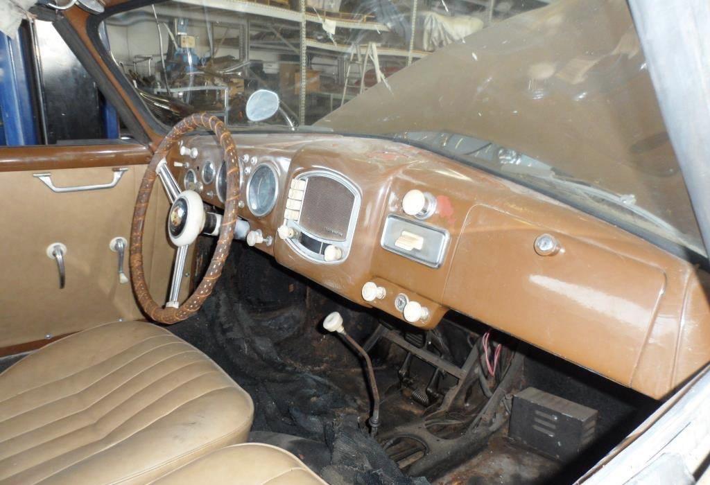

Paint
After initial painting in the body colour, it appears the dashes on the lighter colour cars received a darker, complimentary colour dash. This may have been to reduce reflected glare in the windscreen. Some restored cars have lost this cool detail, with the dash incorrectly repainted the body colour.
The dark colour chosen for the dashtop complimented the interior colour…a warm colour for warm colour interiors (ie reds), a cooler colour for cool interiors (ie blues)
If anyone has a picture showing an original paint dash on an original paint car, please post it up!

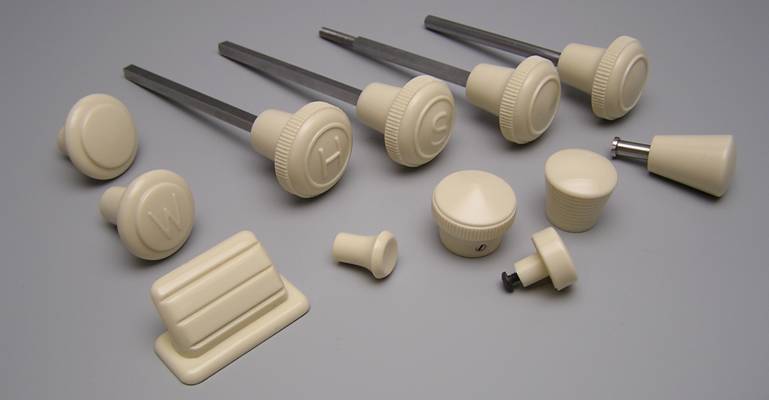

Reproduction Knob Set
Pre-April 54

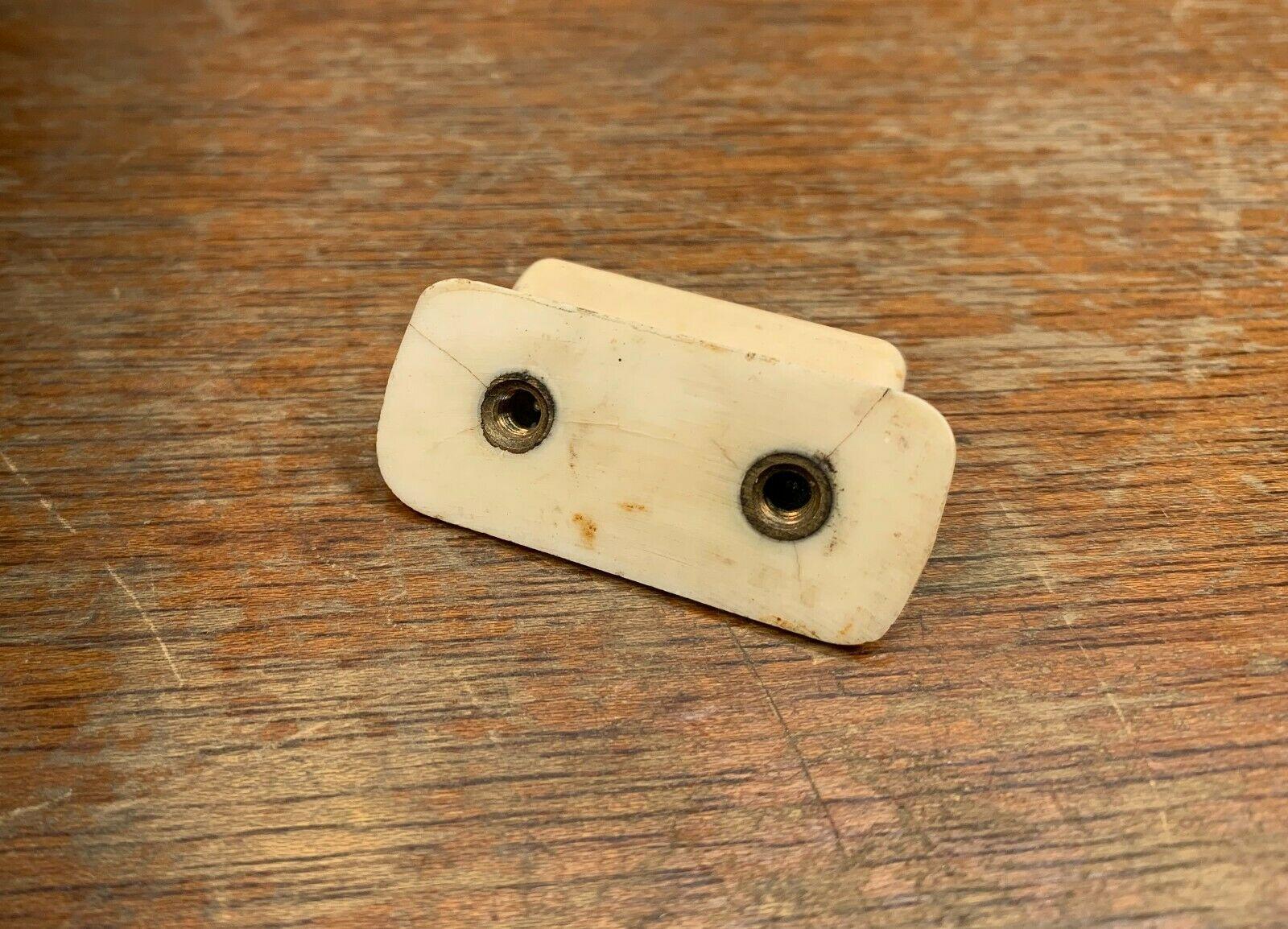

Waterfall Handle
50-54

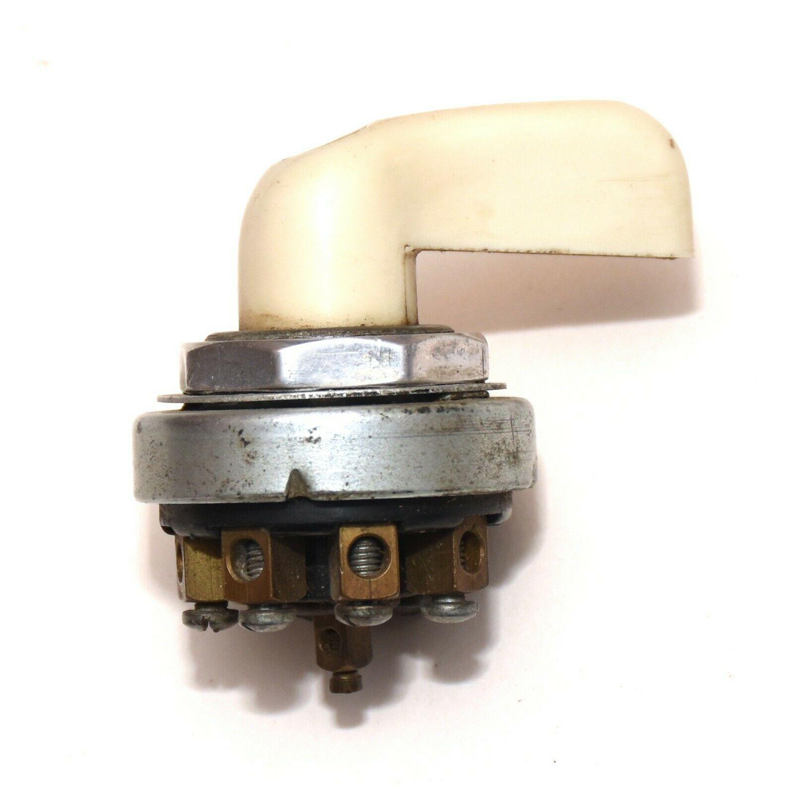

Lever Light Switch
50-51

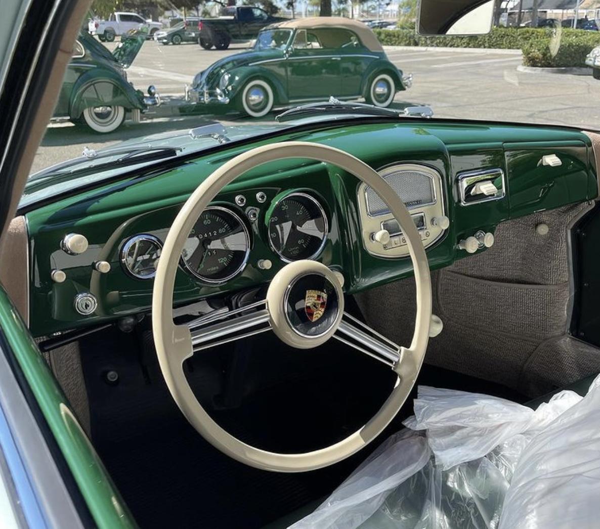

A
Single piece screen
Telefunken ID52
Early VDM 3-spoke wheel
Indicator arm
Locking glovebox (and tonneau studs) and map light above ashtray so cabriolet
Parallel wipers (incorrect)
Triple ashtray switch
Leatherette map pockets
Interim bumpers
Rectangular brakelights
‘52
B
Telefunken ID52
Late VDM 2-spoke with painted half horn-ring
Indicator arm
Fuel gauge far left
Grab handle
Lozenger handles
Parallel wipers
Small door pocket
Twin ashtray switches
Late ‘54 / early ‘55
C
Blaupunkt radio
I say ditch the wheel 😉
Indicator arm
Fuel gauge far left
Grab handle
Lozenger handles
Parallel wipers
Small door pocket
Late ‘54 / early 55
-StockRocks-

D
Clock not tacho
2-gauge dash (no oil temp gauge)
Lever light switch in 3-row formation
Telefunken IA50
3-spoke VDM wheel
Forward indicator switch
Opposing wipers
Wooden doortops
Offset door handles
2-piece screen
‘50 or early ‘51 tbc

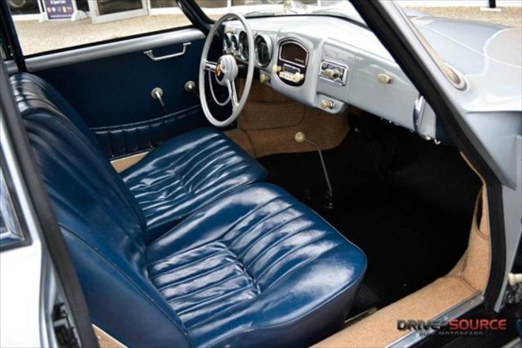

H
Telefunken ID53 or ID54 Radio
VDM 2-spoke wheel
Indicator arm
No door pockets
Opposing wipers
‘53

J
Clock not tacho
3-gauge dash (no oil temp gauge)
Offset door handles
Wooden doortops
3-spoke VDM wheel
Grundig speaker and under-dash radio?
Grab handle is a ‘55 feature
The later Lozenger ashtray and glovebox handles are incorrect
‘51
K
Beautiful colours
1950-54 blank centre pod
‘2-tone’ dash
No door pockets
2-spoke VDM wheel
Indicator arm
Glovebox lock and map light above ashtray for a Cabriolet
Standard pre-52 centre pod blank?
‘53 tbc
L

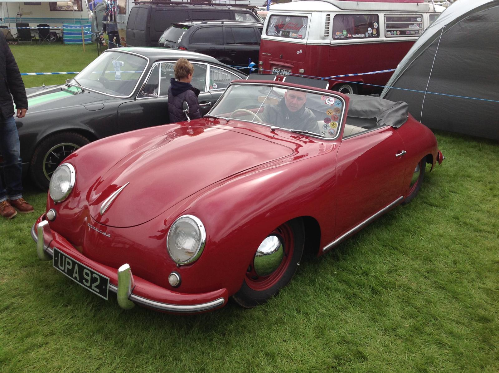

UK rhd Cabriolet
No door pockets
Telefunken ID53 or ID54 radio (added by current owner)
Inverted ashtray waterfall handle
2-spoke VDM wheel with half-ring
Indicator arm
Oil temp gauge hood is an addition
B/W picture is the car in the 60s! Note late bonnet handle, incorrect indicators…
‘53 (C)
Had a big smash in the late '50s which was repaired with an "A" nose and wing
-StockRocks-

PostPosted: Fri Nov 26, 2021 4:10 pm    Post subject: H1 I1 J1 Reply with quote
H1

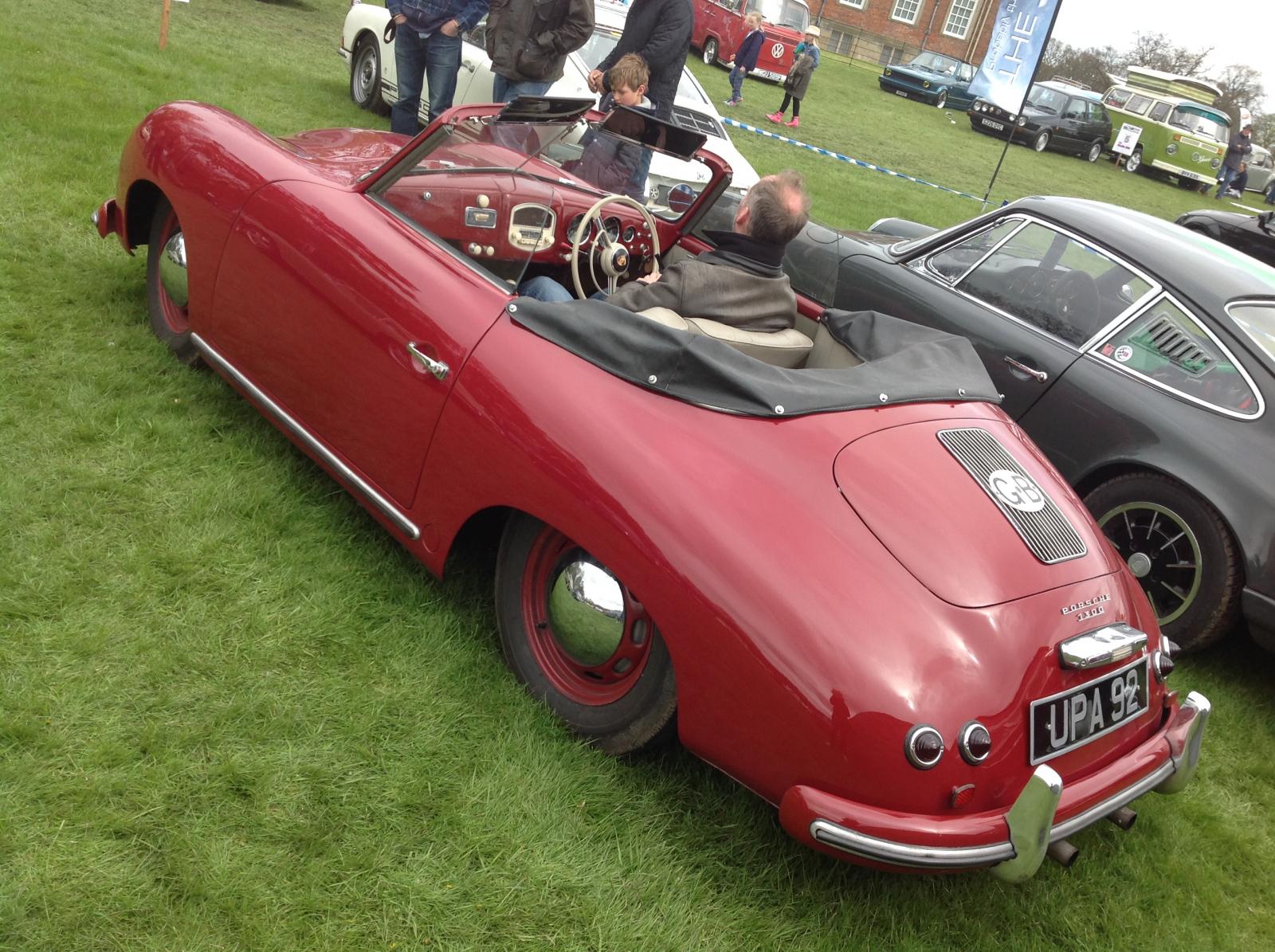

Reuter Cabriolet
Lockable glovebox and map light hole
Accessory glovebox clock
Blaupunkt AutoSuper radio
‘53

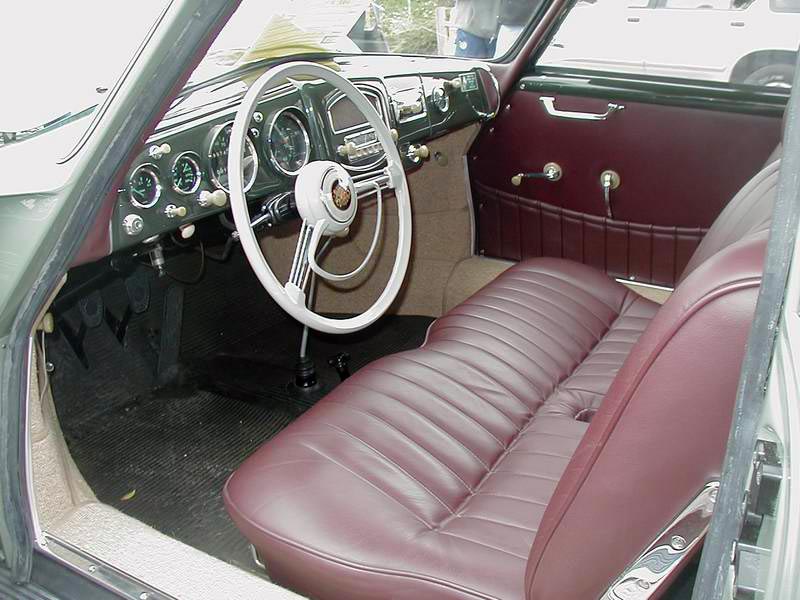

I1
Period picture, so it can be trusted
Cabriolet
Single screen
Parallel wipers
Lozenger ashtray handle
Lockable glovebox
Map light
No door pockets
Becker Mexico radio
No fuel gauge or grab handle
Beige or Grey wheel
‘54

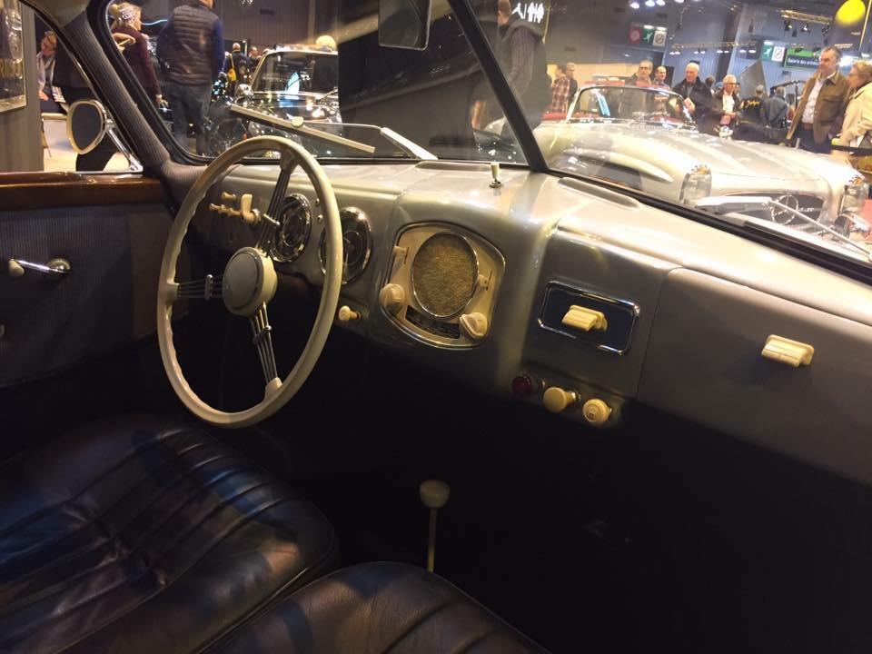

J1
Single screen
Opposing wipers
Indicator arm
Telefunken ID52 radio
2-spoke VDM wheel
Large door pockets
Oct 52 tbc
-StockRocks-

PostPosted: Sat Nov 27, 2021 9:50 am    Post subject: K1 L1 M1 Reply with quote
K1
Telefunken ID53 radio
‘54 (C)
L1
Same dash…now with the Ivory wheel
‘55
M1
Blaupunkt radio
‘55
-StockRocks-
