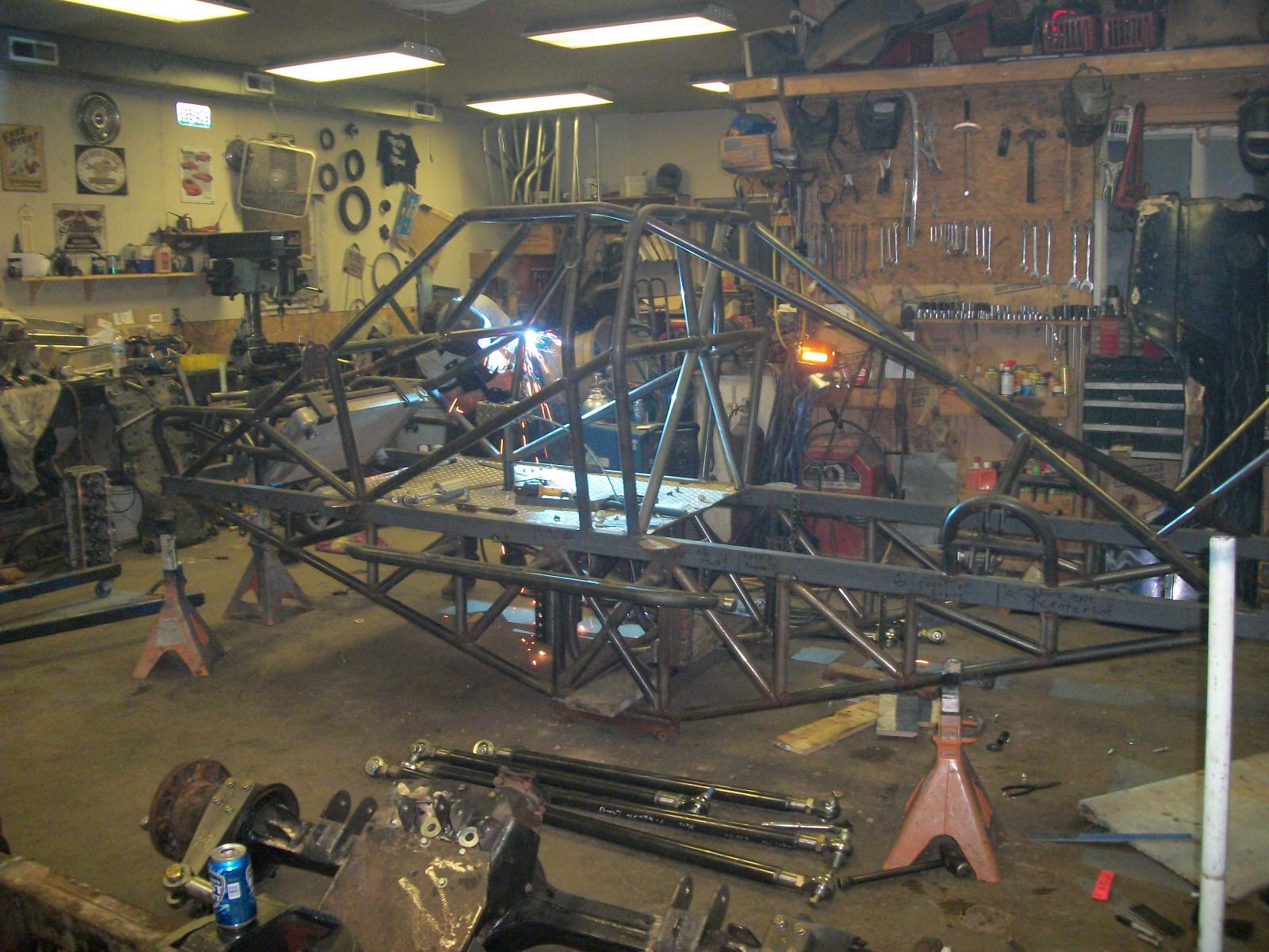

Some of us like to build other stuff also. Like rockwell axled, alcohol swilling mid mount bigblock mega trucks.
My cut in half and rebuild thread
www.thesamba.com/vw/forum/viewtopic.php?t=647779

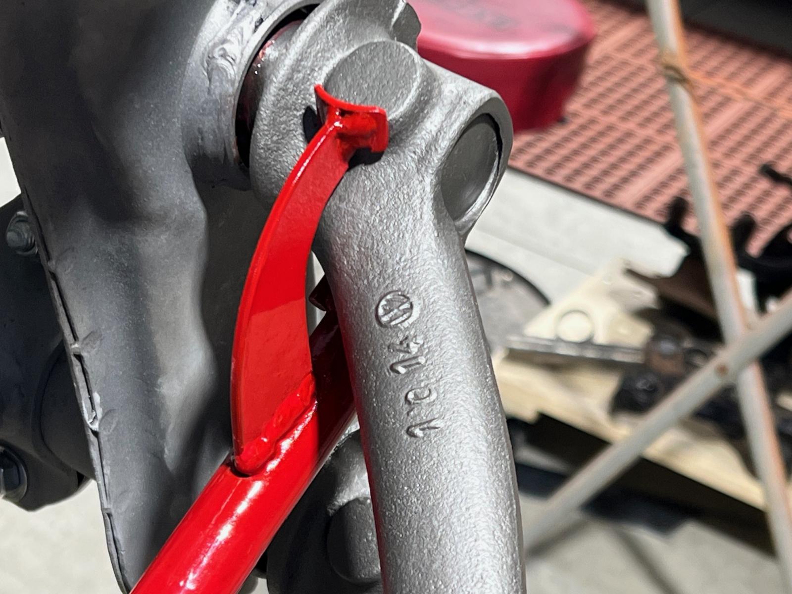

I'm going through this same thing as we type... Smile
I had decided to remove the lower torsion pack and through bolt it and I added an adjuster to the top beam and set it the opposite of the norm. I have the lowest/stock setting and I can then ADD more preload to the upper torsion pack if needed.
BUT... I know that over time, the upper will take on a bit of droop and need a bit more preload, but at that point the pack is probably being overloaded and loosing spring rate. SO... I've been bouncing (pun intended) back and forth on what to do on the front end.
I took the two thin outside springs off and added stubs tacked in at the ends and center to keep the same size at the grub screws. I put that in on the top only and it was not enough to keep the front end up, but very close. Now I have removed all three narrow strips on both side of the second lower torsion pack and again, added stubs of the thin springs in the appropriate places. I have it in the bottom beam and that beam does NOT have an adjuster in it.
In my mind, which is usually somewhat empty, I'm thinking that my two indifferent torsion spring packs, lower being weaker, will act as a helper to the upper; kind of like helper springs on a pickup. Time will tell. I'm going to be putting front hubs on this afternoon and testing my theory.
Also, I had beat my brains out trying to figure out how to preload the trailing arm enough to get it up into the ball joint hole in the spindle. I saw guys using pipe wrenches and having them slip. They also caused nicks and scratches on the trailing arms. Why get them all pretty painted up and such to just scratch the chit out of them??? So, I made a tool from an old hydraulic jack handle, some 1/8" plate, 3/8" square rod and a little chunk of tubing cut down. The first thought was for the driver's side, which worked great with the 3/8" square rod and hooking the grub screw. But on the passenger's side, it was the opposite rotation. I made the plate to come over the top and the tubing cups the knob on the trailing arm. The only issue is that I have to pull the grub screw to get it into position to lever on and put it back in for the actual work to be done. But it works great, and the handle is long enough to twist the torsion packs into position.
Driver's side use:
Passenger's side use:
Thanks to all for indulging me with my ramblings on and on and on, etc. Smile
Dan
