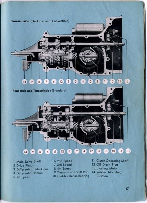

#12's in the diagram below for the drain plug locations.
https://www.thesamba.com/vw/archives/manuals/11_56beetle/67.jpg

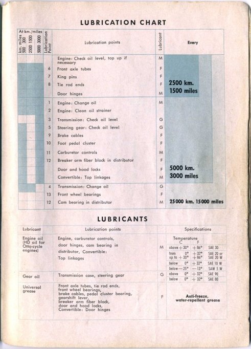

Recommended trans lubricant from 1957.
https://www.thesamba.com/vw/archives/manuals/11_56beetle/73.jpg
