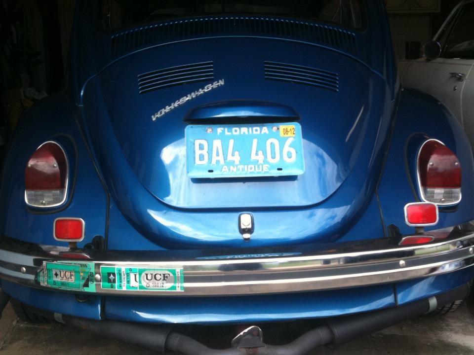

You might also be able to mount some rear bumper reflectors. They were a 1970-only thing as I recall, but wouldn't look that out of place to anyone except an OCD purist:

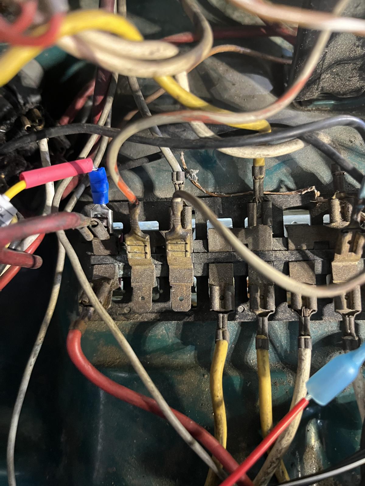

Happy New Year! Maybe this will help with the turn signal switch wiring.
Note…
This reproduction switch does not have OG colored wires
If you buy.... here’s the color code..
Red/Blk stripe is power feed
White/Red stripe is left side indicator
Yellow/Red stripe is right side indicator
Red wire... is not used
There are also 2 brown wires for the dimmer relay...
Solid Brown is grounded,
Brown/White stripe goes to flasher relay
This is from the notes on an eBay auction for a repop 66-67 switch.
https://www.ebay.com/itm/294277118348?_skw=turn+si...ondition=3
Hope it helps, Casey

Maiz67 wrote:
Hellooo-
So lots of great ideas. To power these 3rd lights etc, where and how do I splice into? Or do I run a new wire? If I do run a new wire and all the tabs on the fuse box are used how is that issue solved? Thanks
Left inside engine panel is the connections/wiring to both tail lights. Get a four way terminal instead of the three.
Later beetle so different wiring connections, but same general location:
Be a good time to run a multi-wire cable for gauges.
