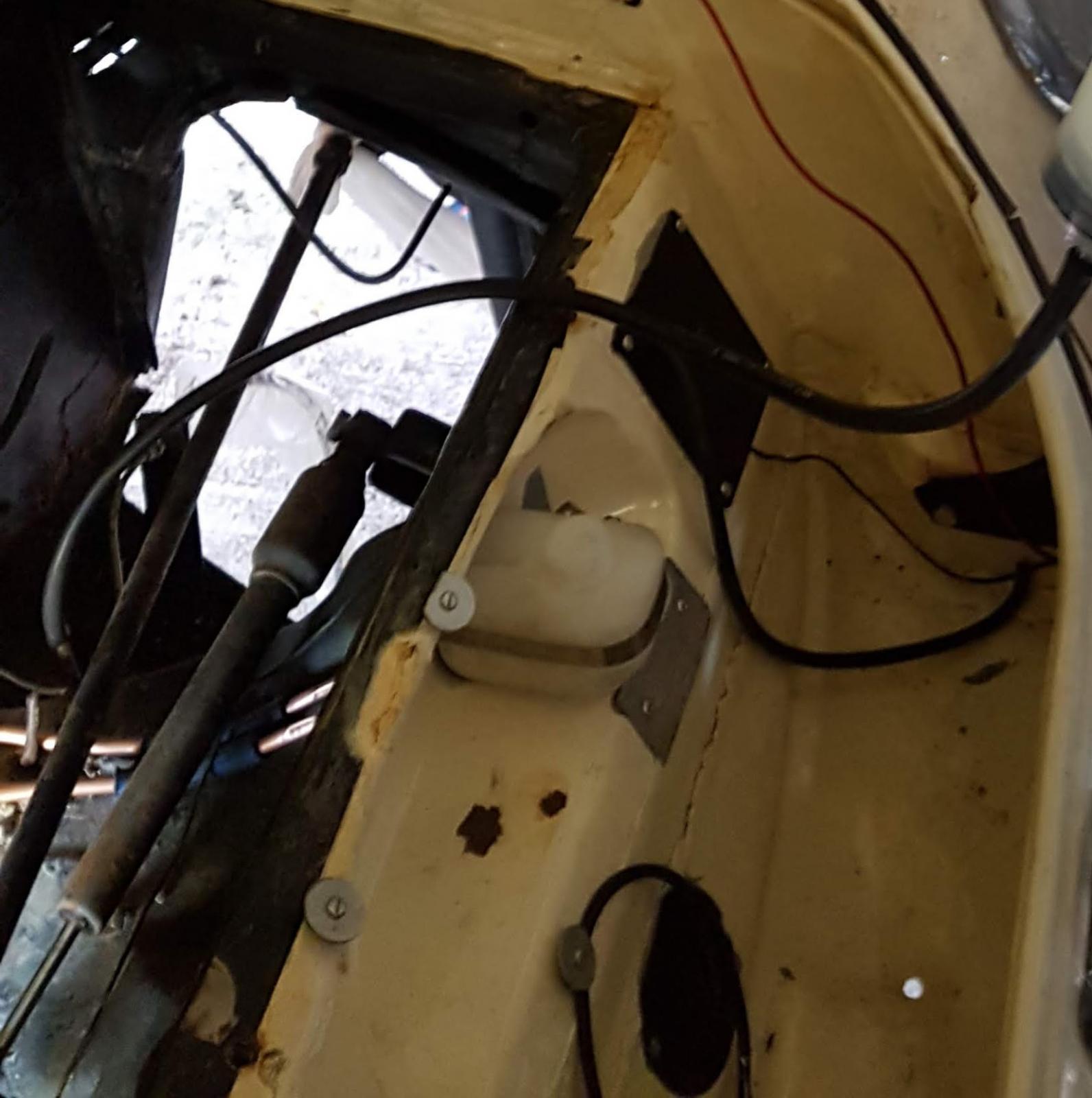

PostPosted: Tue Dec 10, 2024 3:51 pm    Post subject: Re: Need help sourcing T barbed fitting for dual MC to single res Reply with quote
schwim wrote:
I've thought myself into a conundrum. The ports on the mc and the corresponding blue braided line is about 7mm. The single port reservoir is decidedly smaller. Is there some sort of rubber reducer I could use to pair the hose to the reservoir?
Regarding reducers, have a look at page 2 of this thread: https://www.thesamba.com/vw/forum/viewtopic.php?p=10316661&highlight=#10316661
I'd consider using the dual chamber '67 reservoir to get redundancy all the way through the system. It's longer than the single chamber, but fits reasonably well in the same area. The strap is made from a large s/s jubilee clip.
