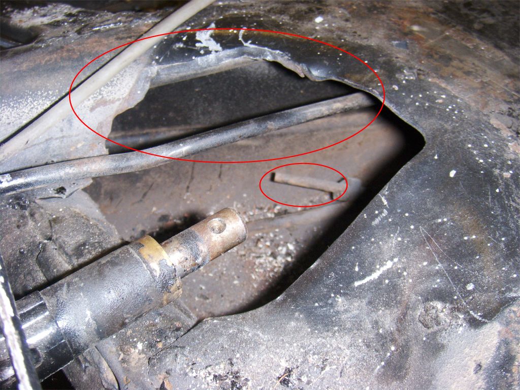

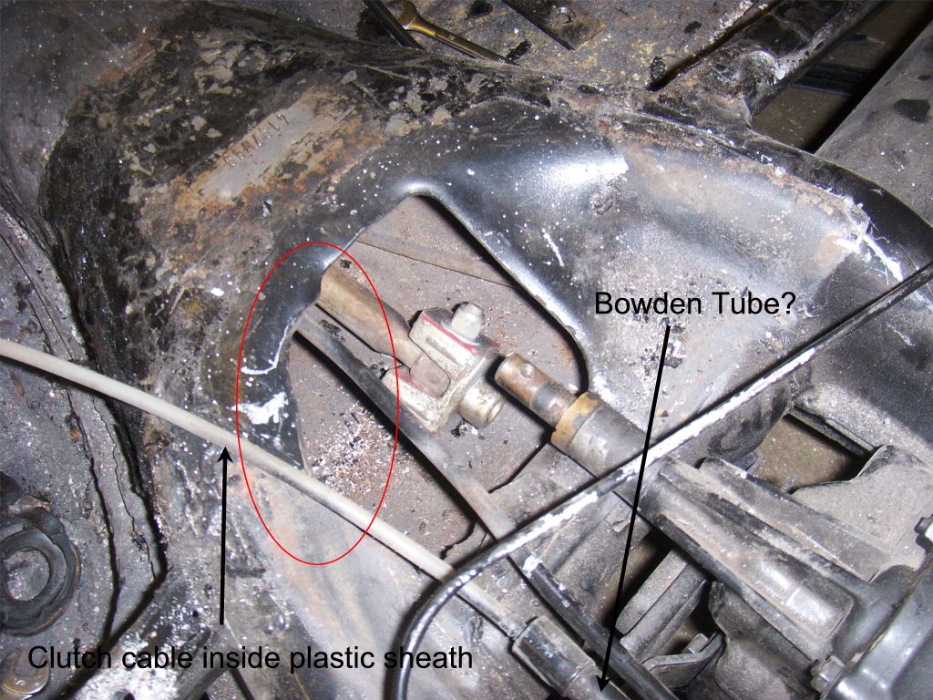

Posted: Sun Jul 24, 2011 11:41 am Post subject: |
finally had time to get the tub off the chassis and get a good luck at what is going on with this clutch cable tube. Or should I say, lack there of.
In this picture you can see that what I think is the Bowden Tube seems to be intact. However I can find no evidence of the cable tube in the tunnel.
The area circled in red appears to be a rather hideous hack job of cutting away part of the metal on the rear tunnel. I assume the PO did this toi get some access into the tunnel. I also assume the the missing clutch cable tube must have exited in the area of the tunnel where there is no longer any metal?
First question - has the strength of the tunnel been compromised by the removal of that metal?
The steel clutch cable itself is run inside a plastic tube (I have it pulled out of the tunnel). The plastic sheath/tube was not anchored anywhere inside the tunnel.
here's another shot of the rear of the tunnel where you can clearly see the hack job of the tunnel opening. I've also circled what I beleive to be the old metal fuel line. I will also replace this while I'm working in the tunnel.

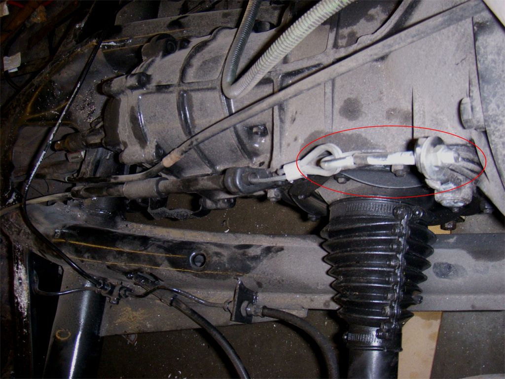

Posted: Sun Jul 24, 2011 11:48 am Post subject: |
here's another shot
in this picture take a look at how the clutch cable is hooked up the lever on the tranny. This dies not appear correct to me. It looks like PO just used an eye bolt.

in this photo you can see the tunnel access holes the PO had cut.
These will be handy for now but once repairs have been completed they will be welded closed.
I've looked inside these access holes and down the tunnel from the front but I cannot see any evidence of the oem clutch cable tube.
So I need some help to know where thate cable tube goes. Does it run just under the accelerator cable tube along the left side of the tunnel?
Can any of you guys give an idea of approx how far back from the clutch pedal shaft that the tube should begin?
Will I need to fabricate something to go on the rear of the tunnel for the tube to exit or can I run it right out the back of the tunnel and up to the bowden tube?
Just trying to get my head around what I have here and how I am going to repair it. I want to do this right.
