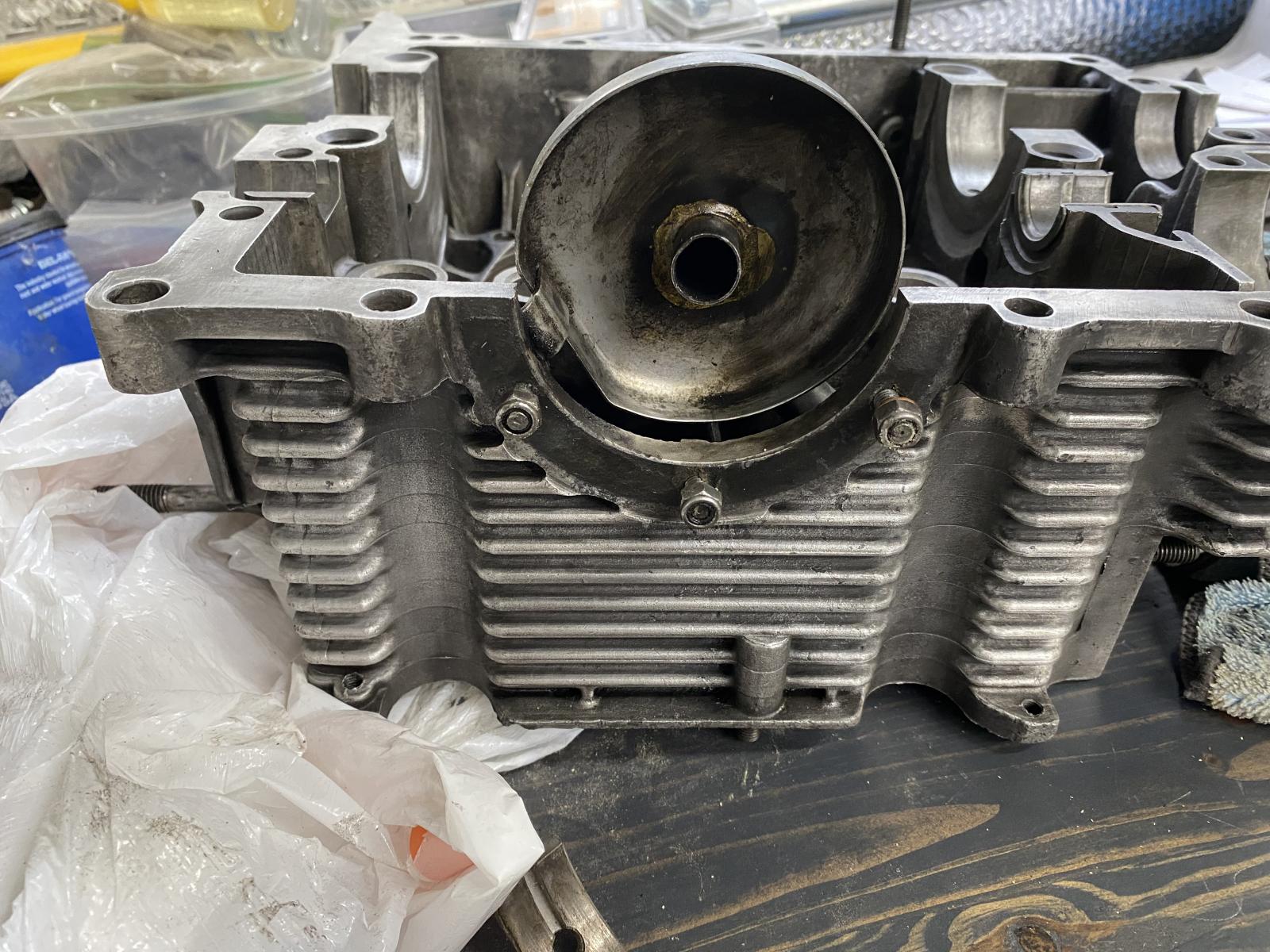

I’ve only cleaned the one half really good. The other half looks like it’ll be similar with the exception of the corrosion at the oil pan

PostPosted: Sun Dec 15, 2024 4:07 pm    Post subject: Re: New case or rebuild Reply with quote
Magnesium is lighter and runs cooler.
Looks like you have a little corrosion next to the drain plate which can be dealt with easily. Do you see corrosion anywhere else?

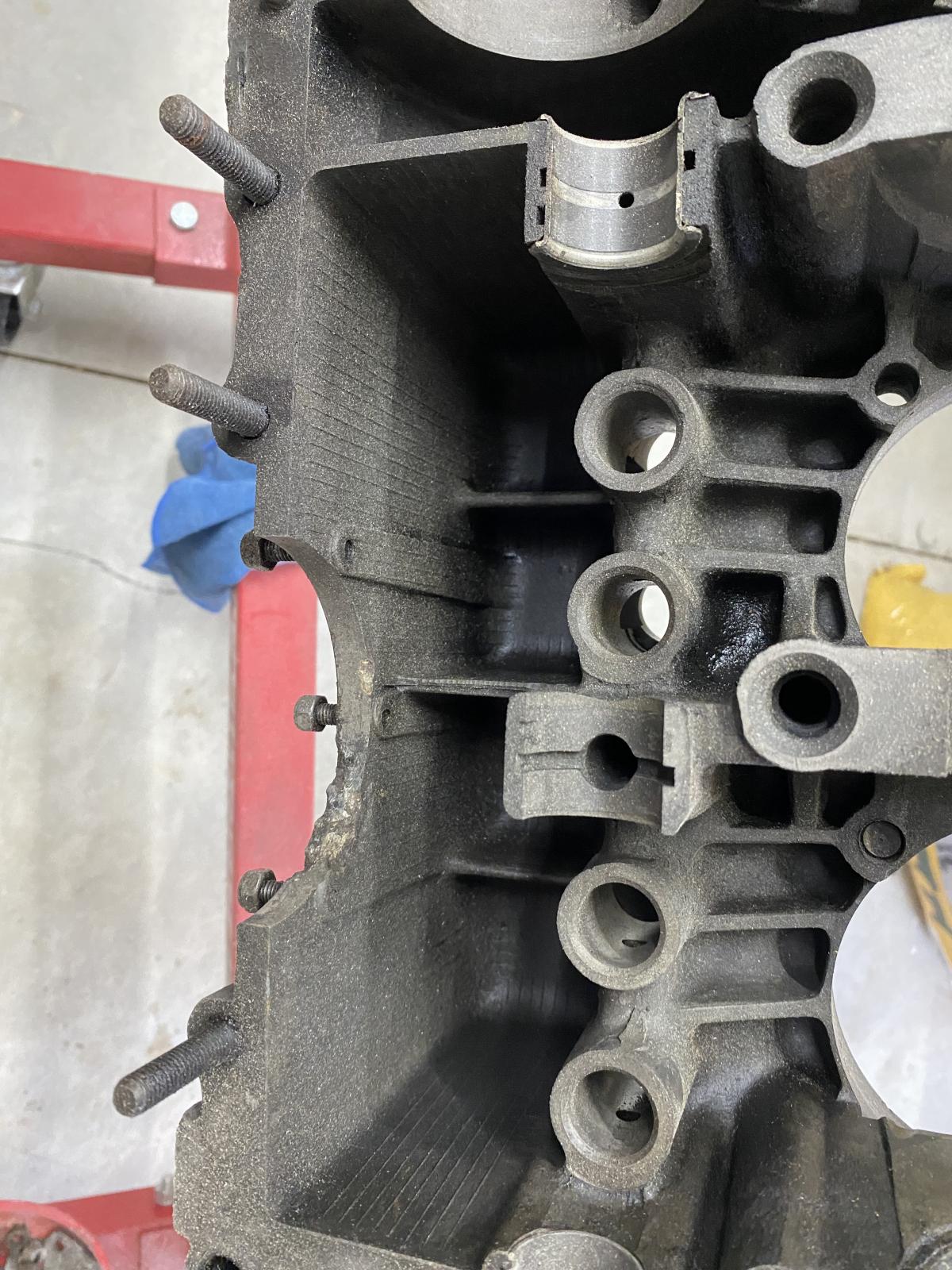

PostPosted: Sun Dec 15, 2024 4:46 pm    Post subject: Re: New case or rebuild Reply with quote
Check the saddles for spread, check all the studs, inspect behind #3, and generally give it the most scrutiny you can. And then send it for line bore and ask whoever does the work to check also. You already own this, and if it is good there's no reason to not use it.

PostPosted: Sun Dec 15, 2024 5:21 pm    Post subject: Re: New case or rebuild Reply with quote
Looks like your lifter bores are pitted
I’d scrap it, but that’s how I am. That case needs an align bore, case savers installed, lifter bores sleeved, clearanced for stroker crank, cylinder bores opened up, and the deck machined.
Even if you went stock, you still need an align bore, lifter sleeves, case savers, and the deck cleaned up. Go price that work

PostPosted: Sun Dec 15, 2024 6:00 pm    Post subject: Re: New case or rebuild Reply with quote
Good catch Txoval. Yes, those lifter bores are toast.
Get a aluminum case. Once you "polish a turd" and pay to have all the work done to it to fix that mag case, then it will still have a issue later. Build a engine on a good foundation so you can do a nice job and not have to pull it out later and spend the cash twice. Its a lot more expensive that way, and more hours of your labor.
The mag cases flex more then aluminum. The wind blows the wrong way and they have issues. Nothing like the solid cast iron blocks your used to. The aluminum is one step closer though.
