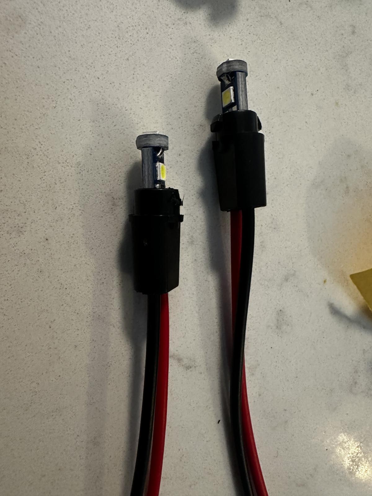

Robsmaze wrote:
Rear heater and climate control lamps had burnt out. New ones are $10 at GoWesty each, plus shipping. Ughhh. Instead I purchased:
Nanpoku T5 LED Bulbs 74 73 37 2721 LED Bulb for Auto Car Dashboard Dash Instrument Panel Gauge Cluster Indicator Lights Lamp(White)
https://a.co/d/iYkaWnB
Modengzhe 10 Pcs T5 Twist Socket Car Dashboard Wiring Harness, Panel Cluster Plug LED Bulb Wedge Light Base Cable for Automobiles
https://a.co/d/6odHE1I
And a pack of little spade connectors:
Glarks 315Pcs Quick Splice 2.8mm 4.8mm 6.3mm Male and Female Wire Spade Connector Wire Crimp Terminal Block with Insulating Sleeve Assortment Kit
https://a.co/d/cjd4YdC
Total cost, presumably less than two bulbs and shipping. Crimped the male spades on the end of each wire and trimmed the tiny twist lock nub off the black connector off with a dremel.
They fit nice and they are perfectly bright and even dim…
Now I have an extra eight setups….

PostPosted: Tue Dec 31, 2024 8:50 am    Post subject: Re: 321919039 - Bulb & Socket for Dash Vent Control/Heater Switch Reply with quote
That is a nice info, thank you!
I've been saving the white sockets over the years , now NLA, that allow to replace the bulb vs the black sockets. Swap in LED, golden, but they're rare!

PostPosted: Tue Dec 31, 2024 11:59 am    Post subject: Re: 321919039 - Bulb & Socket for Dash Vent Control/Heater Switch Reply with quote
That's the nicest cleanest retrofitable unmodified solution I've ever seen.
Nice Work
Beats , by miles, what I did 10 years ago https://www.thesamba.com/vw/forum/viewtopic.php?p=7898973&highlight=#7898973 (but still working)
