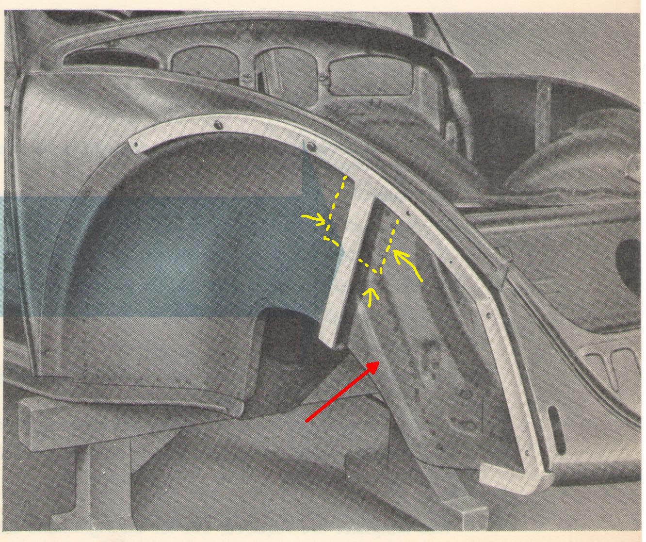

lit looks like that the double layer metal patches are missing at the blue one.
They shall sit there:
I am not sure when they started. But I have a early 1949 and it still has them.
Another reason I love this forum. Thank you for bringing that up....
I have this photo I took recently doing research of the somewhat odd doubler they used. Can you guys confirm this in fact should be present on this 47.
Thanks in advance guys.

I would guess it should be there.
But as I said. I do not know when they started with it.
Somebody should know.

The photo I posted was of a 47 and with this being a Nov 47 it was looking like I maybe adding this detail back to the beetle. (Just seemed so odd to me) From what I saw it was just a copy of the contours in that area and spot welded on They looked like sections cut off another panel and put on there. Possibly they descovered it was a crumple zone and they used the big press to stamp that section. Or maybes they took them off cars in the bone yard. Very interesting how they came about doing that. Definitely looks like a after thought based on performance discoveries. Lol. IDK. I'm just making stuff up now.
Who's got another theory. ?

I have no idea why they thought this area should be reinforced.
But those panels stayed up to at least mid of 1949.
Maybe dropped with the bigger tank?
