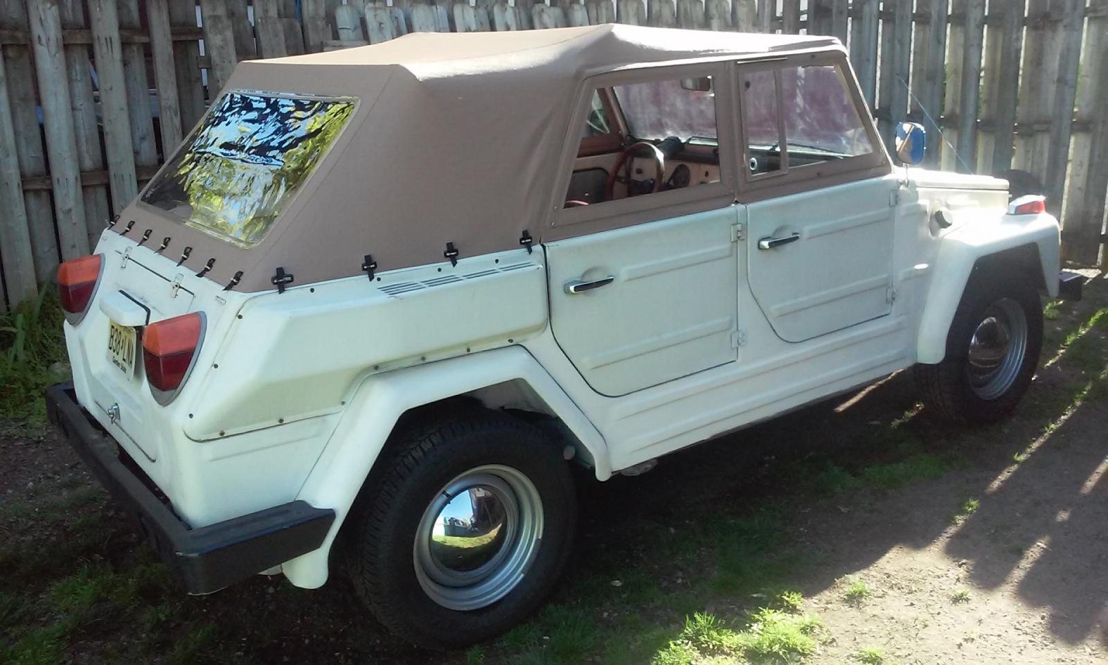

Indeed your Thing looks really good. I also have a white w/saddle top '74.
I broke my hip last April and after healing it is a chore getting in & out.

Hey Harp, your Thing is a spittin' image of ours!

Nice Thing. Is that stock height and what tires?

Thanks it wasn't so nice when I towed it home 9yrs ago.
Yeap...stock height. That is my problem, the Thing has 13" ground clearance plus 10" sill,
that's 23" to get your leg over. The wheels have stainless steel hubcaps on smoothie
15 x 5.5" wheels & 205/70 R 15 Yokohama Geolandar tires.
