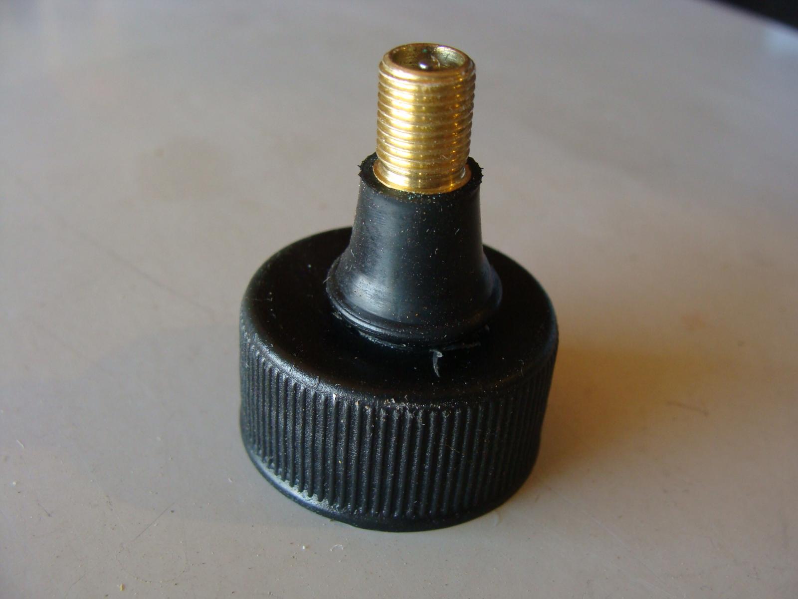

I did make a home-made pressure bleeder, very simple. See that here:

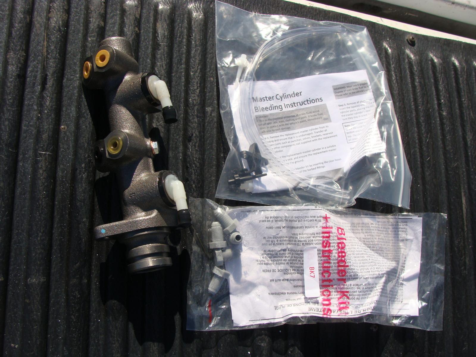

I took that in to Autozone and got a free replacement BRAND NEW MC they had ordered for me (Super MCs are different than in standard Beetles); fortunately, my receipt from 1994 from my rebuilt MC was still legible as before they went computerized.

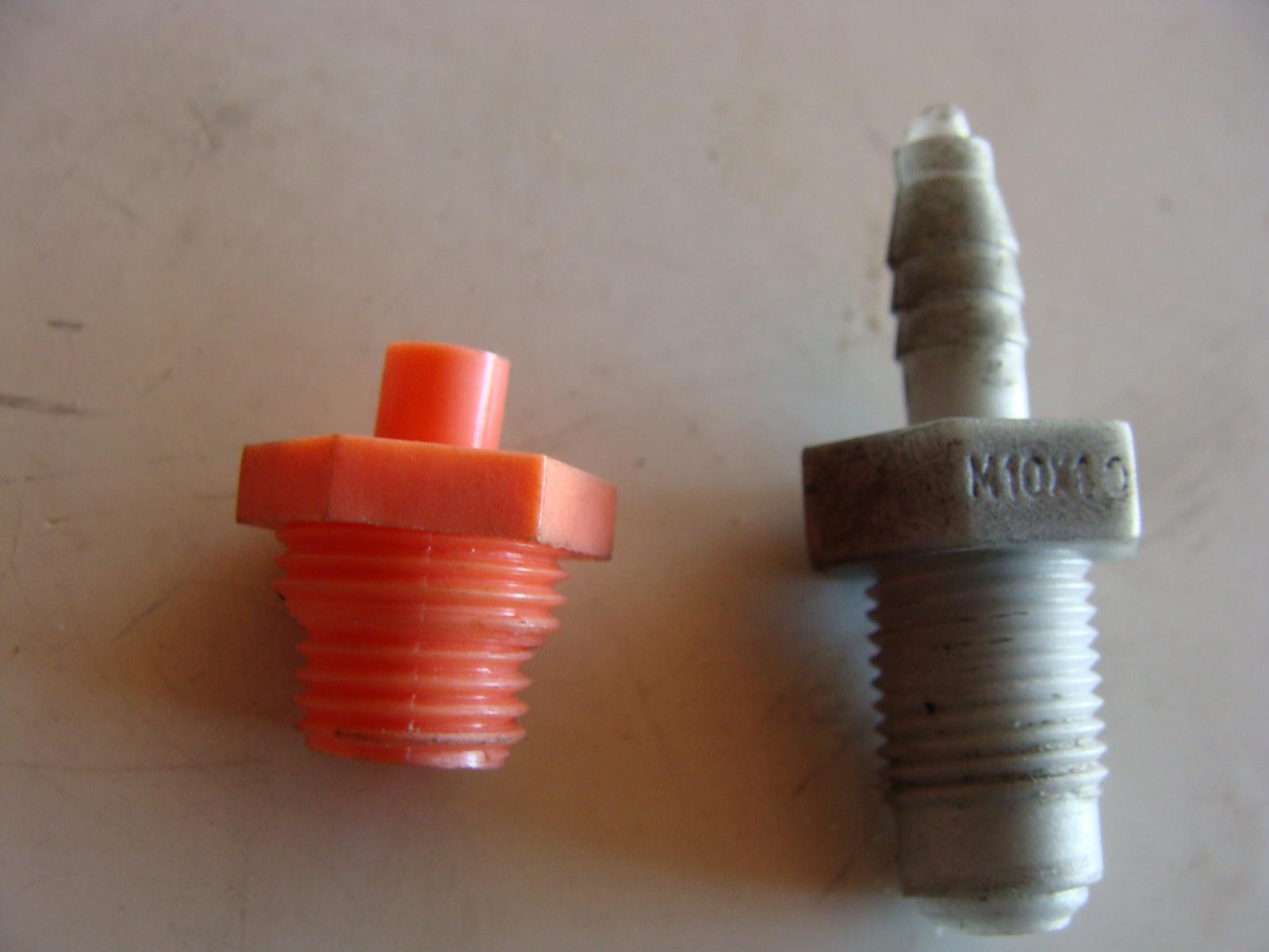

This came with a bench bleed kit but unfortunately that did not have the correct type of fittings to bench bleed, so I used fittings from past MCs to bench bleed it.

I wanted to try making a pseudo power bleeder to try. I found a cap in my garage that fit the VW MC reservoir. I drilled a 29/64" hole in the cap, because I had a tire valve stem that required a 0.432" hole. Then I pulled the valve stem through.
I filled the reservoir with new brake fluid, screwed on my cap with valve stem, set my air compressor to about 20 psi and attached it to the valve stem. Then I opened up the bleeders in sequence, filling up the reservoir as necessary to flush out all old brake fluid.
