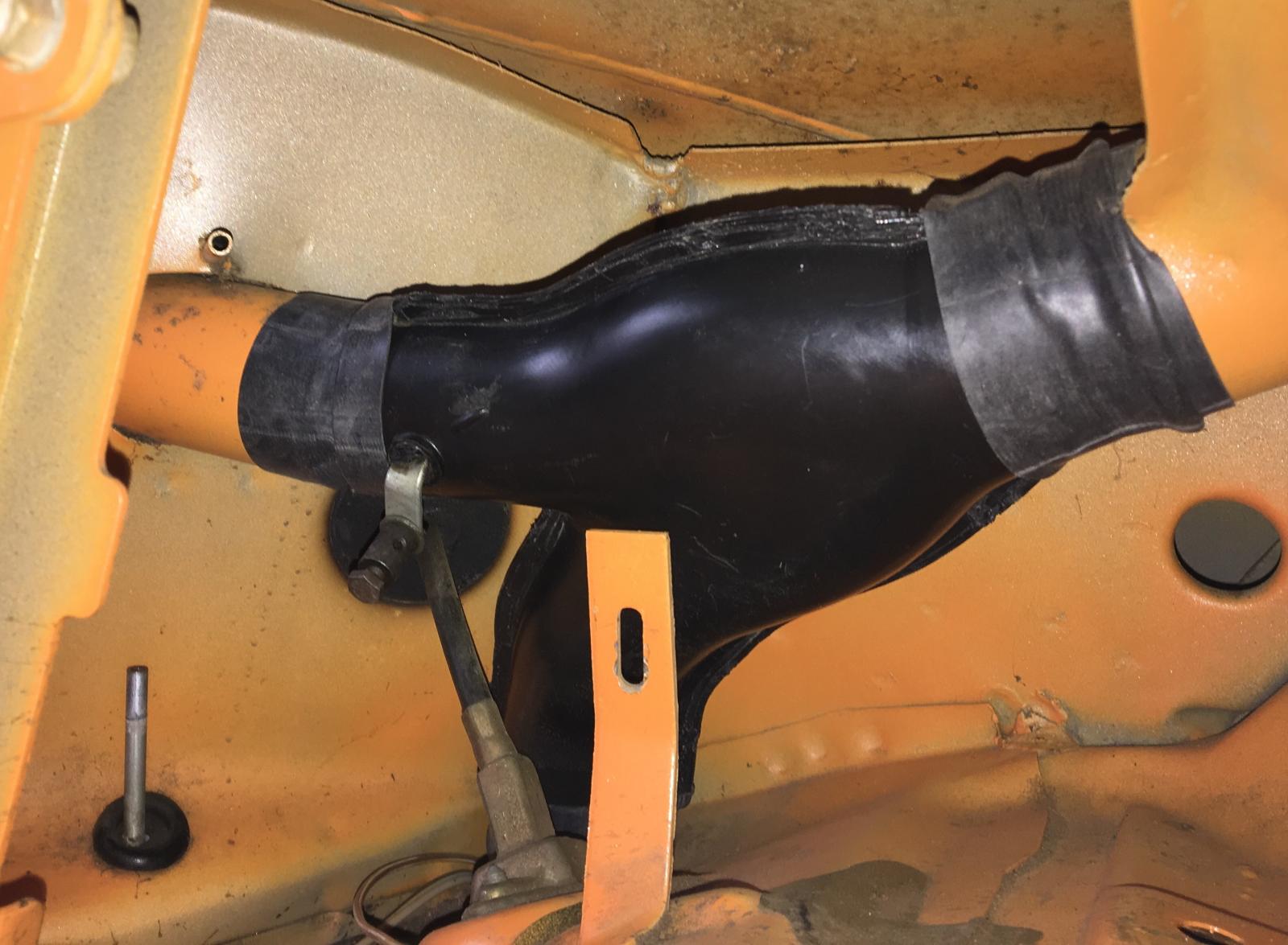

Alright. I found the levers, but I can't tell whether toward the nose, or toward the cab is closed.
Anyone happen to know?
Thank you!
64 No'back Speedster "Pearl"
LME "Little Giant Killer 3"
1974 Ghia "PUK"
vwfye
Joined: April 15, 2000
Posts: 7755
vwfye is offline
PostPosted: Tue Jan 14, 2025 10:32 pm    Post subject: Re: 74 no cables to fresh air vents... Reply with quote
They are closed. What a difference!
