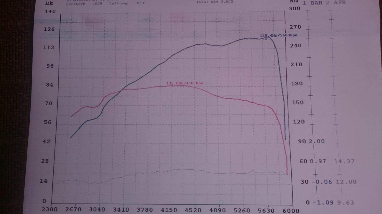

I´ve shown this one before, but still. 1776 a 218/119 cam, detailed stock heads, 9-1 CR, slightly modded dual 36 Dellorto´s, VS sport muffler. That cam is approx 7 degrees MILDER than the W110 but 30 years newer in design. The other parts naturally also play a role:
Personally I would much rather save money on machining the case and save a little on the cylinderkit and use that on the heads and build a 1600 like this:
Such a 1600 will run in circles around most budget 1776´s, run cooler AND do better fuel efficiency.
Just FYI.
