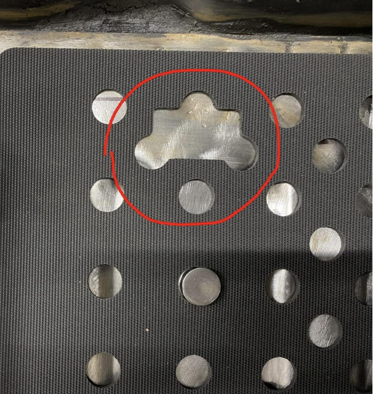

Does anyone know what this recess in the rubber mat is for in the 181? Is it for something from the heating system in the civilian version? Does anyone have a photo of the place with the mat and the part that probably goes there? It is directly to the frame tunnel in front of the seat frames on both sides (driver and passenger)

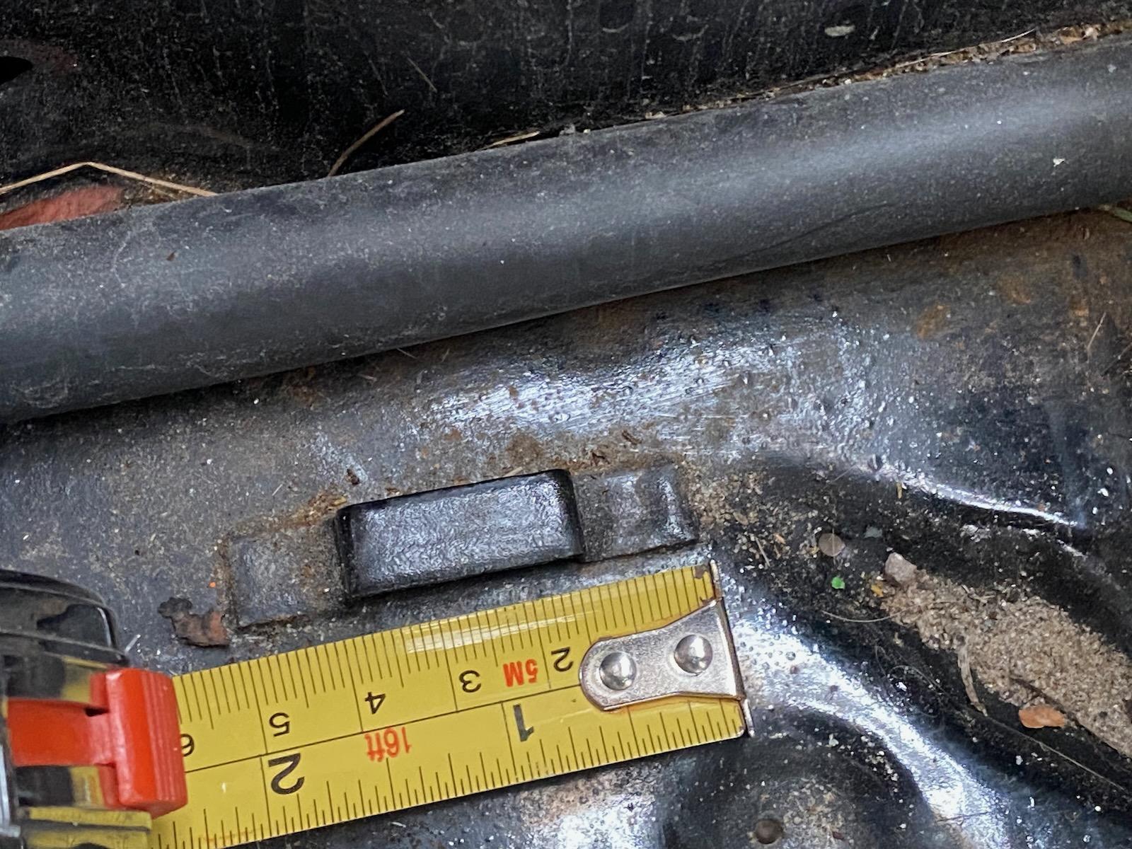

PostPosted: Sat Jan 25, 2025 4:38 am    Post subject: Re: rubber mat question Reply with quote
No, that one runs in between the front seats.
There are two in the front foot areas on either side of the tunnel feeding the hose into the center section which allows heat to either the front foot area or to the windshield

axel struwe
Joined: January 18, 2005
Posts: 298
Location: Germany
axel struwe is offline
PostPosted: Sat Jan 25, 2025 6:06 am    Post subject: Re: rubber mat question Reply with quote
https://www.thingparts.com/protection-plate-front-left-used-cracked/
This plastic tongue is then inserted into a metal sheet (?) that is screwed onto the floor panel in the area where the rubber mat has this recess. Right?
74 Thing
Joined: September 02, 2004
Posts: 7672
74 Thing is offline
PostPosted: Sat Jan 25, 2025 7:28 am    Post subject: Re: rubber mat question Reply with quote
https://www.thesamba.com/vw/forum/album_page.php?pic_id=2287080
axel struwe
Posts: 298
Location: Germany
PostPosted: Sat Jan 25, 2025 7:43 am    Post subject: Re: rubber mat question Reply with quote
thank you very much for the information! i now understand that there is a tab welded onto the floor panel. The plastic part is hooked into this tab at the bottom and screwed tight with a screw at the top.
And the larger hole in the rubber mat is for the space of the sheet metal tab, right?
in the photo, the plastic part is not properly installed, it is only on top of the tab, right?

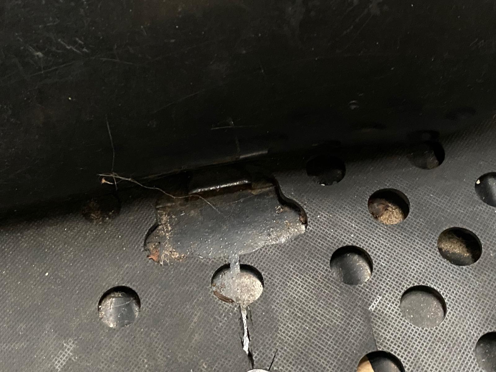

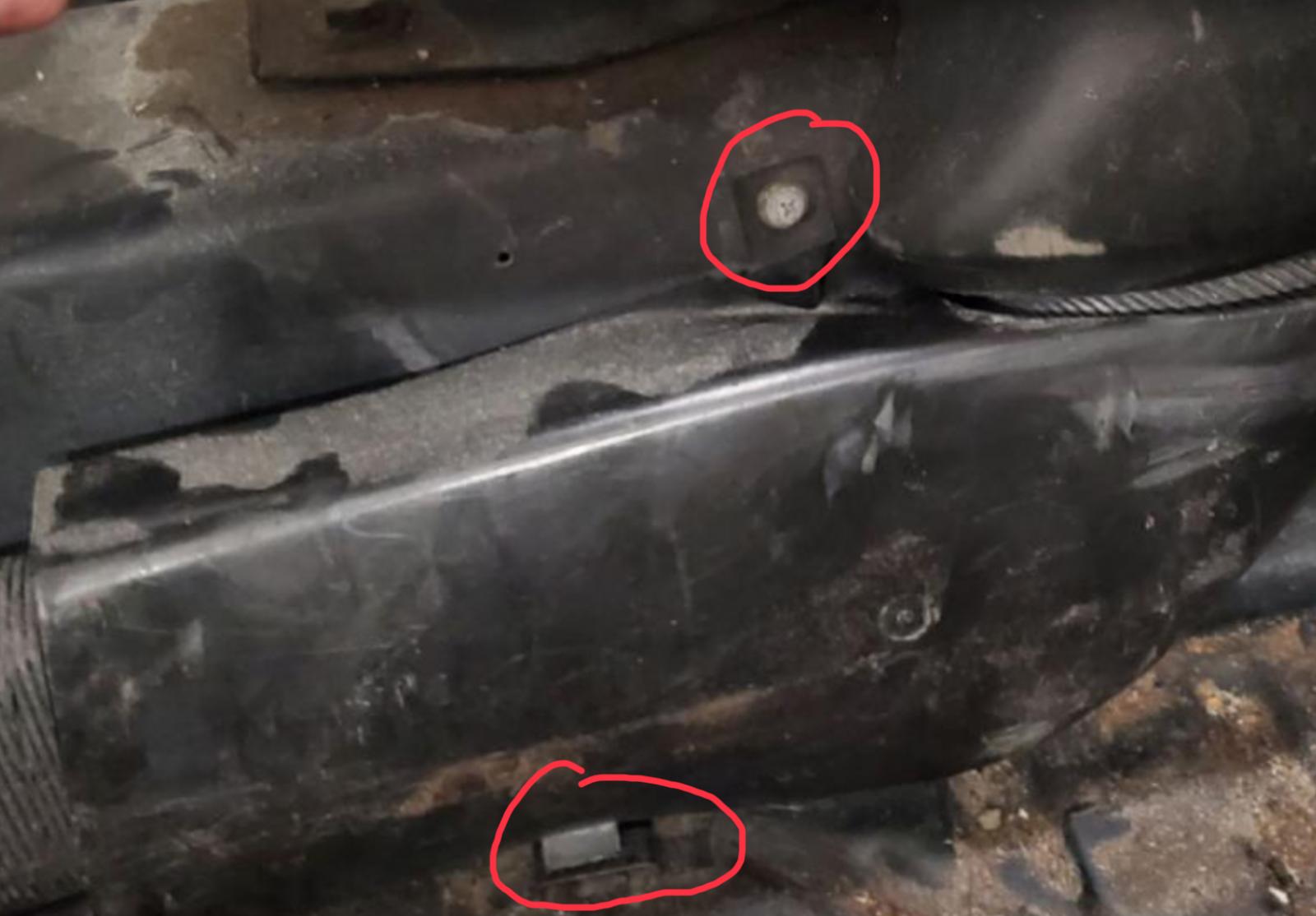

germansupplyscott
Joined: May 22, 2004
Posts: 7283
Location: toronto
germansupplyscott is offline
PostPosted: Sat Jan 25, 2025 9:57 am    Post subject: Re: rubber mat question Reply with quote
Some photos of an original '74 for reference.

axel struwe
Posts: 298
Location: Germany
PostPosted: Sat Jan 25, 2025 12:02 pm    Post subject: Re: rubber mat question Reply with quote
[quote="germansupplyscott"]Some photos of an original '74 for reference.
Thank you very much for your photos.
