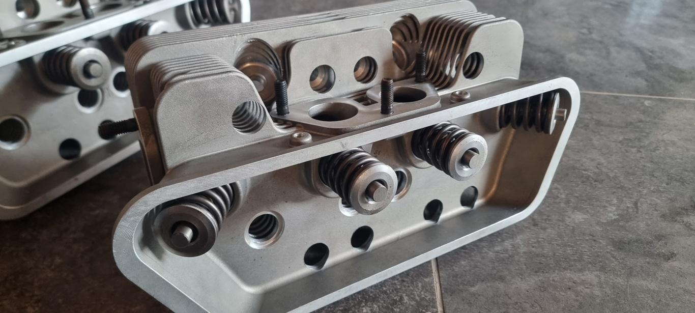

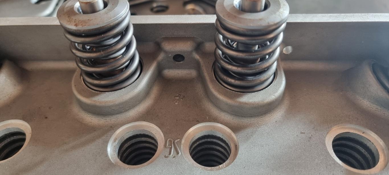

stefi.g
Joined: December 05, 2005
Posts: 43
Location: Czech
stefi.g is offline
PostPosted: Sun Feb 09, 2025 2:45 am    Post subject: Re: Porsche 356 PreA 2-piece case engine heads Reply with quote
hi guys, I still produce PreA heads, all they are in stock,you are welcome to contact me.
