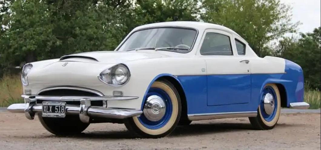

I will try to sum up the "Justicialista Sport" story:
In the early 50s, Argentina´s President Peron wanted to promote the industrial development of the country, so he created a state company and started manufacturing trucks and cars. He decided to import Porsche industrial engines in order to make a farm Tractor, but then he realized that engine was more suitable to make an sports car, so the "Justicialista Sport" was developed: a 2 door car, with fiberglass body, and front mounted industrial 356 engine.
167 Cars were made between 1952-1955; in that year the the president was overthrown, the factory closed, and another Factory, TERAM (Talleres Especializados en Reparaciones de Autos y Motores) bought all the the remnants of the factory parts, changed the design , They moved the engine to the rear of the car, and the Porsche Teram Puntero was born. It was said that this car was approved by Ferry Porsche himself. 144 Porsche Teram Puntero were made, including 3 cabrio cars.
As you can see, the relationship between Porsche Factory and Argentina country started many years before the Zunder factory was Born

Thank you very much for your pics and overview.
Meanwhile I´ve learned a bit about Juan Peron and some political connections to germany that times. But it´s more about technic here.
Correct me please, if I´m wrong. The front-engine Justicialista was based on german DKW base and upgraded. Some of them got a Porsche engine. The tractor was a licenced german Lanz model. `Pampas - Lanz´, correct?
