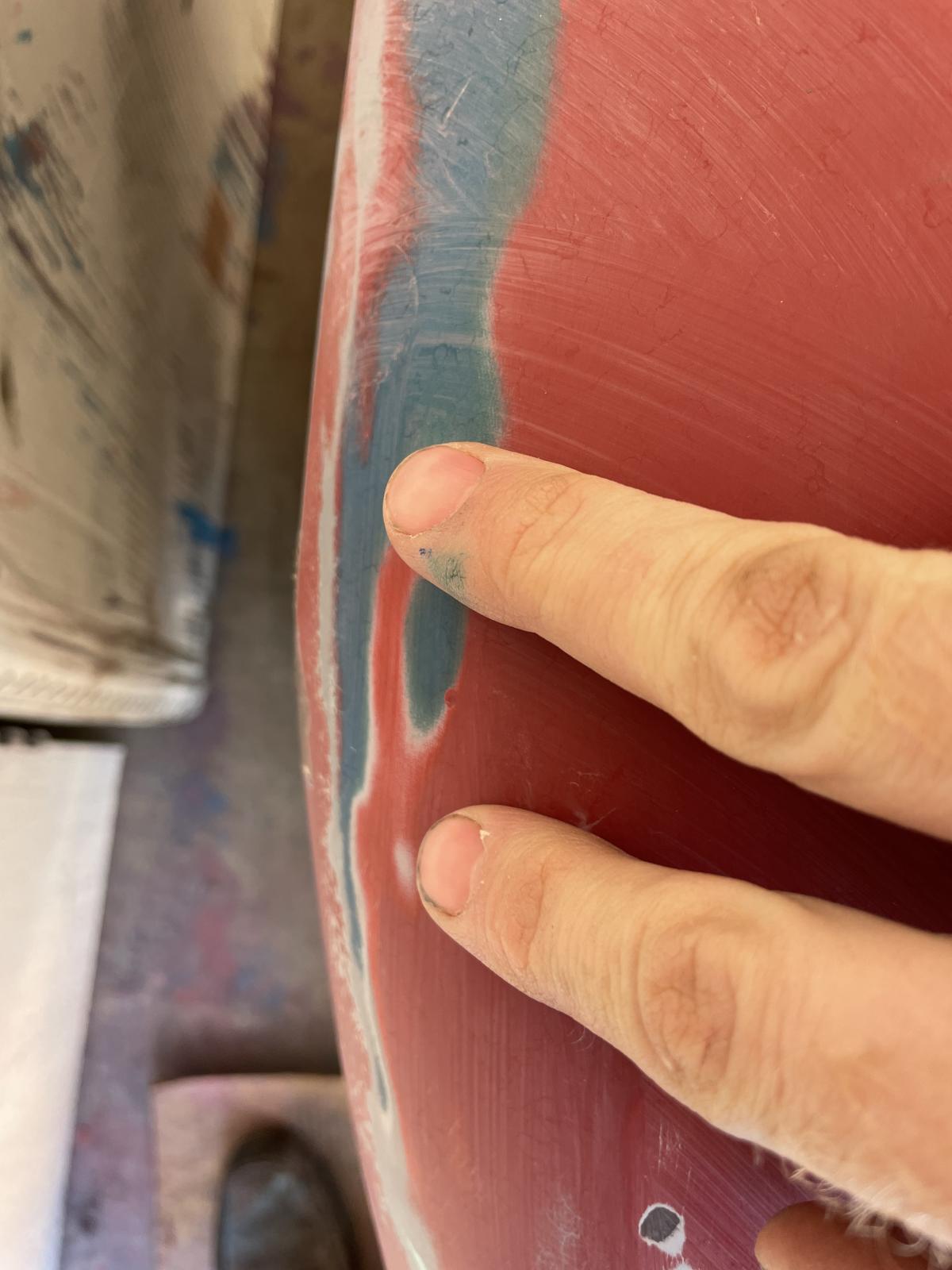

PostPosted: Sat Feb 15, 2025 12:11 pm    Post subject: Re: Thinking out Loud - To Self Repair or Not Reply with quote
Here are the pictures of the damage, if need more, please let me know.

PostPosted: Sun Feb 16, 2025 5:24 am    Post subject: Re: Thinking out Loud - To Self Repair or Not Reply with quote
that doesn't look too bad. I would be tempted to press the dent out using a G clamp and block(s) of wood. I've crudely drawn the idea onto your photo. you will need a block of wood on the outside that straddles the dent and wind the clamp to push the dent against it, you might need a small block of wood on the inside too. work from the ends of the dent towards the center and don't try to do it in one or two goes, clamp a bit then check and repeat. hopefully this will remove the worst of it and you might need to hammer and dolly the edge back into line.

PostPosted: Sun Feb 16, 2025 8:34 pm    Post subject: Re: Thinking out Loud - To Self Repair or Not Reply with quote
Actually, I think this be more of a help to where it buckled. Clamp a body spoon to one side, the clamp right on the buckle, heat the crease with a torch, and shrink. Though still try clamping the lower as why not try it. I have blocks of wood for my floor jack, just don’t have a C clamp.
