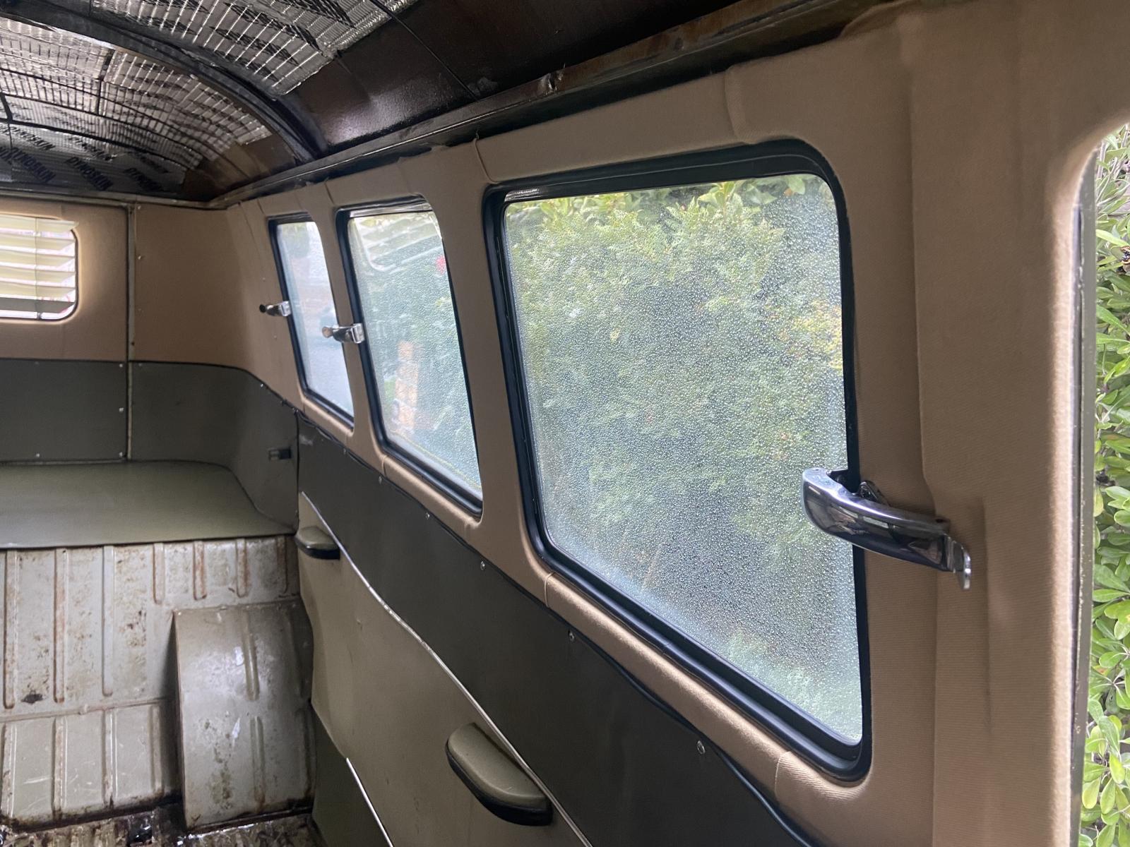

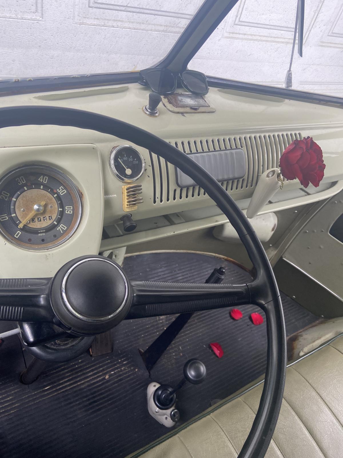

Wrapping up an already started preservation look project. Original seats and paint. Already had its engine rebuilt, new brakes, springs, most moving parts gone through.
Ive tuned the engine, went through every door mechanism, re pinned all the locks, clear por15 on the floor pans and and rust that isnt an issue yet. Finished electrical, saw that everything was accounted for and working..
i need a new sigla slider, & both sliders are seized up:/

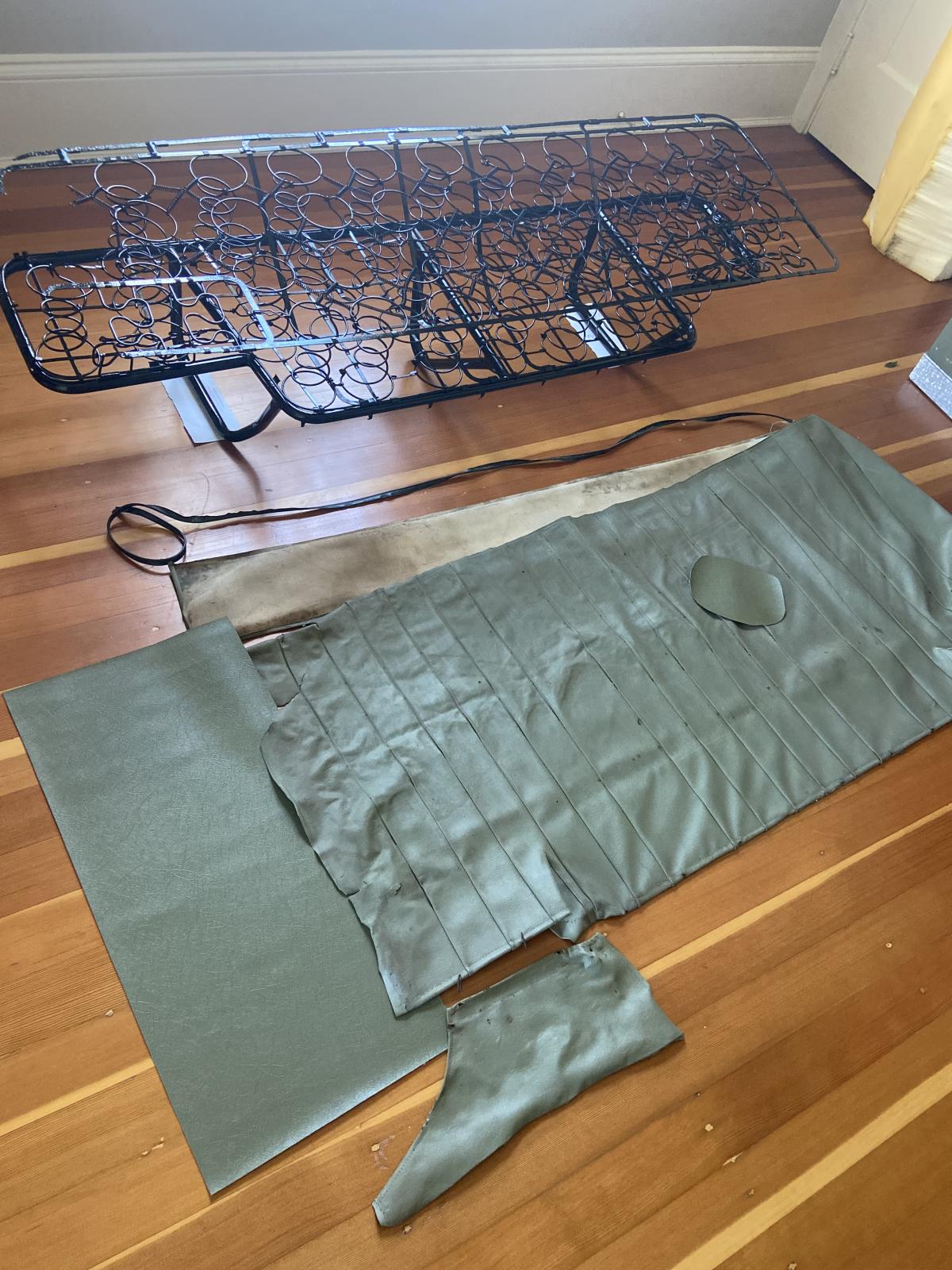

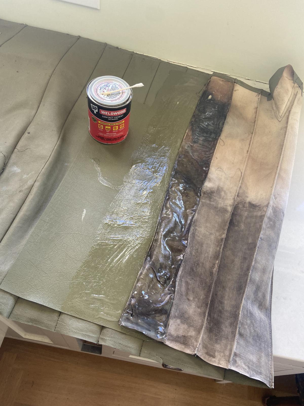

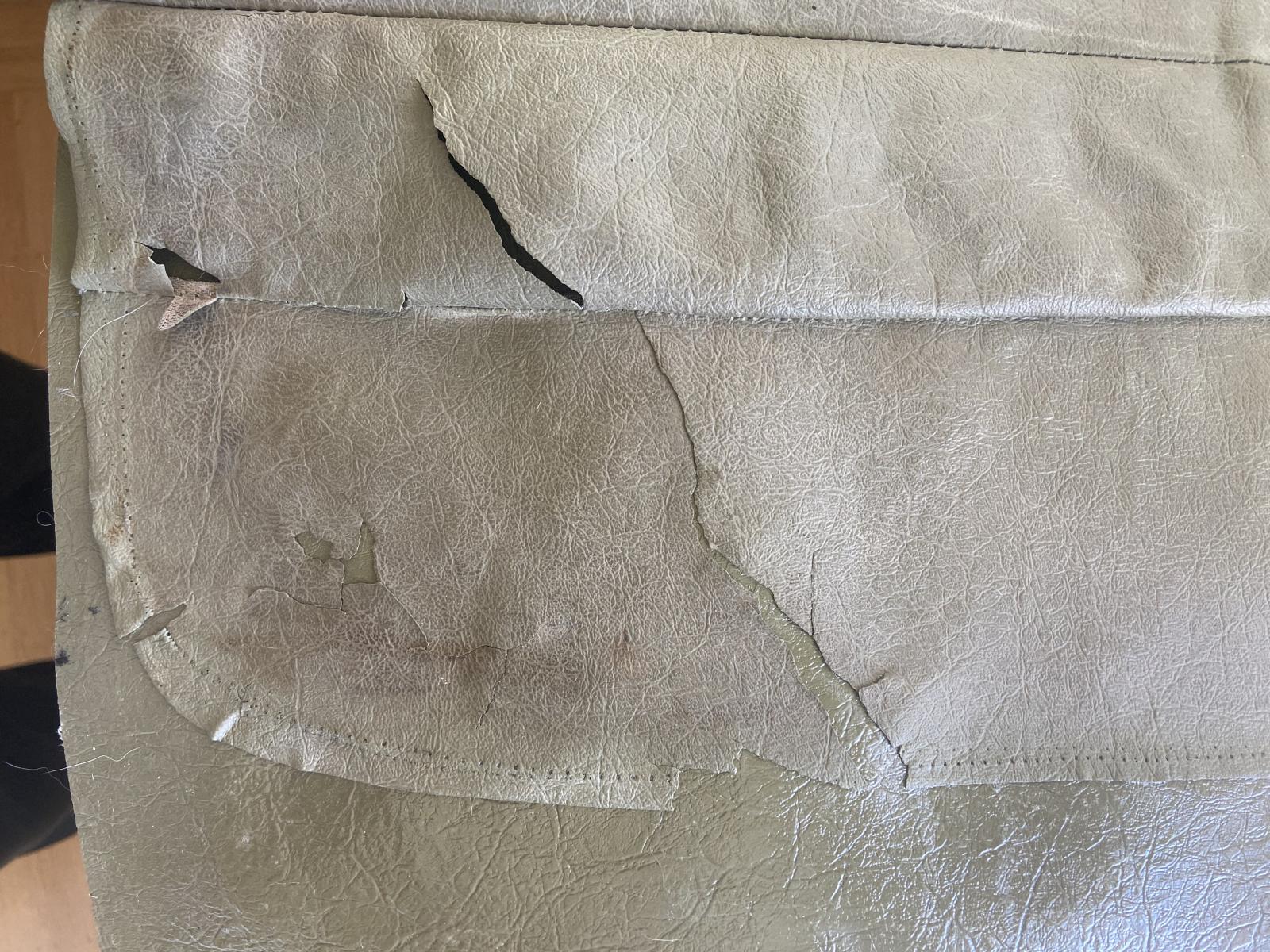

Took off original seats material to fix large rips and missing chunks. Took out rusted springs and replaced them. I sewed in the ripping thread from all places, glued new vinyl under the old stuff just so if it were to rip again new material is underneath.
The seat padding from ww is not usable for putting back original material. Its too puffy and will make everything rip. If using original material, then original padding is needed. So i got cotton batting and burlap which worked. Now onto the headliner

Engine and trans is rebuilt and original, i really want to cut out that broken fuel tank sender and replace with a non tube style so i dont have to take out the engine.
