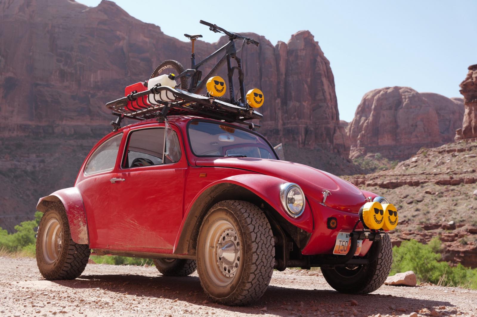

Well I love this baja, it is pretty basic compared to the monsters on this forum. But I decided I wanted a few jobs outside my skill set done, like new disc brakes on the rear, new shocks, a general tune up, etc.

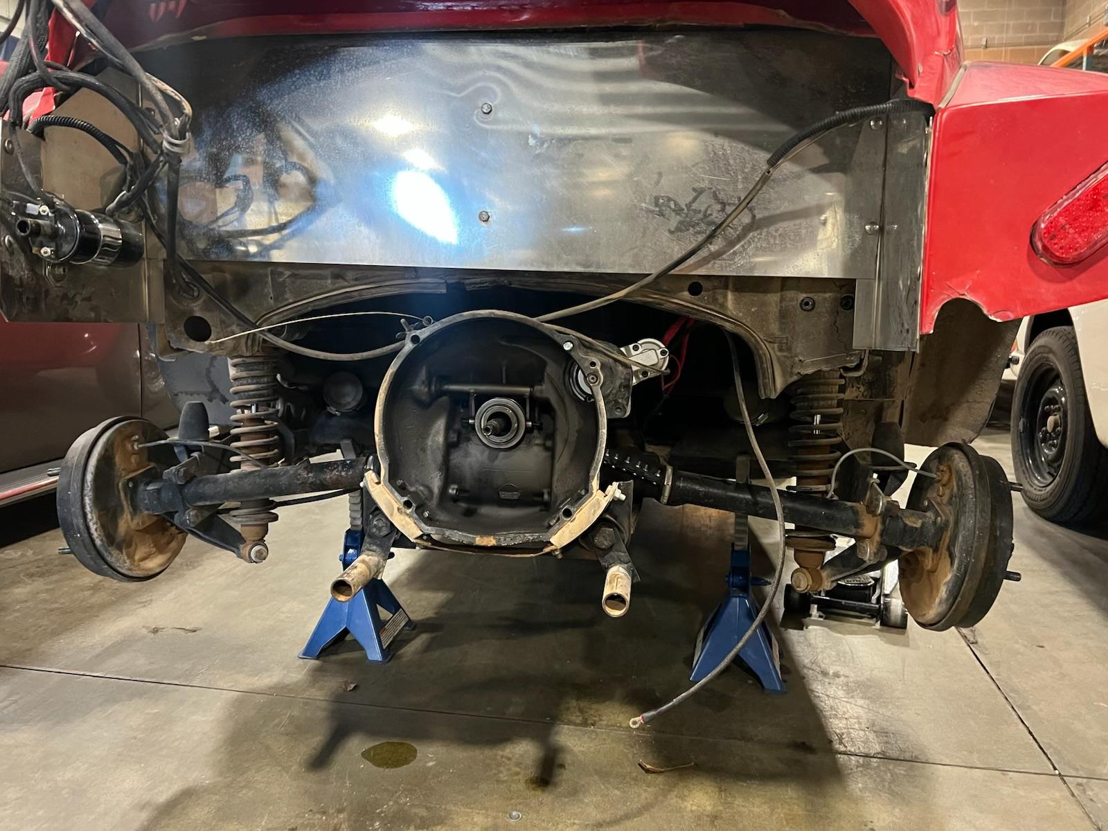

I took it to the dudes up at Verve Vintage https://www.vervemotorworks.com/ in SLC. I asked them to check out the motor while they were at it. Welp... I have tons of compression loss in 2 cylinders. Rebuild time!
I have had some trouble getting into first, along with downshifting from 3rd to 2nd. So, my trans is getting rebuilt too.
At least it'll be fresh for a while!
-Joe

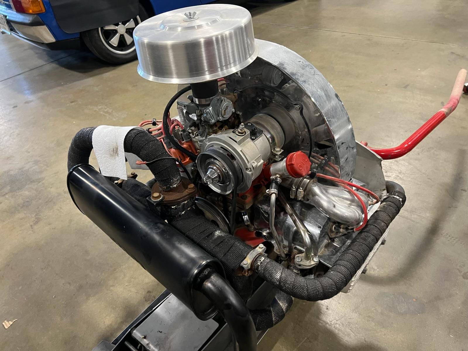

Is the shop just rebuilding your rather stock engine?
Or are you gonna upgrade a bit more low end torque?

I’m waiting to hear back on what the engine looks like inside. How many times has it been cut, etc. Then decide from there! Any tips for a 1600 DP who cruises at 5-10mph on the sandy and sometimes bumpy trails of Moab?

Hopefully, the case is on it's first cut.
A popular size is a 1776 stroker. Thick wall cylinders and lots of longevity. From what I hear.

69 crank 90.5 full weight flywheel will run forever and run cool. 1776 stocker

I do like the idea of a mild 1776.
He brought up lots of good points, but I’m a neophyte when it comes to engines. He could have just been making shit up and I would never know Laughing

I think it's like most things in life, it all depends on who you know. ive got al 'ol boy who does line bores for me for $80 ( although he's on his way out so those days are numbered ) but at that theres no reason for me to not use used cases.
and one of the last engines I built I used old stock heads, put new valve guides in, bought new valves, did a little mild port work , then had the valves & seats cut which cost me about $150. dont think I have more than $250 total in the heads and they're working great on an 1801cc.
If I was in OP situation id throw a little stroke to the engine, it's amazing how much difference that makes. but that also depends on the builders skills too.

I suggest a build that provides low rpm power. That was the best thing when I had a 2050 stroker built for me. With big tires and my original engine it was. A struggle to do anything low speed because of the higher rpm power range.
A stock fan shroud might be more effective than that rounded one you have.

Update from my dudes at Verve. It is a 1776 already! After taking things apart, it does not look as bad as they had thought it was going to be.
So that is cool.
