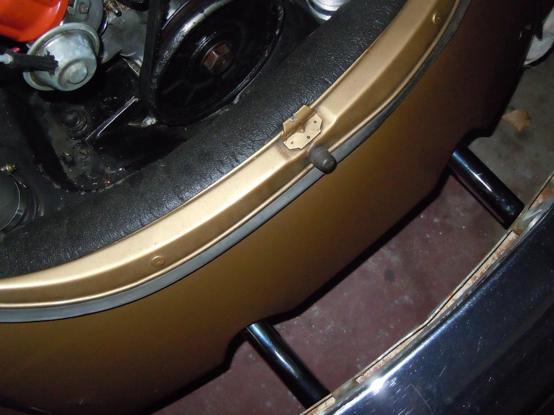

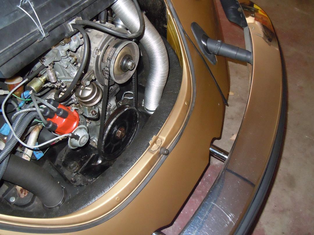

New seal, original tin, but in a few spots it will not seal
Any tricks to make it stay? I’ve worked with it for hours now, can get it in place but in no time it pops back like in the pictures.

Aftermarket rubber that been folded for a long time will not hold it's shape.

Or pulled too tight, if you stretch it as you pull it in it sometimes does that.

Lower the engine, remove the stock seal, raise engine and use a late bus seal.
https://www.wolfsburgwest.com/cart/DetailsList.cfm?ID=411813225
Easy to install, seals much better IMO.

In 2017 I installed JBugs #111-705D, VW Rear Engine Seal, Each, Beetle, Super Beetle, Karmann Ghia & Thing 1967-1974 in my 1970 sedan, was fine.

Stuff a length of fuel hose up under the seal. It will spread the seal open and push the lip out so it will hook under the tin lip. Taking the rear tin off makes it easier. I may have used some upholstery glue to hold it in there. Worked for me when mine had that same gap.

I agree, some of the aftermarket seals don't have quite the same dimensions or fit of originals.
It's already been mentioned the seal might have been pulled too tight when installed. If you can sort of bunch it or squish it, it gives more "length" to the "J" part that hooks under the tin.

I might try this. I'm also trying to warm it up some to see if it will "relax" a little.
