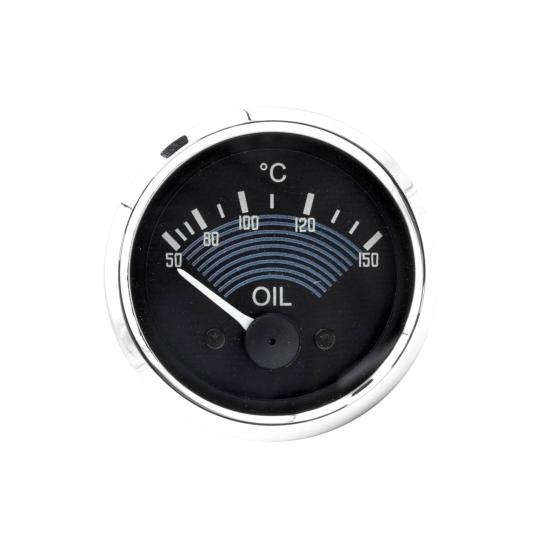

I know my baja is in no way stock, but I really dig the look of the original gauges so I got these:
https://www.jbugs.com/product/14-1116-0.html
https://www.jbugs.com/product/14-1112-0.html
https://www.jbugs.com/product/14-1118-0.html
