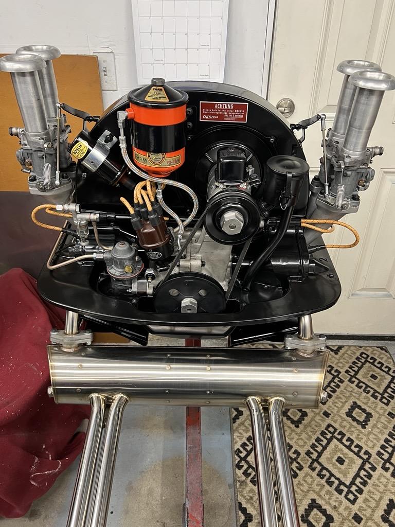

Remember that compression ratio is mainly tied to deck height and combustion chamber volume. So to effectively calculate your compression ratio you'll have to have the engine built, figure out your deck height (increase or decrease deck height with shims or machining work between block/cylinders), and then measure your combustion chamber (head) volume. You can then plug the cc volume, bore, stroke, and deck height into online calculators to figure out your compression ratio.
https://cbperformance.com/v/enginecalc.html?srslti...e6Gd67vIXh
For reference, I just built my 1387cc engine with an 8.6 CR considering a 0.5mm deck height, 69mm stroke, 80mm pistons, and 43cc chamber volume. I used Speedwell 1.4:1 ratio rockers and had to actually get my valve guides cut down about 3mm because the valve retainer was coming down to hit the valve guide. I have around 0.410" (10.4mm) effective valve lift with the old Scat C26 profile cam that had around a 0.300" max lift. I used 2-piece lifters with Manton chromoly pushrods, and they fit along the full swing with CSP spring-loaded pushrod tubes!
So many options to go down and plenty of cool parts to throw at your engine! Good luck!

What a beautiful engine you build ..keep up the great work ....

Not to divert from the original poster's thread topic, but well done on that build. Lots of familiar touches added to it. I believe I've seen it recently on FB...if you have a build thread here please share.

Thanks for the kind words! Unfortunately I didn't do a build thread here, but "borrowed" a LOT of wisdom from many builds. Smile
